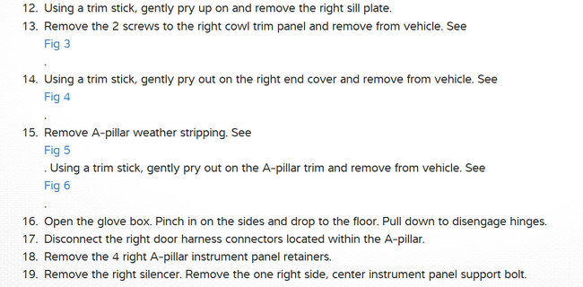

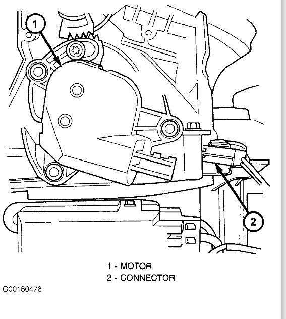

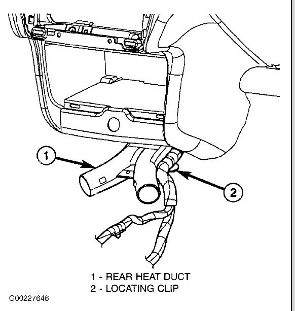

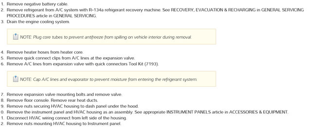

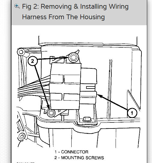

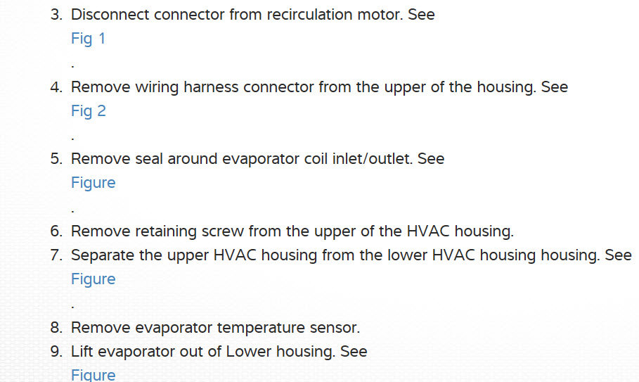

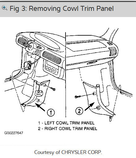

I am looking to find the diagrams or repair guide for replacing the evaporator core in my car. There is a big leak in the core that I plan on fixing before finding if there is any other issues with the HVAC of the car.

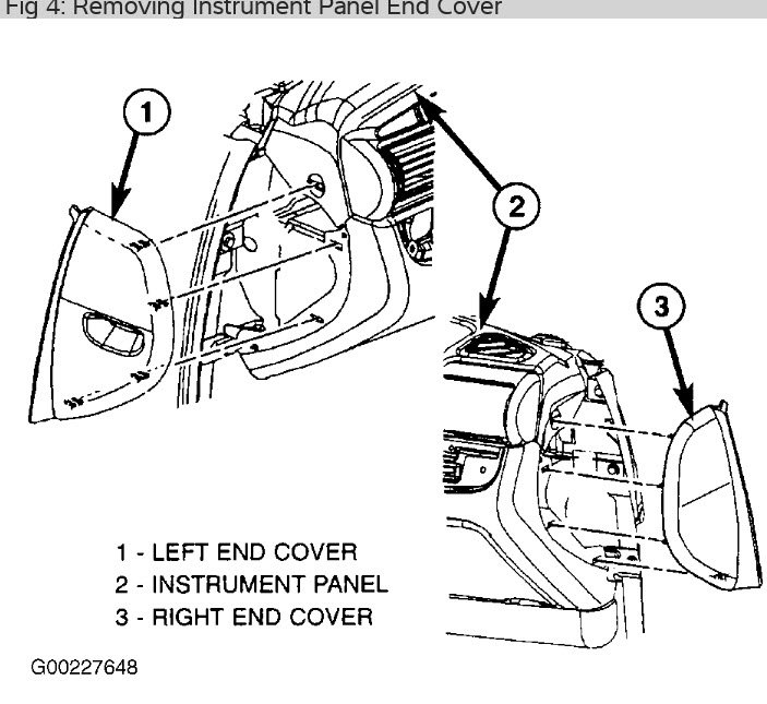

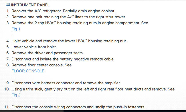

see pictures for disassembly/removal. I have sent instructions for just EVAP if heater core gets damaged you should be able to get that out easily.

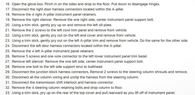

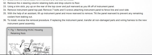

Thank you, that is very helpful! HMAC300, can you also provide the details to disconnecting the HVAC housing from within the passenger cab? I am most concerned with hidden bolts and screws that I cannot see as well within the interior of the car.

HMAC300
  • 48,601 POSTS
the only thing I did not send was how to pull the dash, otherwise you have everything. See pictures for ip removal.
