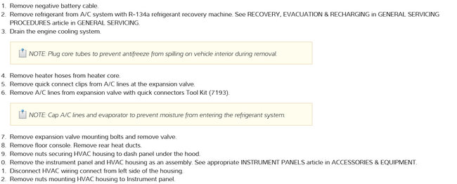

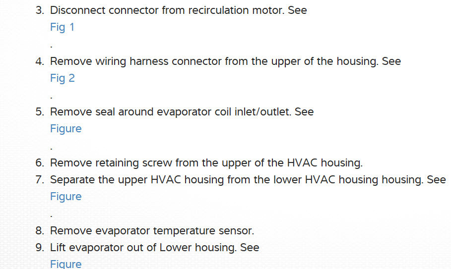

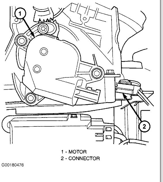

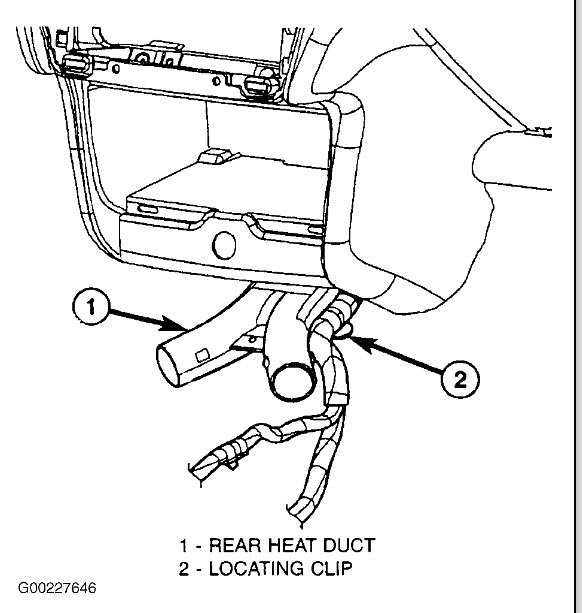

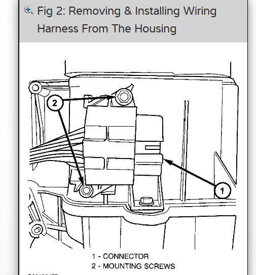

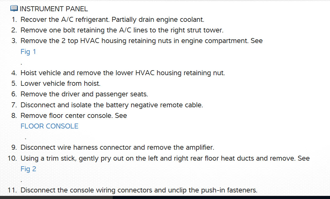

I am looking to find the diagrams or repair guide for replacing the evaporator core in my car. There is a big leak in the core that I plan on fixing before finding if there is any other issues with the HVAC of the car.
Jun 27, 2017 at 12:36 AM
HMAC300
  • 48,601 POSTS

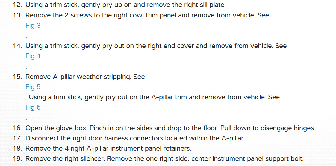

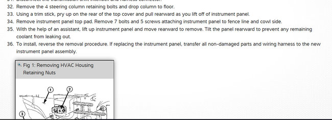

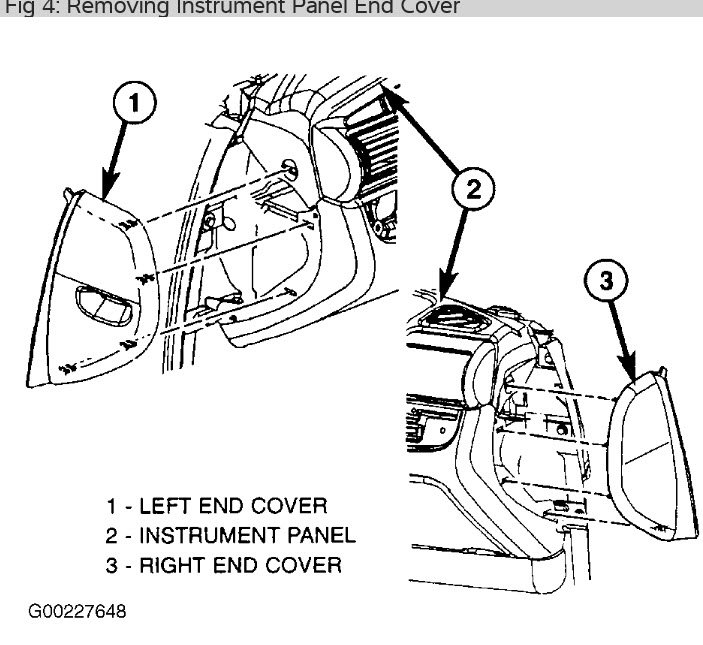

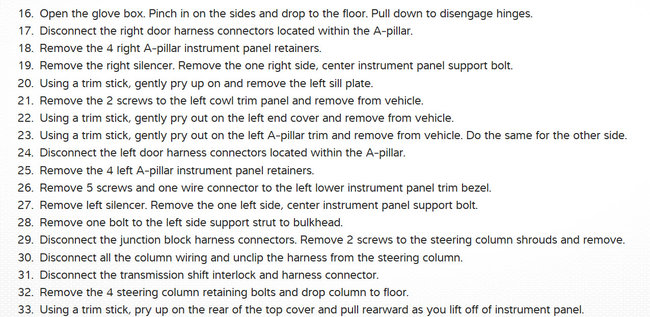

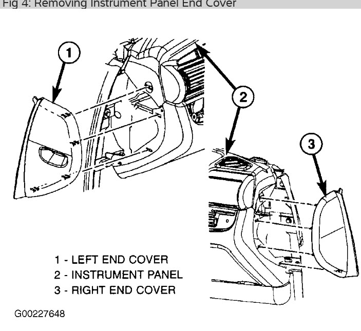

see pictures for disassembly/removal. I have sent instructions for just EVAP if heater core gets damaged you should be able to get that out easily.
Jun 27, 2017 at 2:29 AM
KATHERINE FAITH

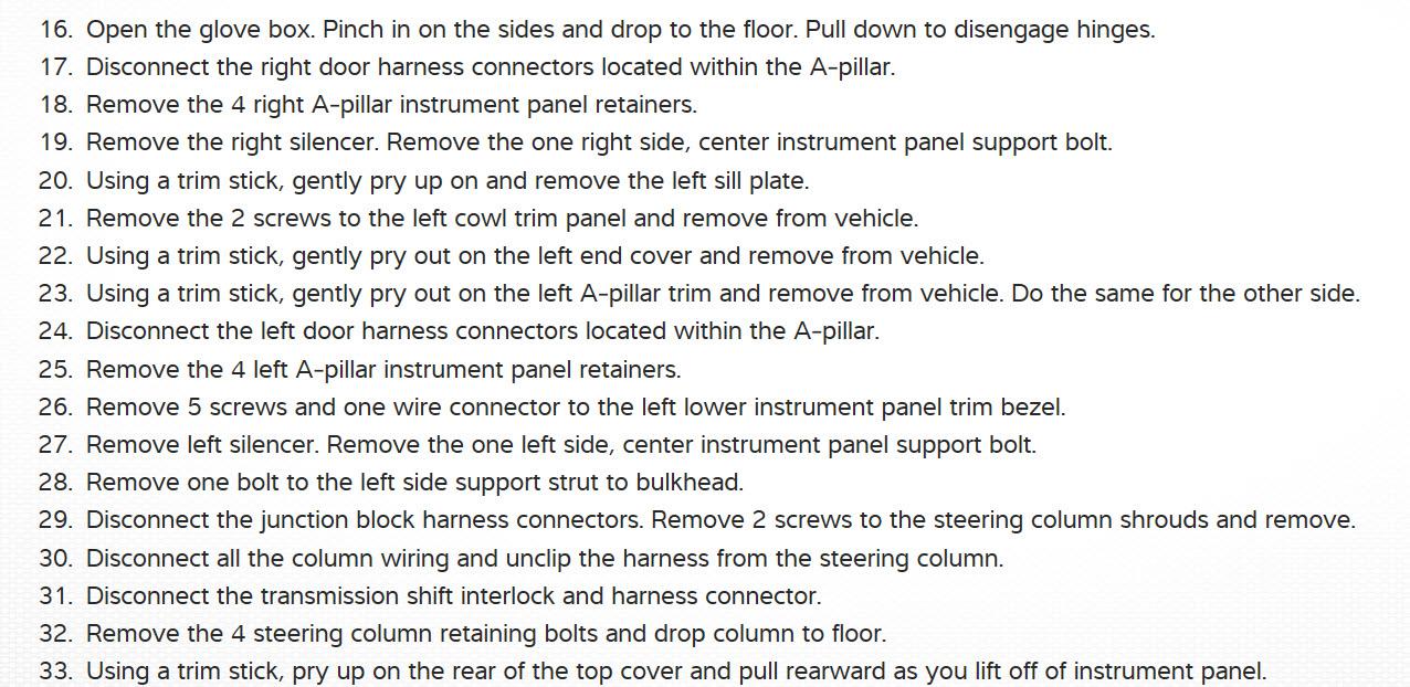

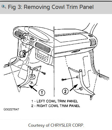

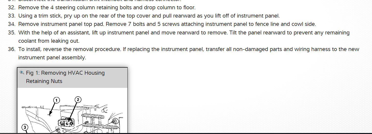

Thank you, that is very helpful! HMAC300, can you also provide the details to disconnecting the HVAC housing from within the passenger cab? I am most concerned with hidden bolts and screws that I cannot see as well within the interior of the car.
Jun 27, 2017 at 7:14 AM
HMAC300
  • 48,601 POSTS
the only thing I did not send was how to pull the dash, otherwise you have everything. See pictures for ip removal.
