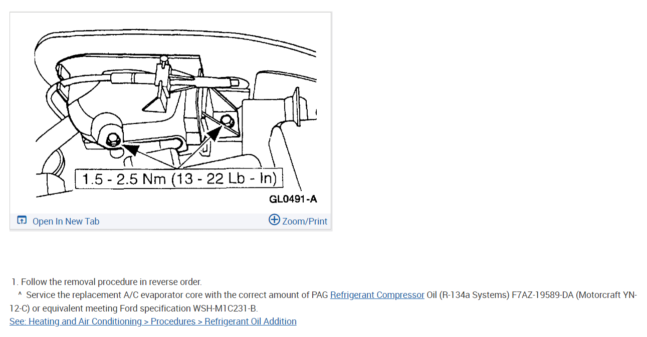

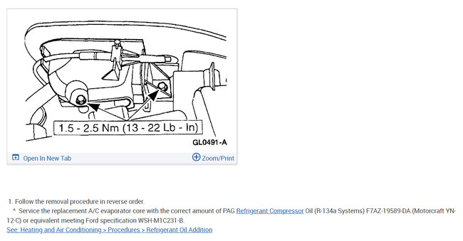

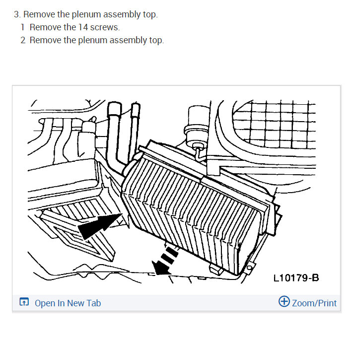

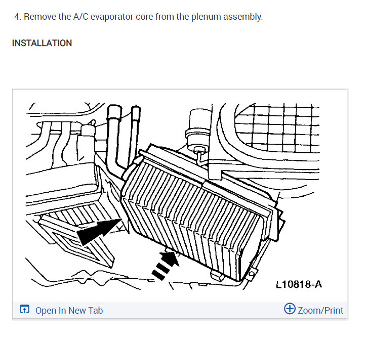

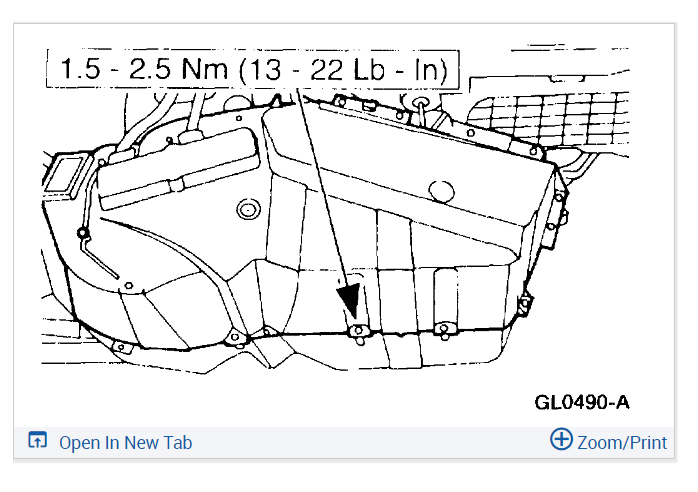

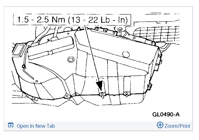

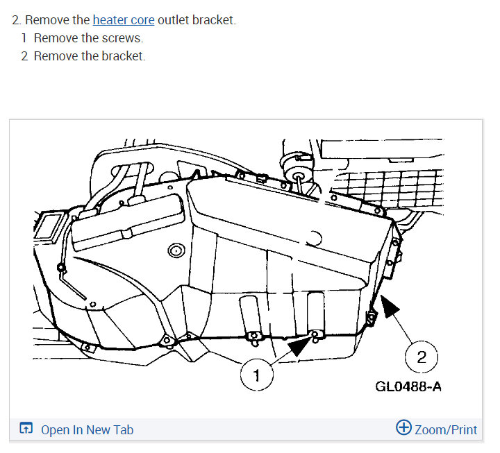

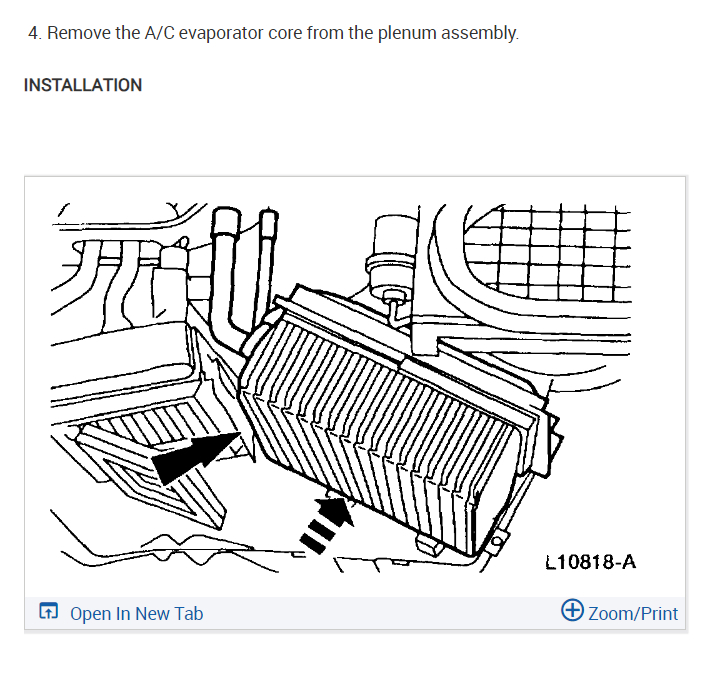

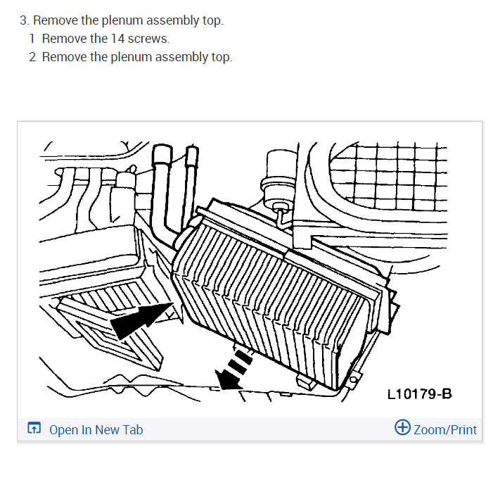

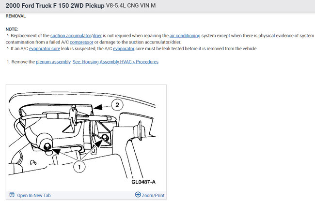

Completely forgot to put the evaporator case panel back on. I don't remember where it goes. How important is it?
Jan 30, 2024 at 4:33 AM
✓Experienced Mechanic
55,433 POSTS
Yes, you must have it if you want the A/C and heater to work. All of the air from the blower motor will come out of the HVAC case. Here is hot to install the case housing cover for clarification. Check out the images (below). Please upload pictures or videos in your response of the problem so we can see what's going on.
