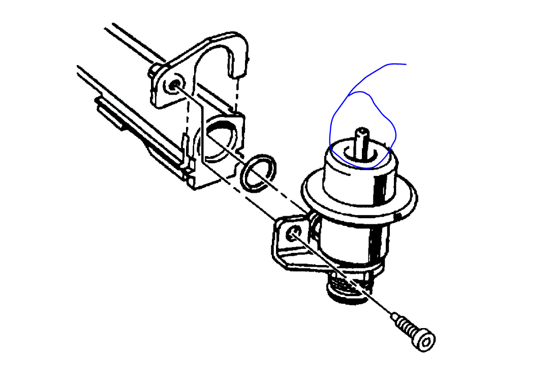

The idea that you had a P0300 first could have caused the Po172 to set. That code indicates a rich fuel mixture. Basically, the engine is getting more fuel than it needs.
Since you had a misfire, that could have allowed unburned fuel to enter the exhaust and set this code. What I would do is this. Reset the computer (delete the code) and see if it comes back. If it does, then I would recommend checking to see if there is an issue with fuel pressure. There is a vacuum hose that attaches to the fuel pressure regulator they may have left disconnected. See pic 1 I circled where the vacuum hose will be connected.
The regulator is located on the fuel rail on the top of the engine. Check to make sure that hose is connected. If it is, disconnect it and make sure there is no fuel in it which would indicate the regulator is bad.
If you want to check fuel pressure, here is a link that shows in general how it is done. However, I would try what I suggest first.

The fuel pressure regulator will either cause high fuel pressure or it can allow fuel to be drawn into the engine via the vacuum hose I mentioned. Did you disconnect the hose to see if it is dry?

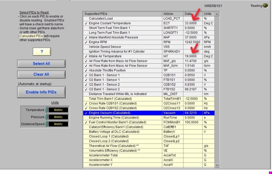

Now cleared p0172 by replacer MAF sensor, but could not clear EVAP system monitor INC though run several time for EVAP system monitor drive cycle. What is standard Board PID_VP value on montane? Now my car engine vacuum is 64Kpa and passed by general scanner streaming data. And pre-test conditions for the EVAP system monitor drive cycle is over 75Kpa. And temperature difference between ECT (33.0000F) and IAT (19.000F) was 14F. If this is problem? Thanks for your instruction and help!

As far as a drive cycle, I've had them take up to 200 miles. I'm not sure how many miles you have put on it at this point. The readings you are showing me don't see anything too far out of the ordinary.
As far as an evap leak, have you smoked the system?
Dec 14, 2020 at 2:38 PM
XJSHEN
  • 251 POSTS
Yes. first time a Tepdon scanner gave wrong result, that made me wasted a lot of time. I made vacuum leak smoke detector, but there was no any leak. After following GM guided EVAP signal driving cycle operation protocol cleared the EVAP INC.
