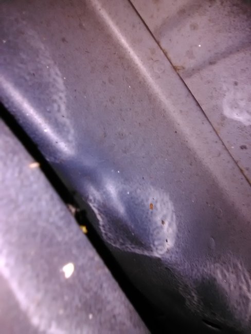

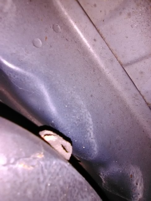

Good evening techs. question i have to change some hoses that are deteriorated with the EVAP system and the fuel vapor hose could someone identify the hose that is connecting fuel tank and the canister system.here is the photo. Mitsubishi has a name of pressure hose, suction hose, vapor hose. i can't get to a manual and having issues with my location. Chicago Illinois. here is the photo.

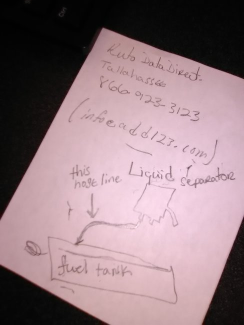

here is the hose line diagram:

Your best bet to get the hose would be a Mitsubishi dealership.You might be able to get one from your local auto parts store to save a little money.Usually after clearing codes it will take about 25-50 miles of driving to reset the PCM for testing.Hope this helps and thanks again for using 2CarPros.
