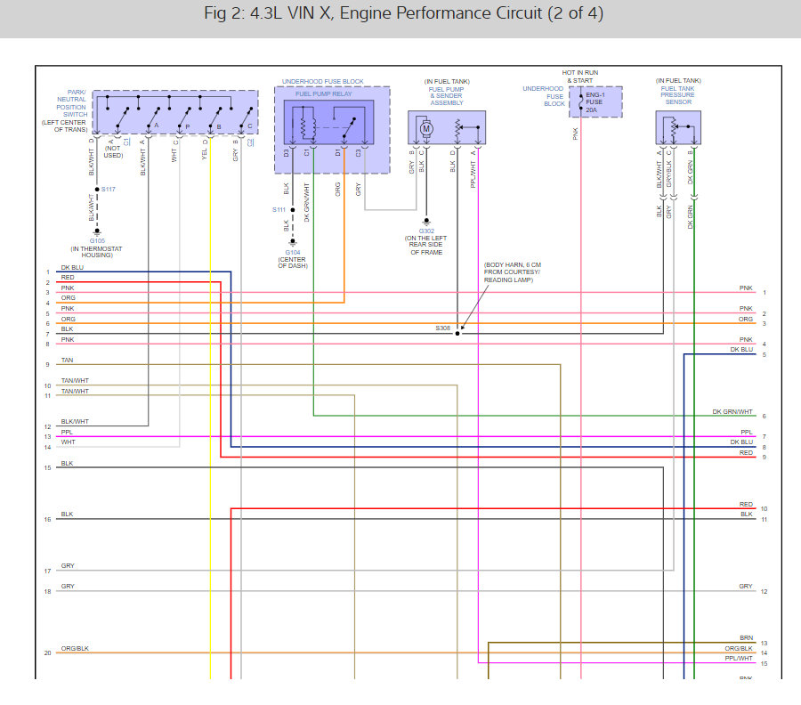

New gas cap, checked purge valve, and checked good since cover was off but new in. Went 2 vent valve checked good could blow through checked wires 2 it good, checked vent valve elec it opened and closed. I clear the code it will come on after about 40 miles. It does not start hard it runs smooth no problem putting gas in idles good.
Sep 8, 2022 at 7:36 AM
  • 55,732 POSTS

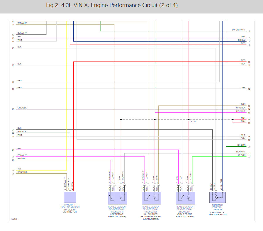

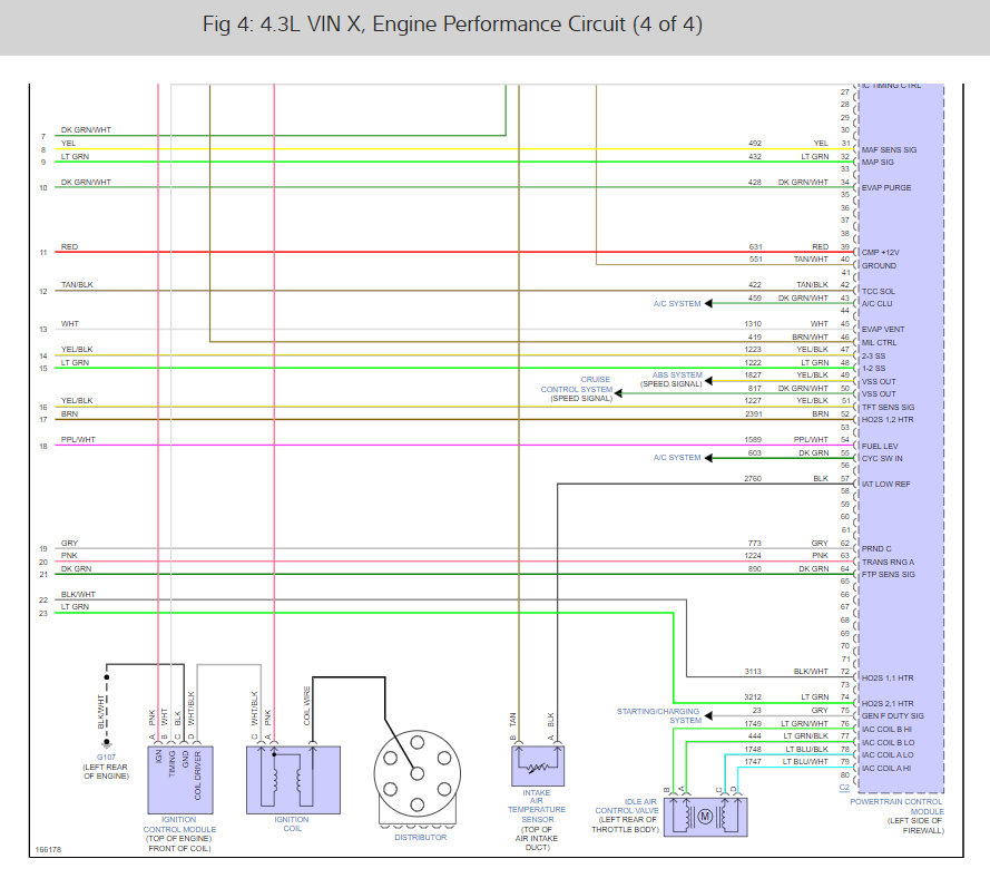

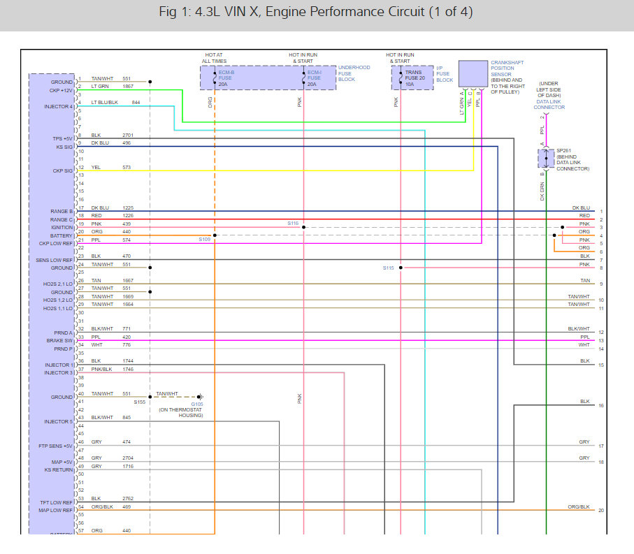

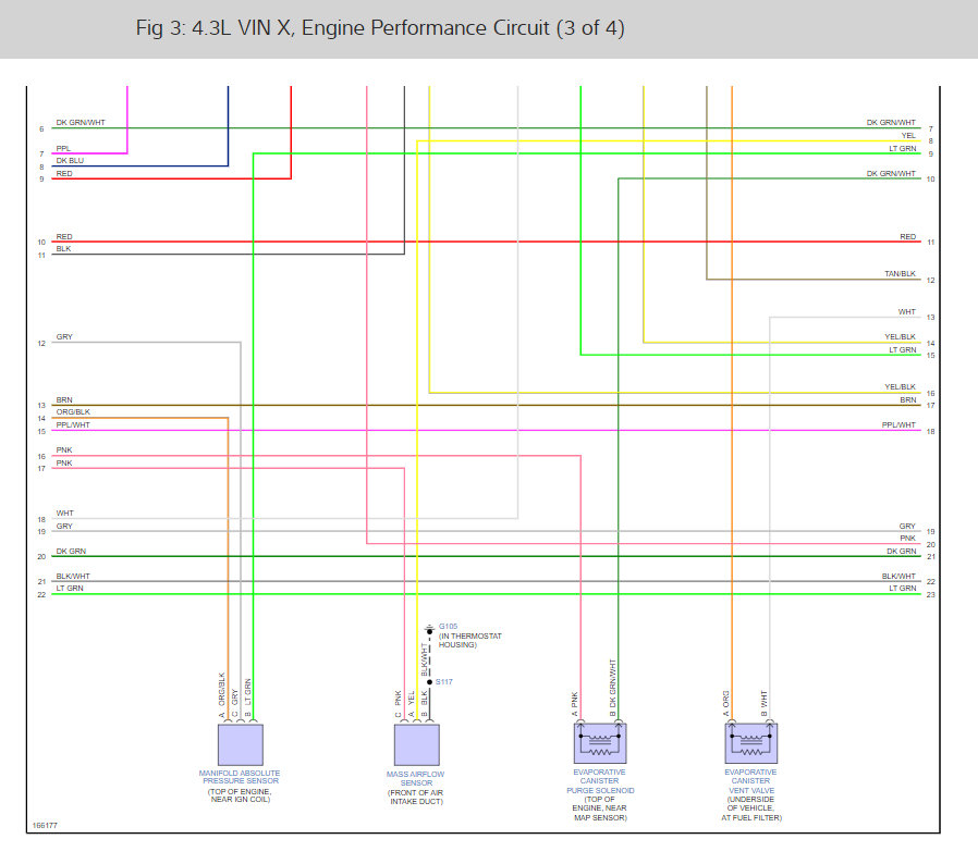

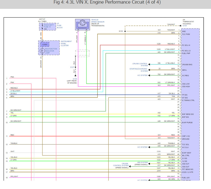

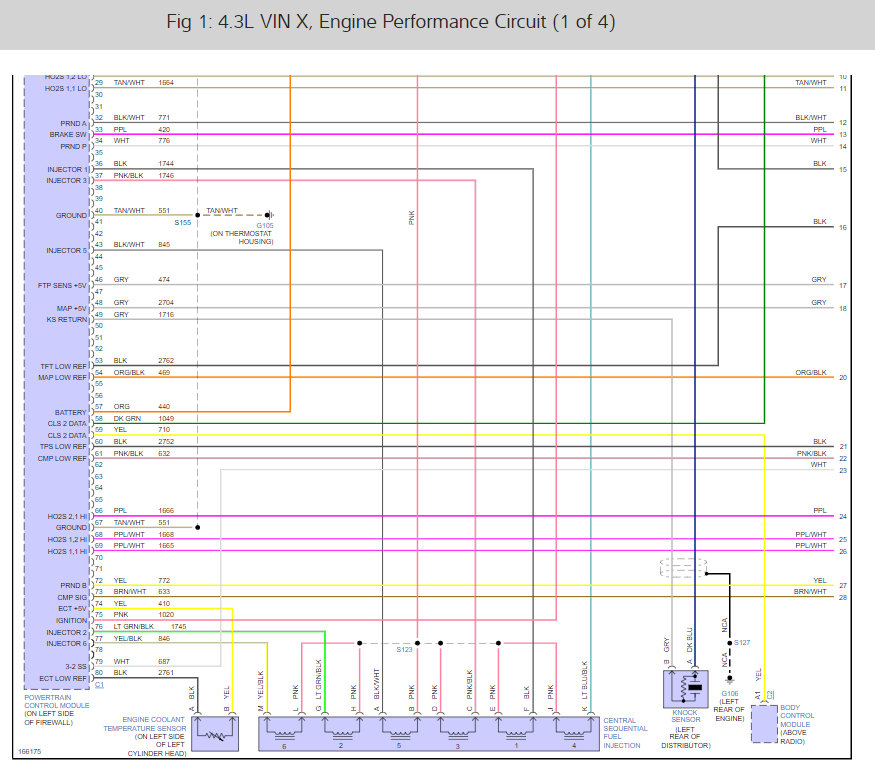

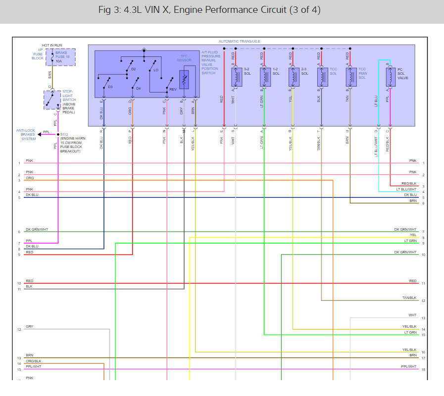

So, this code comes on when there is high resistance in the circuit, I would remove the connectors from the valve and the PCM to inspect the terminals for corrosion. Also here are the wiring diagrams for the EVAP system and a guide to help you do the tests.
Also, even though the valve tested good I would replace it anyway if you can't find a connection problem. Check out the images (below). Please let us know what you find. We are interested to see what it is.

Is it the same code P0446? if so it is high resistance in the EVAP wiring you will need to go over the wiring and follow the guide I gave in the first post.

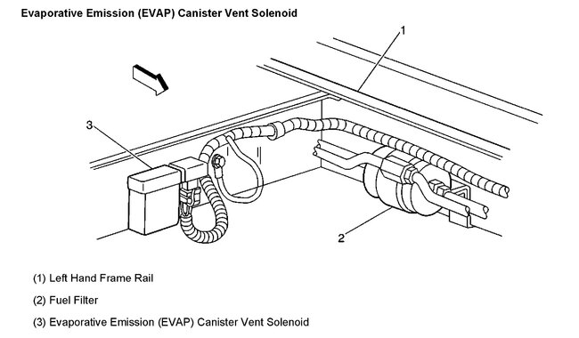

If the wiring looks good, I would try another vent valve, it is common for these valves to go bad. Check out the images (below). Please let us know what you find.

I made sure there was power to the solenoid took the solenoid put 12 volt 2 it 2 make sure the piston opened and closed made sure I could blow through it when not activated. Is there any way I can check the gas cap. Like I said it sat 4 a couple of days took cap off could not feel any surge of pressure.
