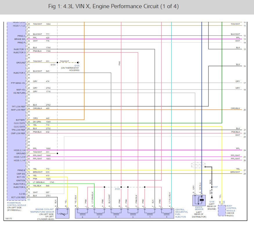

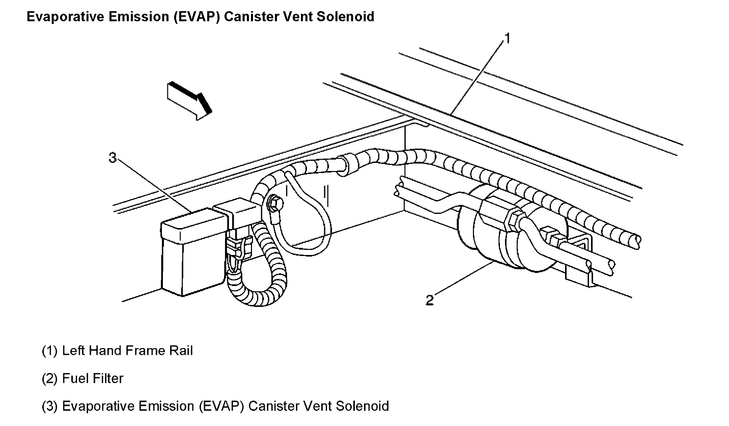

New gas cap, checked purge valve, and checked good since cover was off but new in. Went 2 vent valve checked good could blow through checked wires 2 it good, checked vent valve elec it opened and closed. I clear the code it will come on after about 40 miles. It does not start hard it runs smooth no problem putting gas in idles good.
Sep 8, 2022 at 2:36 PM
  • 54,832 POSTS

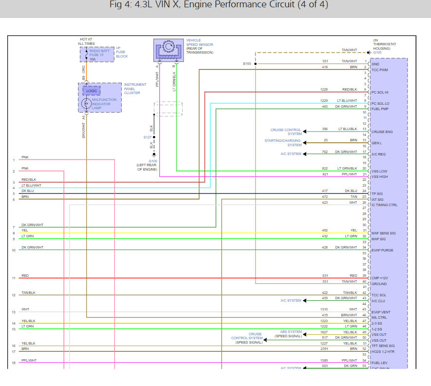

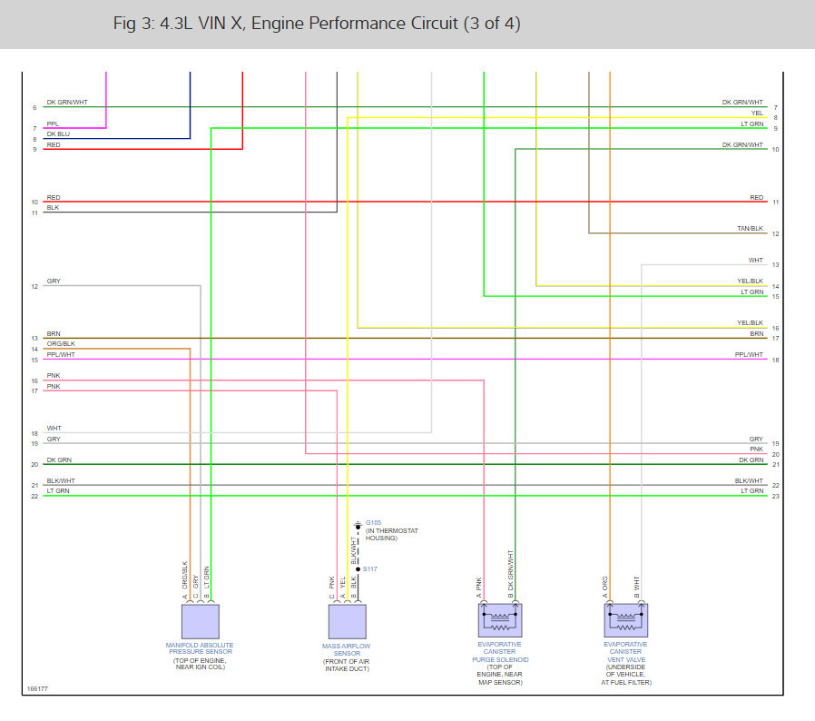

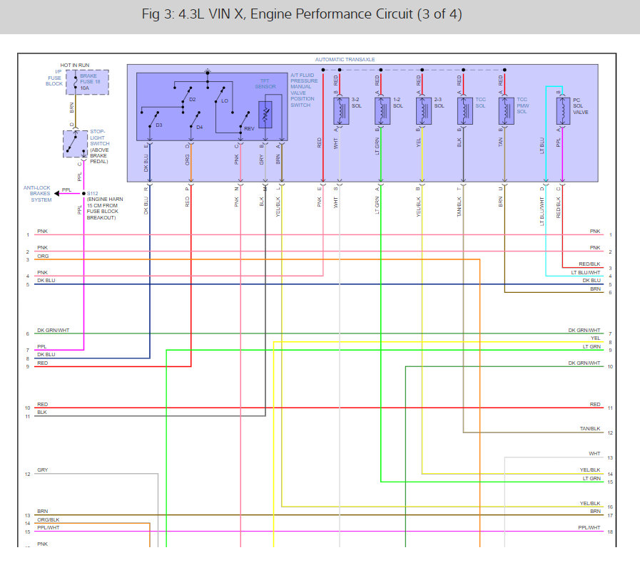

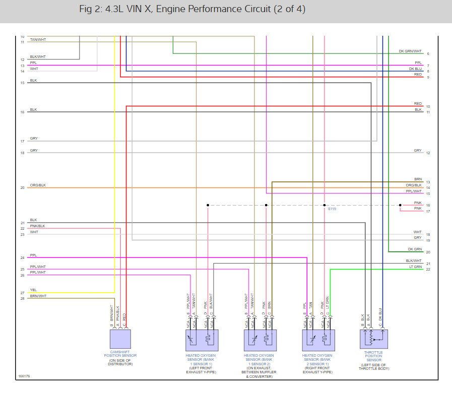

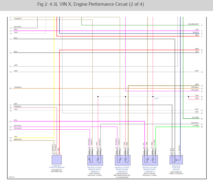

So, this code comes on when there is high resistance in the circuit, I would remove the connectors from the valve and the PCM to inspect the terminals for corrosion. Also here are the wiring diagrams for the EVAP system and a guide to help you do the tests.
Also, even though the valve tested good I would replace it anyway if you can't find a connection problem. Check out the images (below). Please let us know what you find. We are interested to see what it is.
Sep 9, 2022 at 12:06 PM

Is it the same code P0446? if so it is high resistance in the EVAP wiring you will need to go over the wiring and follow the guide I gave in the first post.

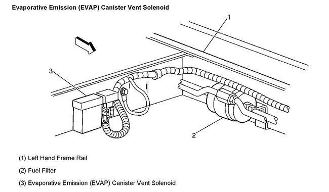

If the wiring looks good, I would try another vent valve, it is common for these valves to go bad. Check out the images (below). Please let us know what you find.
Oct 16, 2022 at 2:06 PM

I made sure there was power to the solenoid took the solenoid put 12 volt 2 it 2 make sure the piston opened and closed made sure I could blow through it when not activated. Is there any way I can check the gas cap. Like I said it sat 4 a couple of days took cap off could not feel any surge of pressure.
Oct 19, 2022 at 2:50 PM
  • 54,832 POSTS
You should not be able to blow through it when not activated.
Oct 20, 2022 at 11:21 AM
DEQUESO
  • 38 POSTS
Getting valves mixed up I think the purge valve on the intake you cannot blow it is normally closed the canister valve by the gas tank is normally open until activated l believe I think????
Oct 20, 2022 at 1:40 PM
  • 54,832 POSTS
Yep, that sounds right.
