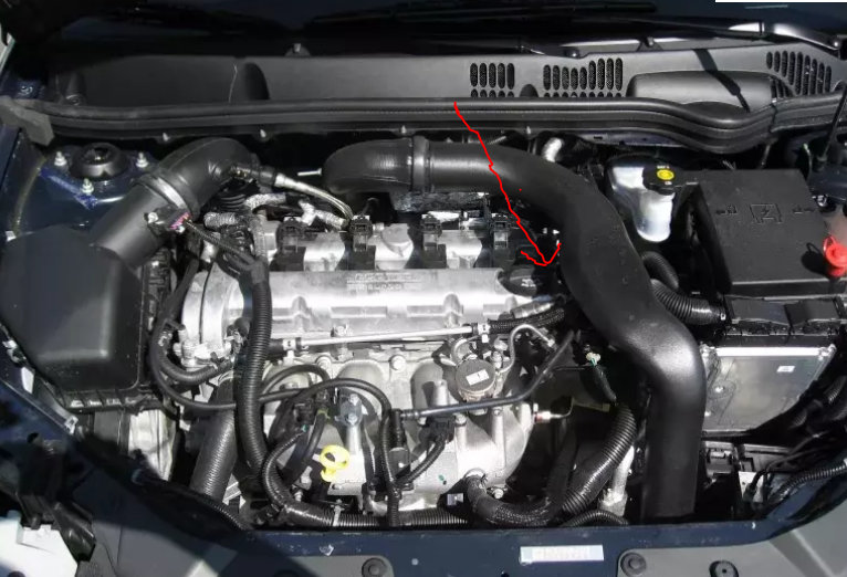

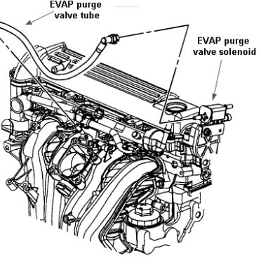

Having a problem with the Evap vent sensor, and where is it located?
Feb 26, 2022 at 3:57 PM
SQM
  • 6,383 POSTS
The EVAP purge solenoid is located under the hood, on the right side of the engine (if you are facing the engine).
I have attached diagrams below for your reference.

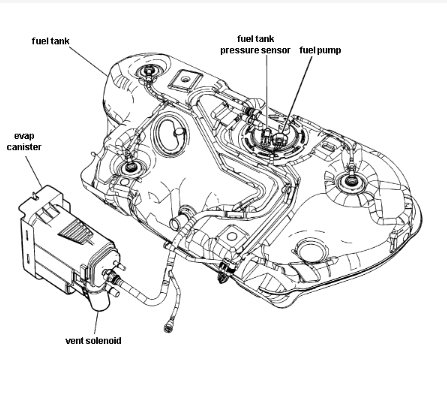

The vent valve is it on the evap,? If so where is it located?
Mar 3, 2022 at 4:45 PM
SQM
  • 6,383 POSTS
The EVPA canister is located on the top of the fuel tank.
See attached diagram.
