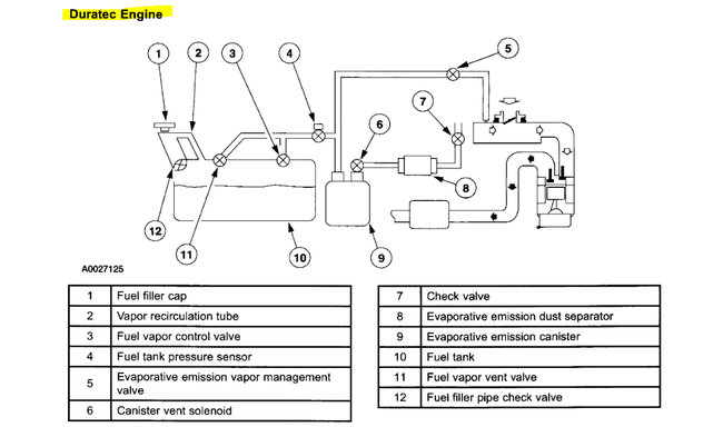

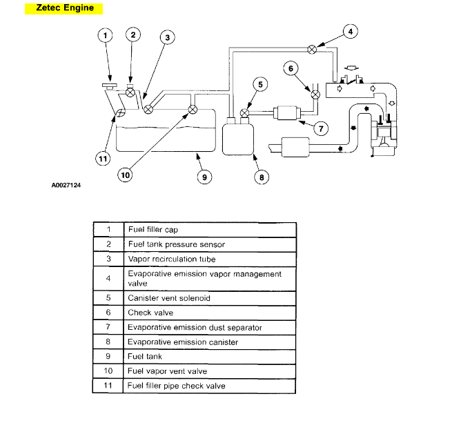

I have an EVAP code for the fuel tank pressure sensor. I get how that is installed but whoever owned this vehicle before vacuum lines are missing or hooked up wrong. Need diagram of fuel tank to filler neck to the purge solenoid up in the engine compartment.

I am not sure which engine you have in your vehicle, so I have included both of the diagrams of the powerplant options for your vehicle in the diagrams down below. Please get back to us if you have any other questions and I hope these diagrams help.
