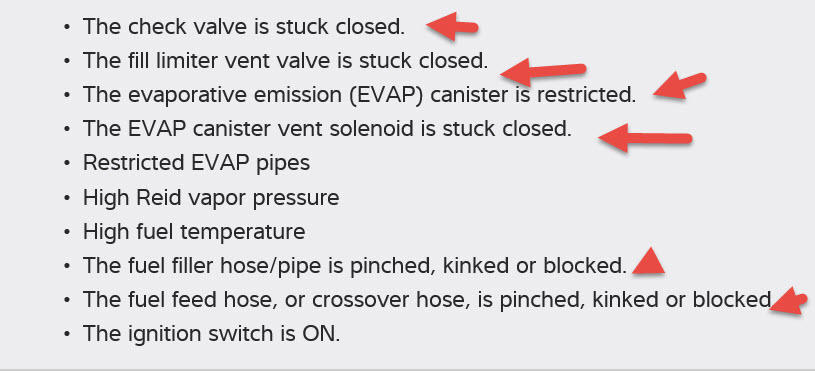

I have a motorhome with a chevy express chassis. Tried to fill tank and the gas came right back out. Took it to a repair shop and had purge and vent valves replaced. Repairs made no difference and still can't fill the tank. Any suggestions?

check to see if vent line is blocked or kinked. it may not be able to take gas fast and will have to be filled slow.

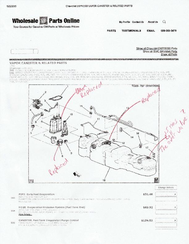

Thanks for responding. I checked the vent line and no kinks. I blew air through it and it was clear. I ran a 1/8" fiberglas rod down both lines to be sure and may have hit something in the fill line (maybe a valve?) about 3 feet down. It's almost impossible to get any gas into the tank now.

if this is the factory tank you are talking about there is an anti rollover valve there, that may be stuck I have no idea how to fix that as it is part of the tank unless you took off the fill tube and found something in that or something blocking the tank you might be able to free it up but not sure how it works as I've never run into that problem. the only other thing I can think of is the evap is plugged from to much fuel so you might try draining it and see why it's not working. the fuel tank should never be filled after an initial stop when pump stops is what I mean.

The repair shop is going to use a smoke machine to check the other valves. I think it may be the rollover valve you mentioned. Is the rollover valve in the fill line near the tank? Again thanks for your help! I've $200 in parts and labor for the new valves. Who knows how much I'll have before this is fixed.

no the valve Is in the tank, but if they check the evap it will tell of leaks not if it is overfull or not as it might be pic shows things to check

Thanks for your help. Still have the problem of not being able to fill the tank. Took the Motorhome to 3 different shops and no one can figure it out. So far, changed the purge and vent valves, evap canister, replaced and rerouted fill line vent hose, removed and inspected fill line gas hose, Checked the inlet to the tank; it doesn't have any obstructions. This is so strange cause I've had this MH for 2 years and it never had this trouble. Something mechanical has failed, but what?
