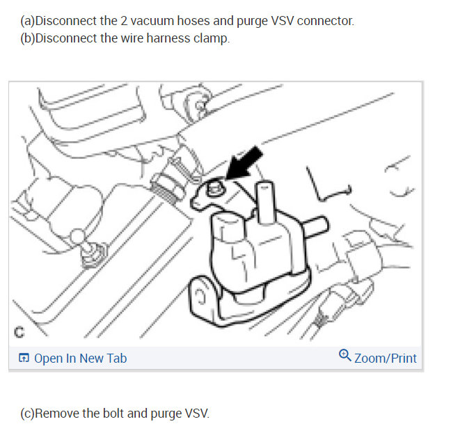

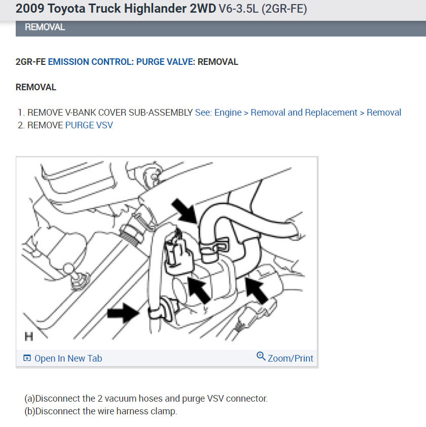

This happens when the EVAP purge valve is stuck open. here is the location so you can remove it to see if you can blow through it (you should not be able to). If you can replace the valve. Check out the diagrams (below). Let us know what happens and please upload pictures or videos of the problem. This valve is under the engine cover.

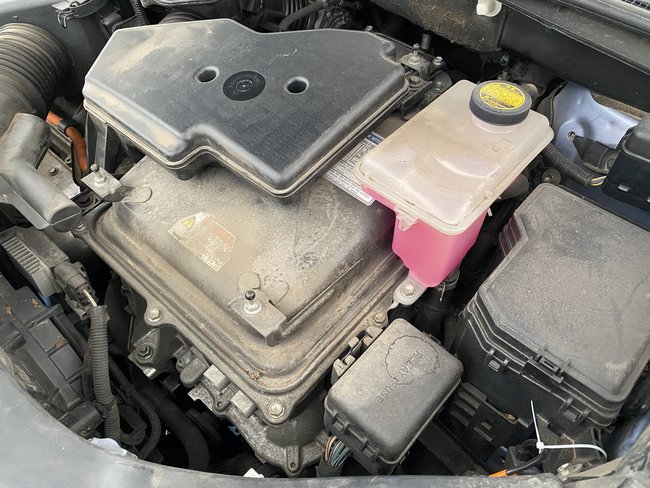

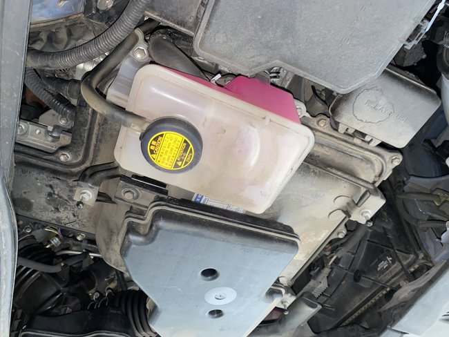

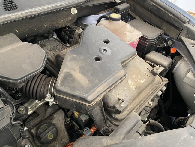

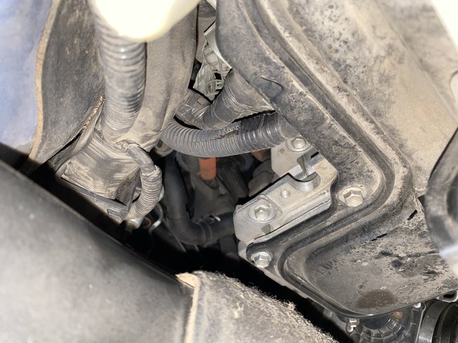

Thanks for the quick reply! I am unable to spot the purge valve. It may be in a different location in the hybrid model I have. I attached 4 photos I took of what is under the engine cover.

Yep, it's not going to be around the Hybrid part. We don't show a Hybrid in the states so I don't have the location, it should look the same as in the diagrams though.
