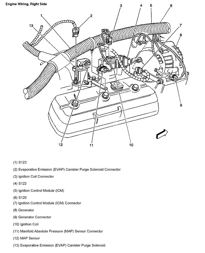

I have replaced the purge valve, also canister vent valve and gas cap. Drive 90 miles same code returns I clear code drive around 70 miles code returns etc, etc. I have checked the electrical connections all good.

Here is the definition of the code and this problem occurs when the EVAP purge solenoid goes out.
P0446 - Evaporative Emission Control System Vent Control Circuit Malfunction
Here is the location of the EVAP purge solenoid #13. Check out the images (below). Please let us know if you need anything else to get the problem fixed.

I have replaced that solenoid plus canister vent valve also gas cap, have checked the electrical on the solenoid and wire conn all good. If I have a leak, why would it be so erratic? Plus, what does it hurt if it leaks???

This is a circuit code which means the valve is bad, the wiring or the PCM. It does really hurt anything except for having the check engine light on.
