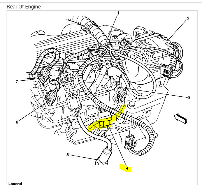

i disconnected the hoses and did not label them. does one connect to the PCV valve hose?
Sep 6, 2022 at 5:25 PM
  • CAR REPAIR CONTRIBUTOR
  • 110,190 POSTS
The purge valve solenoid will produce a connection between the canister charcoal canister and the intake manifold.
I tried to find a good pic or schematic but wasn't successful. I attached the only pic I could find below. Take a look at it and based on where I indicated it goes, let me know if you can find the correct locations.
See pic below.
