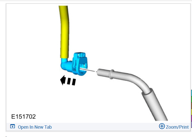

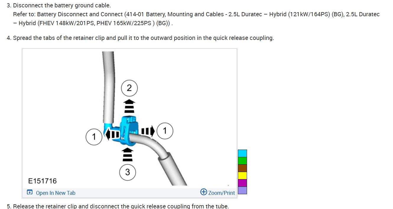

Hi
I'm not sure exactly which connector you are referring to. If I'm correct, it should be a quick connect.
Do me a favor. I attached two pics below. Take a look and let me know if pic 1 shows what you are working with and if pic 2 is the type of connector.
If possible, copy my pic and highlight what you are working with.
See pics below

Pic 1 isn’t exactly what I’m working with and pic 2 is the wrong style of connector. The connector is exactly like the one in pic 1 on the far left of the pic. In the pic it’s purple and around the intake manifold

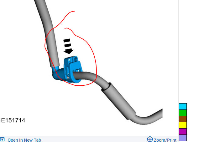

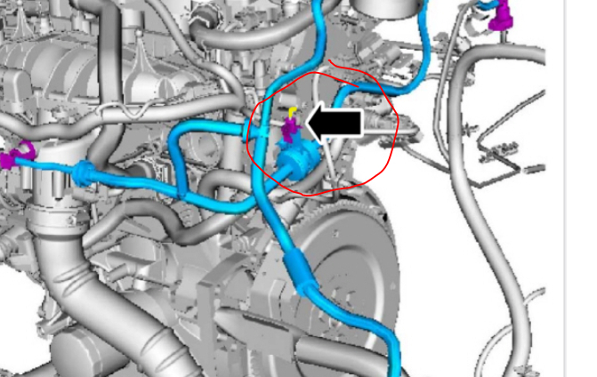

Yep, the clips can be tough, can you upload an image of it so I can tell you how to disconnect it so I can be sure, but, I think this is what you need to fix it.
