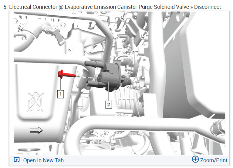

Where is the EVAP Purge System located?
2022 CHEVROLET SILVERADO
32,000 MILES • 2.2L • 4 CYL • 4WD • AUTOMATIC
JDFORD63
I just need to know where this is located so I can see if I can change it.
Mar 26, 2025 at 2:26 AM
  • 55,433 POSTS
Sure, the EVAP purge solenoid is located under the hood on the engine intake manifold. Here is the location, be sure to clear the codes once the valve has been replaced. Check out the images (below).
