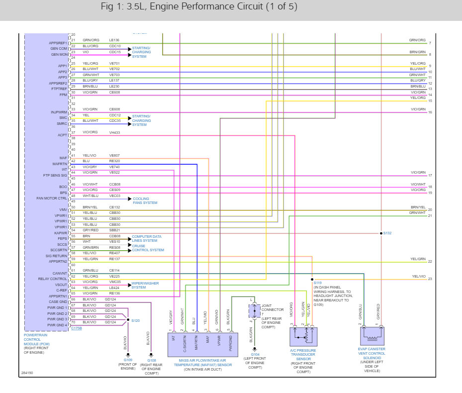

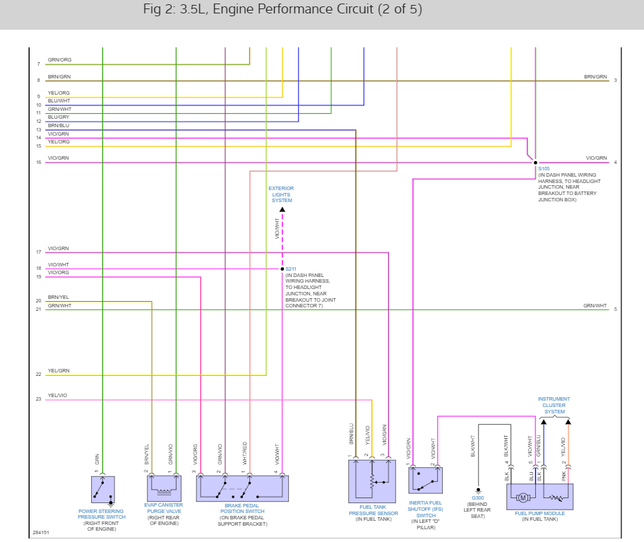

The wiring to the EVAP Purge Canister Valve has been chewed through by rodents. I wanted to know if there is a way to just re-wire it or do I need to replace the whole thing?
Nov 17, 2022 at 7:29 AM
  • 54,837 POSTS

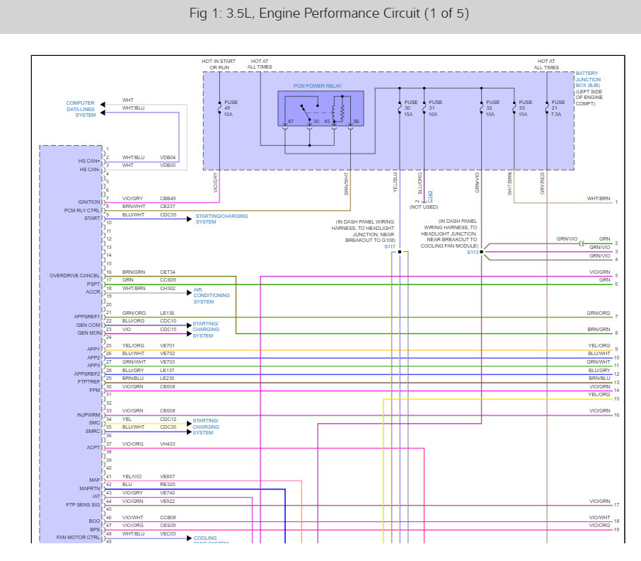

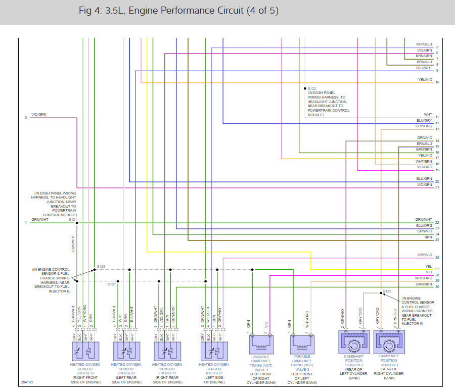

Yep, it happens, depending on the damage you will need to judge which would be the easiest. Here are the wiring diagrams for the EVAP system in the diagrams below. The EVAP wiring is included with the engine wiring diagrams. Check out the images (below). Please let us know if you need anything else to get the problem fixed.
