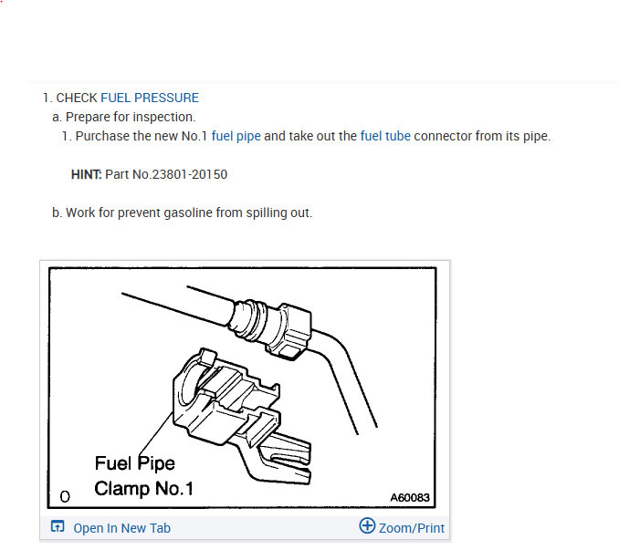

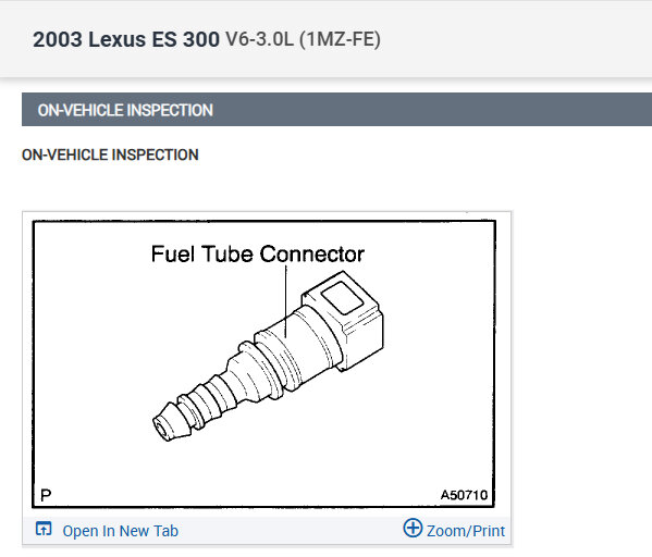

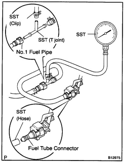

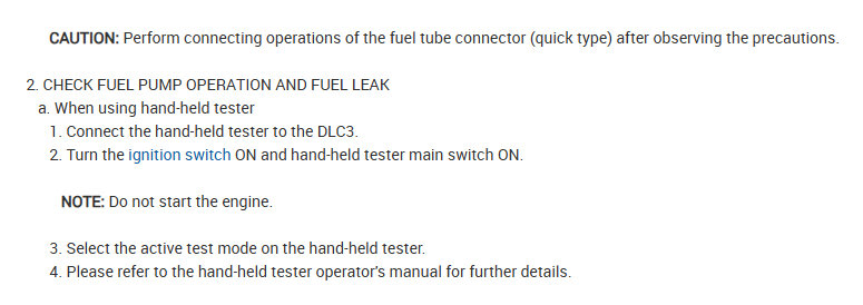

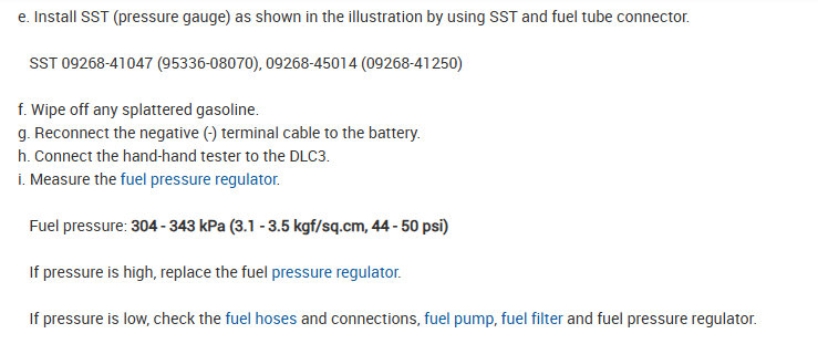

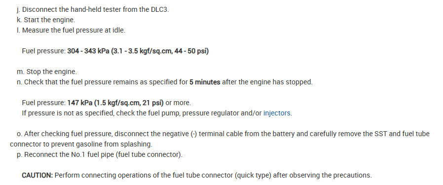

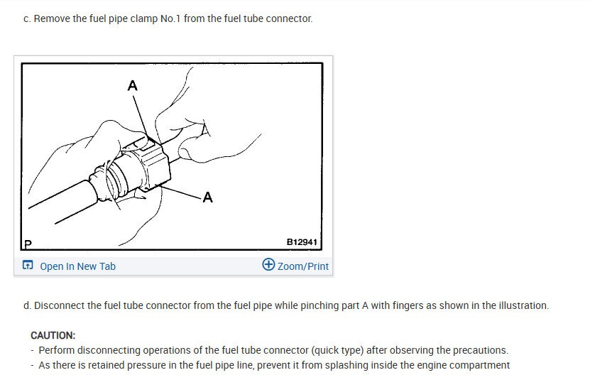

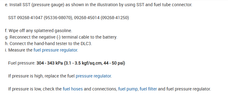

If the light has returned, the issue isn't resolved. A lean fuel mixture can also result from a weak fuel pump. Have you checked the fuel pressure?
Let me know. Also, let me know if these are the only two codes you have experienced. Just a couple of other questions. You indicated there are no engine vacuum leaks. Are there any exhaust leaks pre-catalytic converter? Are there any misfire issues that could indicate a fuel injector issue?
Let me know. Also, I attached the manufacturer's fuel pressure specifications below. They include the manufacturer's pressure specifications.
Let me know what you find.
