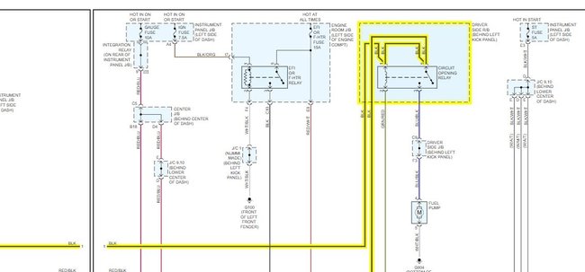

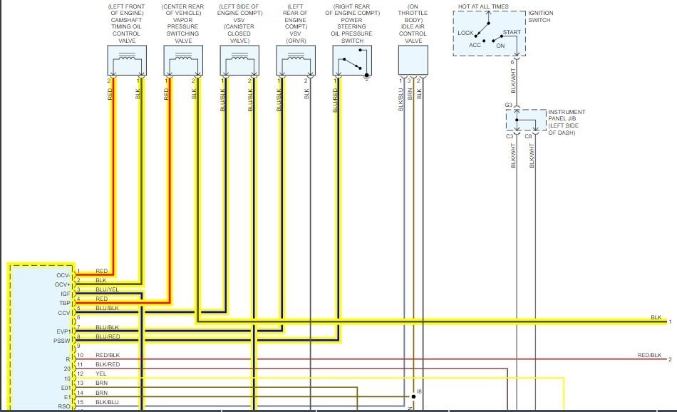

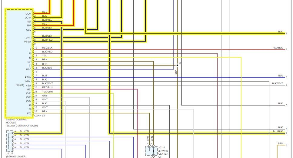

I attached a wiring diagram for you to view. I would confirm voltage to all the solenoids and the returns as well to the ECM.

Okay, at this point, all you can do is check the voltage at the solenoids as I highlighted in my previous posts.
The ECM controls the solenoids to turn on and off. That will require a scan tool to monitor the system.
