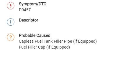

Code PO 457 .
Do I have to take to Ford Dealer? Or can I use a private repair shop?
Jan 2, 2020 at 3:38 AM
Good morning,

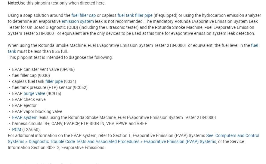

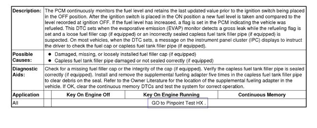

Yes, I would. Most private shops have the ability to properly diagnose this issue.
This code could be a leak at the fuel cap or the capless system. I attached descriptions and tests that should be done.
