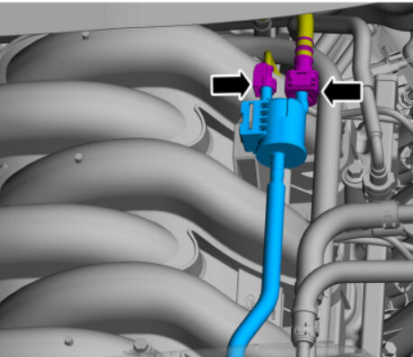

P0455 means a large EVAP leak. I was hoping to see where the smoke leak was coming from but you say there is none correct? I have seen the EVAP vent valve up by the engine have a supply line leak or the valve go bad which does not allow vacuum to enter the EVAP system so it thinks there is a leak. Here is the location of the valve so you can check the O ring seals of the lines and to put 12 volts to it and make sure it opens. Also, make sure the gas cap has it O ring on it. Check out the images (below). Let us know how it goes

That’s not where the “vent valve” is, that’s where the purge valve is. You’re not really familiar with with this vehicle are you?

Sorry I misspoke, yes the purge valve. Good luck with your repairs.
