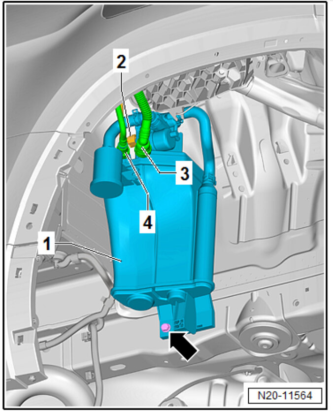

Hey everyone. I'm trying to locate the Evap canister vent valve. Does anyone know of any diagrams or videos I could use?

The EVAP canister vent valve is on the canister under the car near the fuel tank, here is the location. Let us know if you need anything else.

Does not Give enough Detail Of Location!!!

Yep, sorry about that, you need to remove the left rear tire and the fender well to get at the EVAP system. Let me know how it goes. Ken
