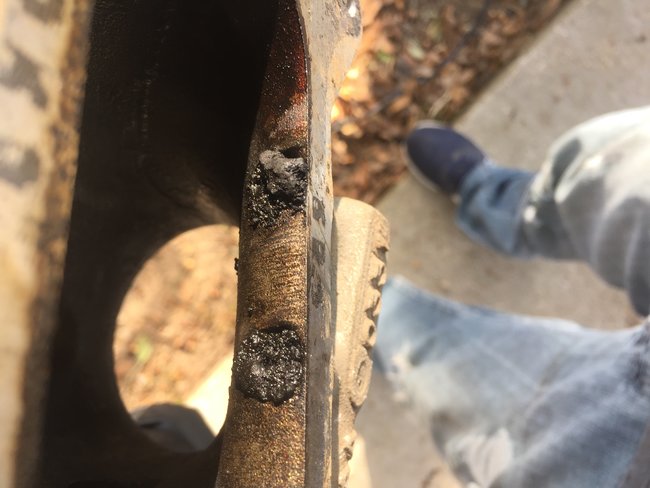

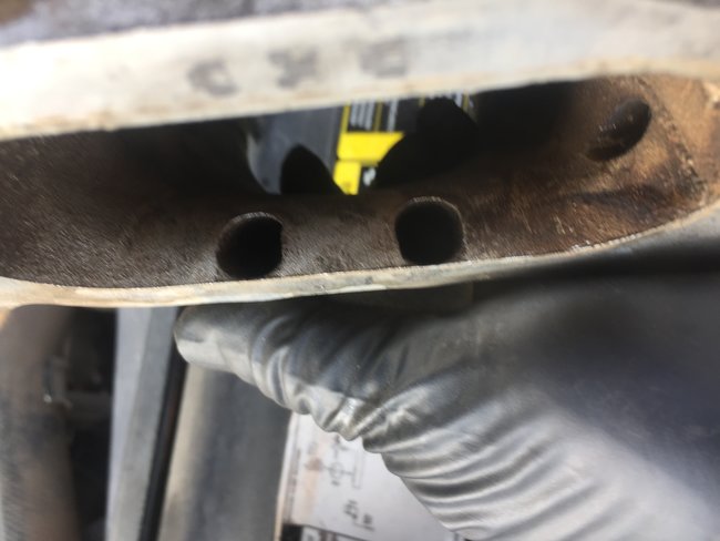

Had a code P1401 so I replaced the EGR pressure sensor which cleared the light. Few days later I got a code P0401 for insufficient flow. The 2 hoses from the sensor had deteriorated and pieces clogged up the pipe they connect to. Cleaned that out and code cleared but now I have a noise like a howl in my air box area and the hose from the evap system to the back of throttle body collapses. Could it be the EGR valve itself? Let me add I’d removed EGR valve and the ports were completely clogged up solid and I did clean it all out. I have pictures below of before and after. Thanks

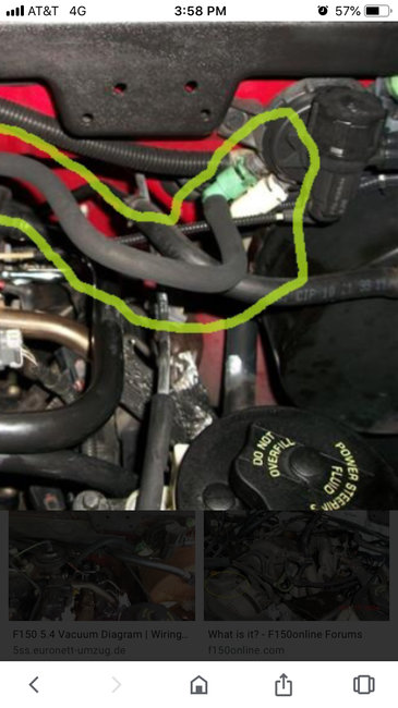

BMDOUBLE thanks for the reply but I’m talking about this hose that’s circled.
Jan 14, 2020 at 6:01 AM
BMDOUBLE
  • 1,139 POSTS
Oh okay, no problem! yes that is the evap line and they collapse due to age and exposure to fuel vapors. I actually just replaced the one on my expedition, just carefully split the line with a razor blade at the green fitting and remove the fitting. Replace the line with fuel hose then retest to make sure that it doesn't collapse. If there is still an issue with the line collapsing, the canister could be restricted or the a restriction between the tank and the purge valve, but the canister is the prime suspect.

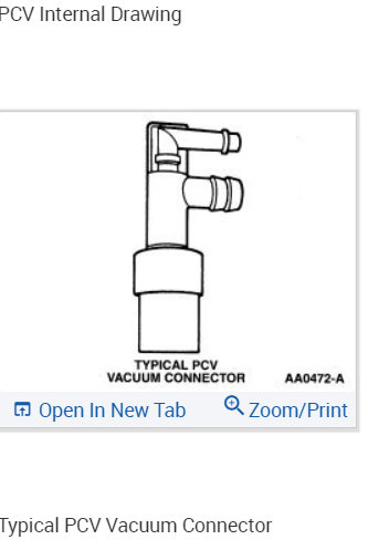

Yes, a bad PCV valve can cause EGR issues. Here is the location so you can change it out. Also I have seen clogged catalytic converters cause this issue as well. Check out the diagrams (below). Please let us know what you find.

If the box next to the canister was clogged, then the canister itself could be clogged which is common on higher mileage vehicles. If the evap line is collapsing, it would be from a restriction on the evap side starting at the purge valve then the lines that go under the truck then to the canister itself. What you can do is verify that the purge valve is not clogged by grounding the lg/bk wire then disconnecting the white fitting at the valve to see if you can feel any vacuum there, if not then the valve has failed. The PCV should have nothing to do with this line being collapsed because it is parallel to this vacuum circuit, kind of like 2 straws in a drink.
