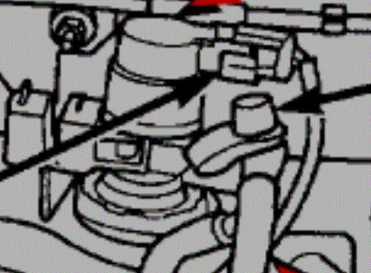

Can you provide the specific codes you have? Also, I attached a picture below. Is this the filter you are referring to? It shouldn't leak if that is what you are referring to.
Sep 21, 2020 at 10:43 AM

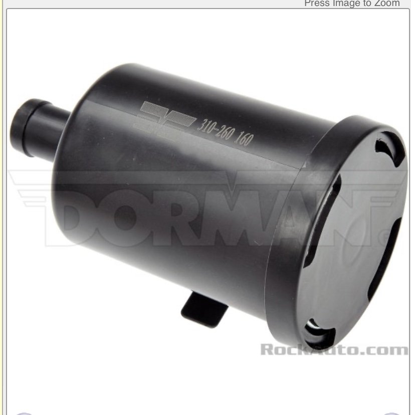

I have to ask if you could take a pic and upload it for me to see. As far as a filter behind the battery, I'm not sure I've ever seen one. I've owned Dakota's since 1990 up through the last year they made them and never recall such a thing. As far as a leak, the system is sealed and shouldn't leak. The only time I have seen a leak is if it comes through the intake and out the throttle body.
Is the component located near the EVAP test port? Does it look like the attached pic? If so, let me know. The pic is of a canister purge solenoid.

It’s called a vapor leak detection pump filter. It’s located on the inner fender behind the battery below are the purge solenoid. The hose that connects from the purge pump actually passes under the battery case.
Sep 22, 2020 at 9:46 PM
  • 110,246 POSTS
Okay, that makes sense. As far as leaking, no it shouldn't. It us used to pressurize the EVAP system to identify if there is a leak and how quickly air escapes. It will draw air in via the filter.
