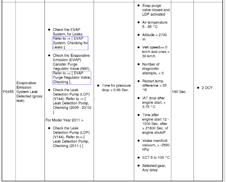

As far as the P0455, that is identified as a large leak. If you clear the code, does it return? Is the fuel cap sealing?

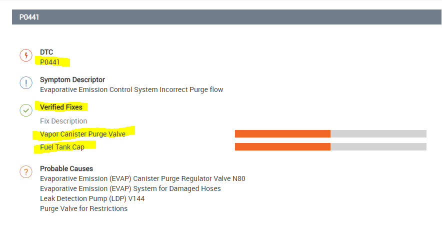

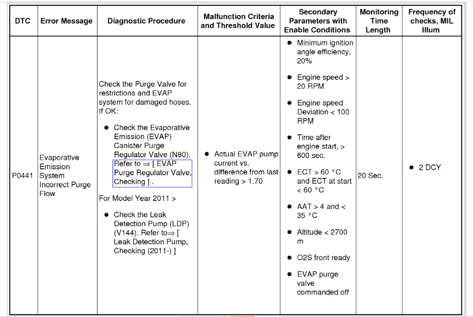

As far as the P0441, that is also related to the EVAP incorrect purge. The two most common causes of this code are either a fuel tank cap or the vapor canister purge valve.

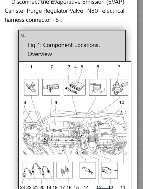

Have you checked either of these items? Take a look at the pics below.

In the image I’m providing below I checked figure 8, canister purge regulator valve, I think we might be talking about the same one. Anyway, I activated the solenoid a few times by jumping battery power to it. The harness had battery voltage within spec. And solenoid resistance it was within spec.
