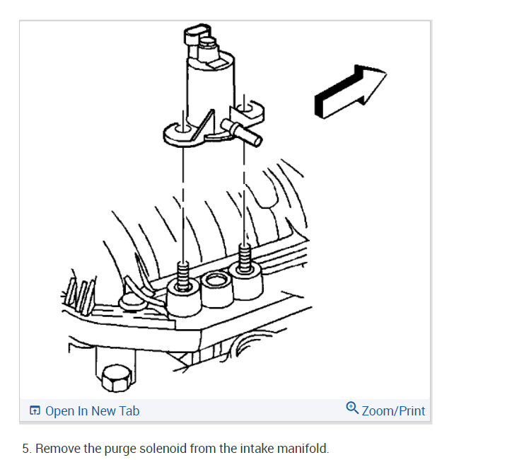

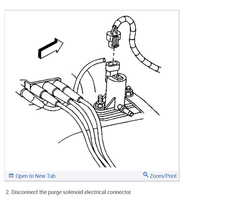

How does a purge solenoid get activated is it always on when the truck is running.
Apr 15, 2021 at 6:49 AM (Merged)

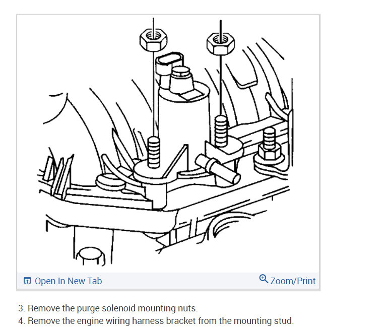

Good morning,
No, it is only activated when the system checks itself for leaks.
You can check it by removing the electrical connector, remove the hose that goes to the fuel tank. Start the car and put your finger over the port that goes back to the tank. If you feel vacuum, the valve is bad.

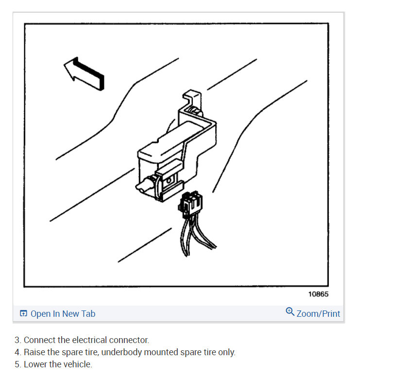

A while back I used a quarter in clear plastic ice maker line to syphon gas out of my truck it was hard and slow but I was able to get gas out.could I have damaged anything that would through code po442? my truck gas cap was always under pressure before than I'm no sure if that is when it started another thing I built my own smoke machine and I still can't find leak and I checked I get smoke when take gas cap off and when I turn vent solenoid on smoke is there another thing the truck takes forever to put gas in it's always clicking at the pump what can that be the problem that is one of the few things I haven't replaced and the evap seems to hold air now will drive it and get gas and see if it will take gas normally. If you have any more help on subject it would be most valuable.

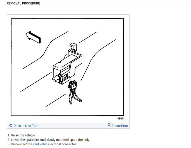

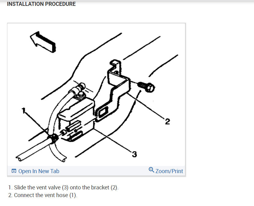

What are the results of the check for the purge valve?

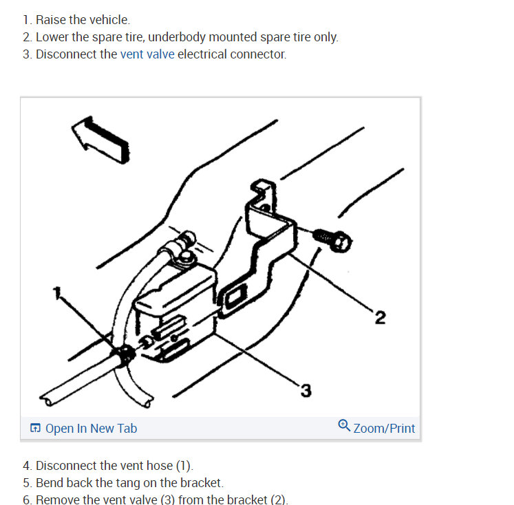

As far as the slow fill, that comes from the vent valve stuck closed not allow air to exit to air when fueling. I attached the procedure and the location for you below.

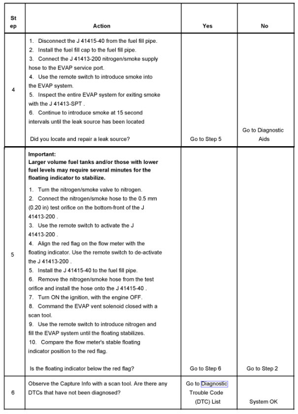

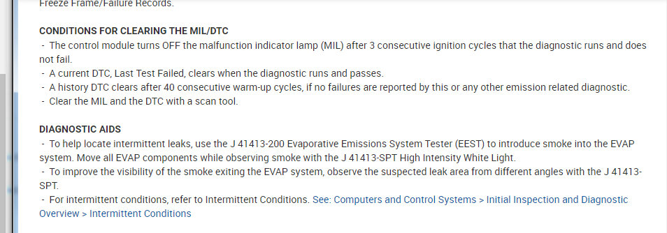

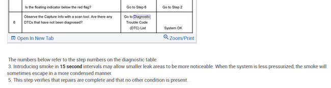

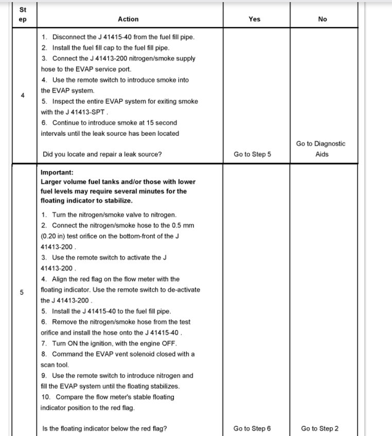

Replaced gas cap and rotted vacuum line tested purge solenoid and vent. it still has small vacuum leak po442 any have any idea how to fix or how I should test evap.I made a smoke machine. How to test with smoke machine where to start test and how? If someone knows please help. Thank you.

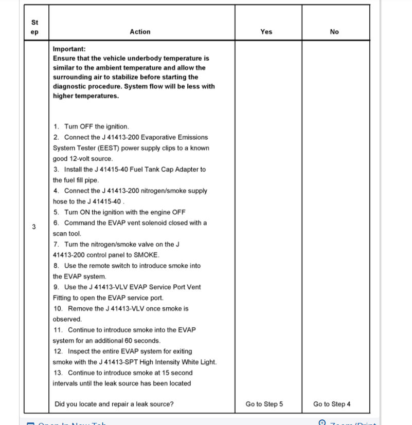

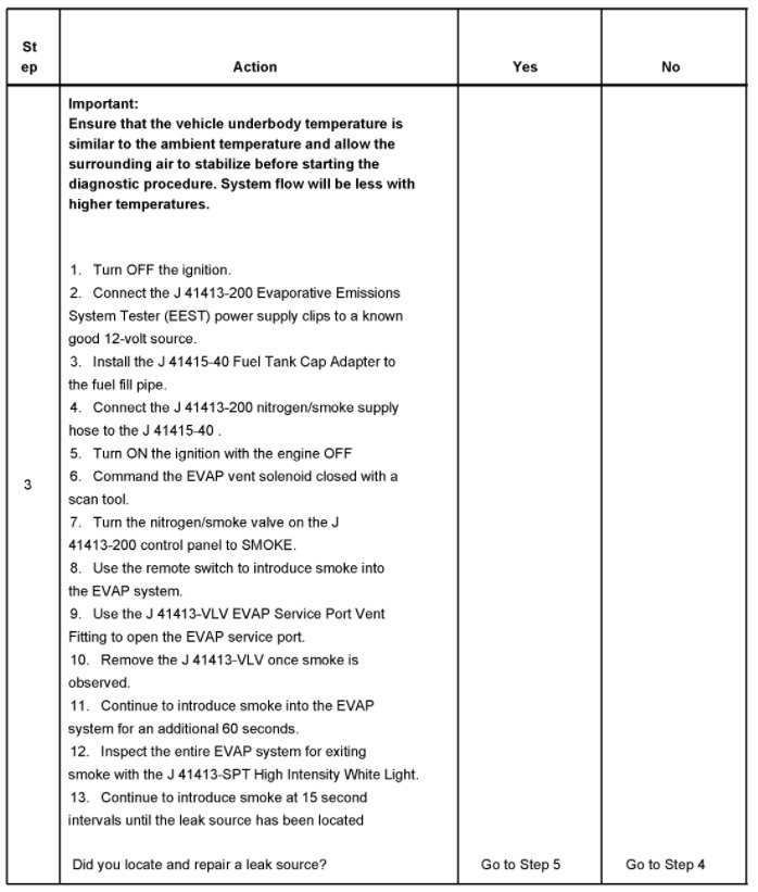

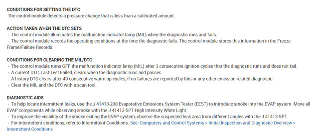

Good morning,
The small leak is a tough one to find. I would use a smoke machine to test. You will need to close the vent solenoid in order to run the test. Look for any smoke at connections, the canister, the fuel tank or the lines.
https://www.2carpros.com/articles/evap-system-code-repair
In most cases it is the purge solenoid that is the issue.

Real replace purge valve replaced gas cap replaced vacuum line that's the motor that was rotted still throws code 442. Made a smoke machine. where is the best place to hook it up? anybody have any ideas on my problem? thank you
Apr 15, 2021 at 6:50 AM (Merged)

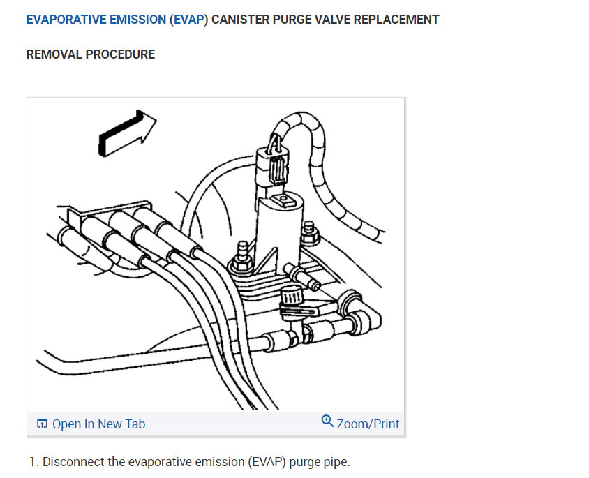

  • 110,248 POSTS

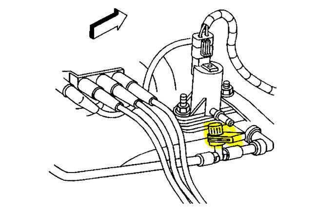

The EVAP service port is located in the EVAP purge pipe between the EVAP purge solenoid and the EVAP canister. The service port is identified by a green-colored cap.
Check the max pressure which should be listed on or near the port. I believe it is 1 PSI.
As far as what it could be, it could be anything. When you have a small leak, the best thing to do is what you are doing. You could have a cracked vacuum hose, something dry-rotted, and so on. I've even seen a small amount of rust on the fuel filler where the gas cap mounts cause it.
Try the smoke test and let me know what you find. Also, in the attached pic, I highlighted the service port.
See pic below.

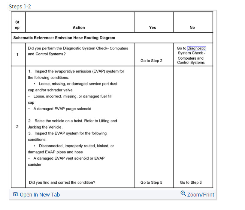

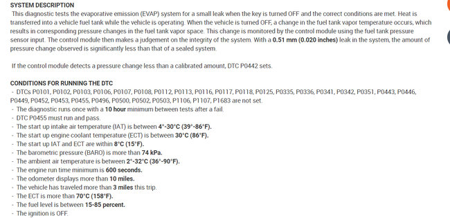

You should have what is called the EVAP service port which is what you will need to use. Please see the attached information for code and the service port.
Please let me know what questions you have with this and we can go from there. Thanks

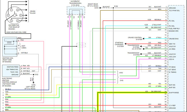

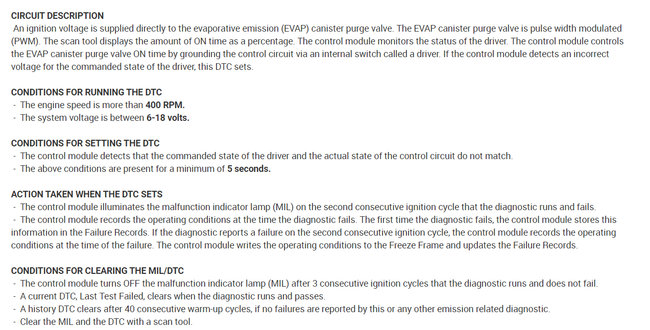

LUK2OR3
  • 23 POSTS

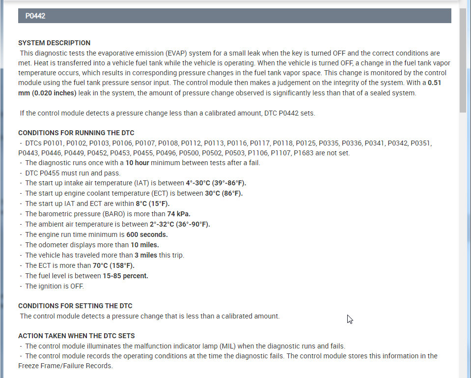

It seems to be holding pressure now. I drove truck to gas station and I didn't have any problems putting gas in but when I got back now it throws a po442 purge vcv circuit. I tested purge solenoid with wire plug not connected and truck running there's no vacuum at port do I need to replace purge solenoid and did activating the vent valve so many times get it working again or should I replace it too before it stops working again?

Sorry just woke up. I tested perg unplugged wiring and no vacuum you think from activating the vent solenoid so many times it's working now it holds pressure now and l was able to put gas in.only problem is now it throws code po443vcv purge circuit I need to replace both right.or just the purge?
Apr 16, 2021 at 1:30 AM
Okay, good.
When the cent was commanded did it open and close? A lot of times the solenoid will work but the valve will not open.
Apr 16, 2021 at 1:34 AM

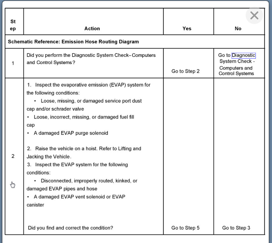

LUK2OR3
  • 23 POSTS
If your talking vent I just jumped the wires one thing that really confuses me is says the service port goes to charcoal canister not gas tank in my chilton.
Apr 16, 2021 at 2:01 AM

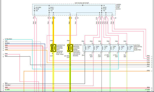

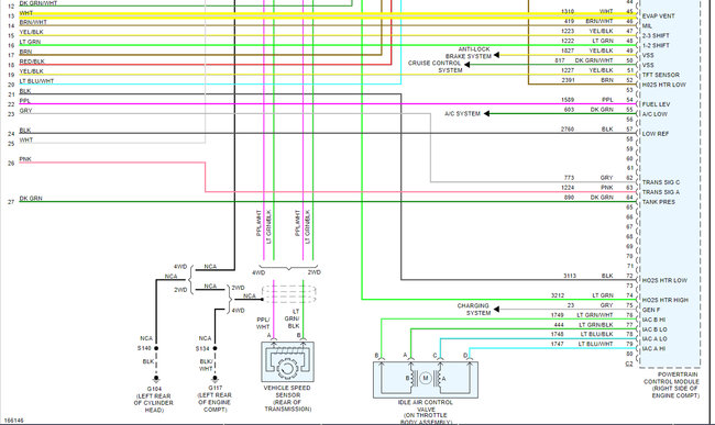

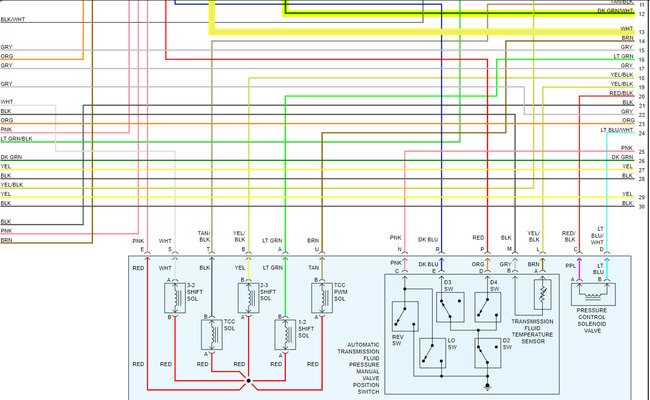

The vent is t the back of the truck on the frame. If the purge in the front passed the test, the vent is next.
You would need to apply voltage to the vent solenoid manually if you do not have a scan tool that can do this. Make sure the valve opens and closes.

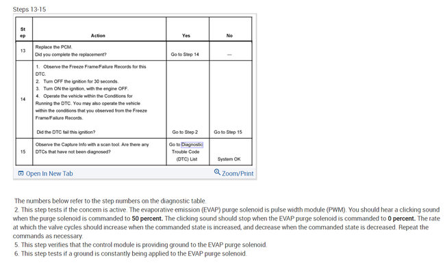

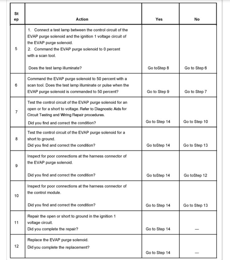

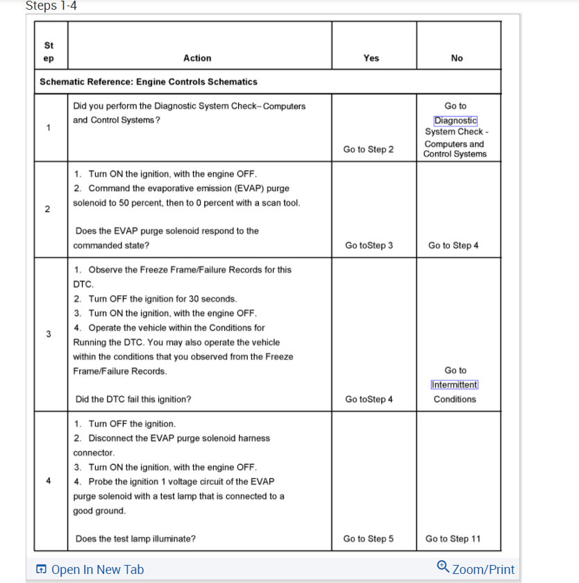

I attached the flow chart for the 443 code below. I also attached a wiring diagram of the vent solenoid and the purge valve for you.
