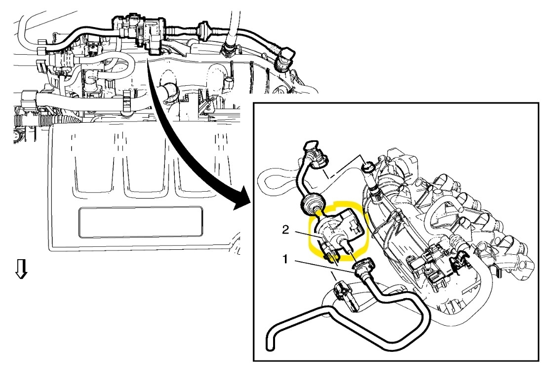

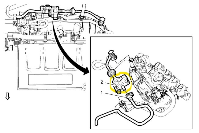

If it turns out not to be the purge valve, you will need to go about testing for an Evap leak. With a scan tool you should be able to close the vent valve and purge, then monitor the fuel tank pressure sensor, when you turn the vehicle off the pressure should start to rise in the fuel tank. Evap leaks can be one of the most difficult diags to do. Ill post a diagram of the Purge location, but Im sure you already know where it is.

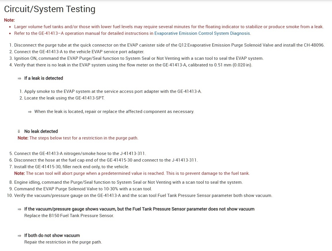

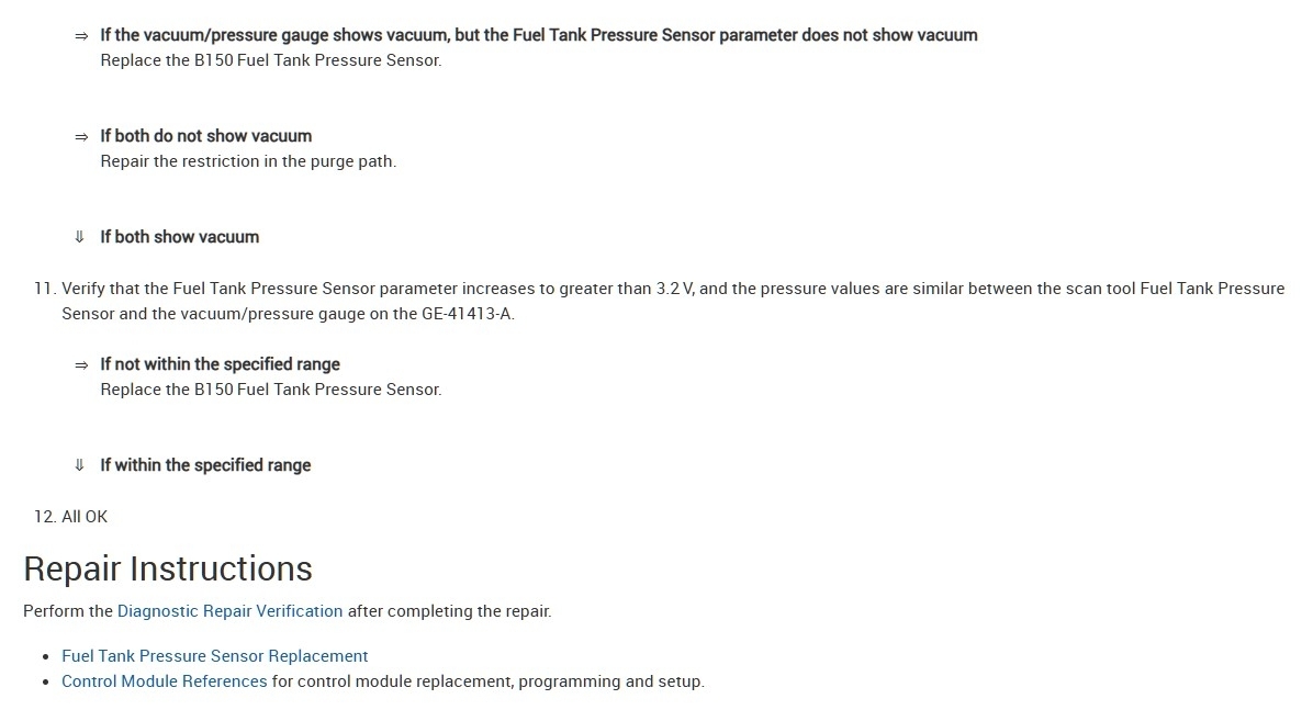

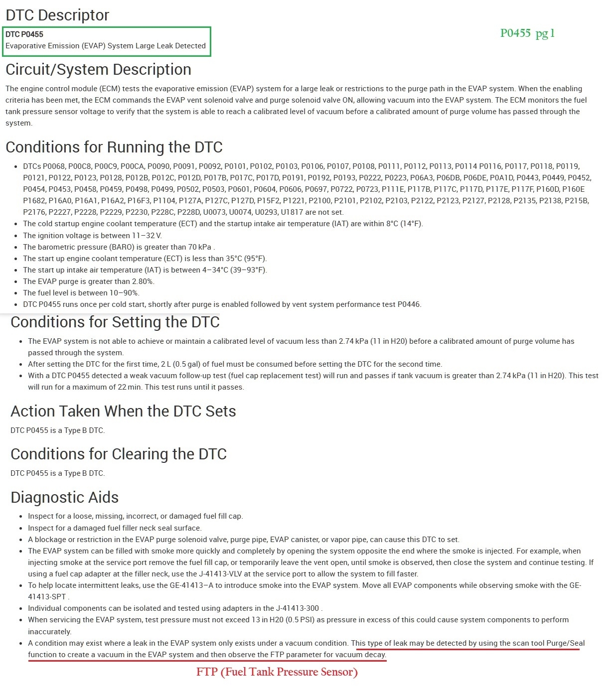

Here some service info on the P0455 code and the Purge valve location. The Purge valves can stick too, working one minute then stuck the next. So dont let it trick you.
