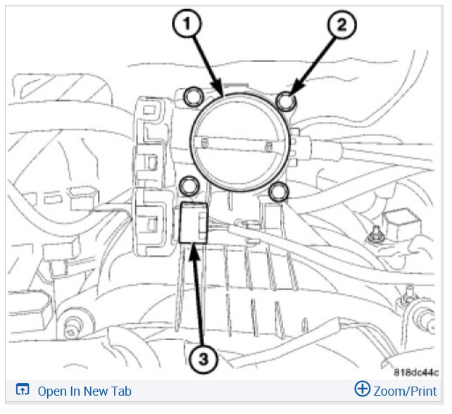

I've got this light on (picture) I have changed the etc but can't get the light to go away. I also experience "the gas pedal not working" sometimes

Yep, I have seen this problem before, I would start by servicing the throttle body, then clear the codes, then if the light comes back on, we need to run the codes to see if there are codes for the valve body or the accelerator pedal position sensor. Here are two guides that can help with the instructions for your car in the images below.
and

Okay, so the throttle body was under warranty, so I changed it out, cleaned inside and stayed it up. Currently no warning lights. Now we wait.

Drove it for 10 minutes and the "lightning" light came back on.

I would run the codes again but to me it sounds like the accelerator pedal position sensor is going out, which is on and included on the gas pedal itself.
