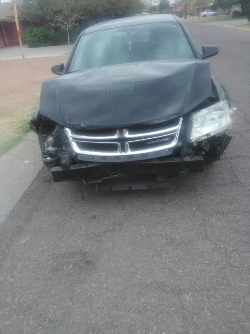

Front end damage repair estimate
2012 DODGE AVENGER
99,965 MILES • 4WD
MONTANA100
How much you thing it is to fix that?
Nov 21, 2017 at 3:38 AM
STEVE W.
  • 15,200 POSTS
Well for the external damage two fenders, hood, core support, headlight modules, grill, bumper support, impact absorber, bumper cover, new AC condenser, radiator and then the paintwork. Probably right around $4,500.00 to $5,000.00 unless there is other hidden damage. Frontal hit's can hide a lot. For instance the damage may have caused the engine cradle to shift or depending on what was hit there could be damage underneath the car that is not in the picture. If you sourced all good used parts and did a lot of the work yourself you can save money. But you need to know the processes involved.
