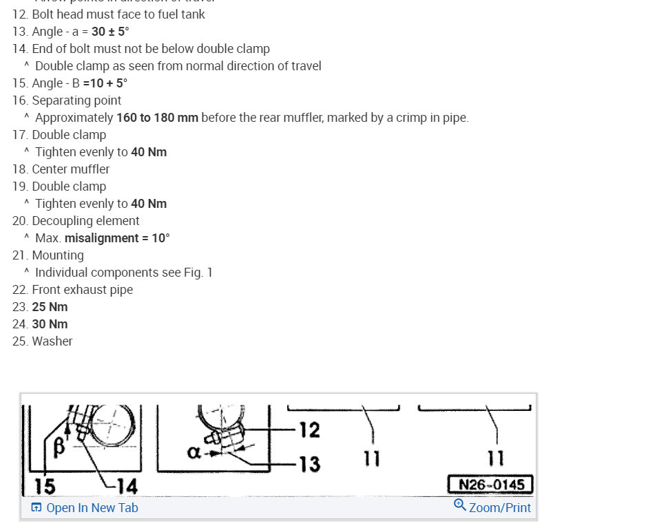

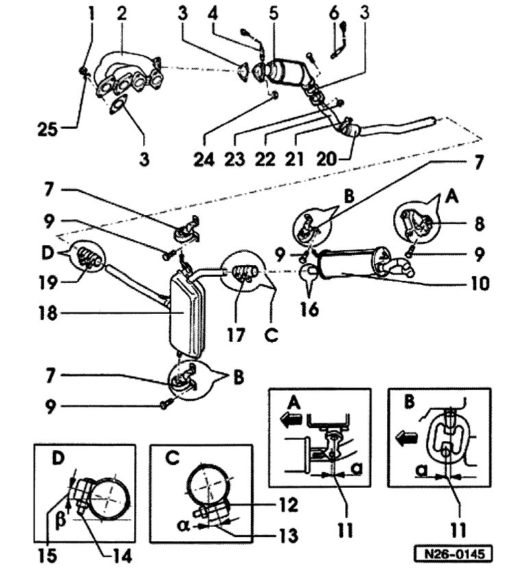

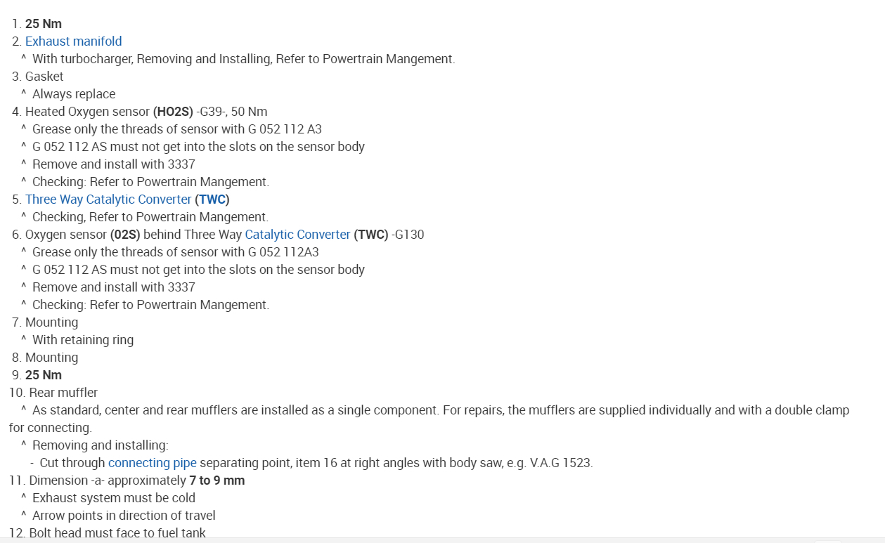

I am looking for the diagram of the ATJ engine turbo pipes, but I have no way, I have taken the vehicle to several workshops and the last one left them loose.
Could you please help me?

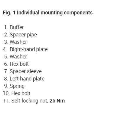

Yep, here are the diagrams for the exhaust system and turbo configuration. Check out the diagrams (below). Please let us know if you need anything else to get the problem fixed.
