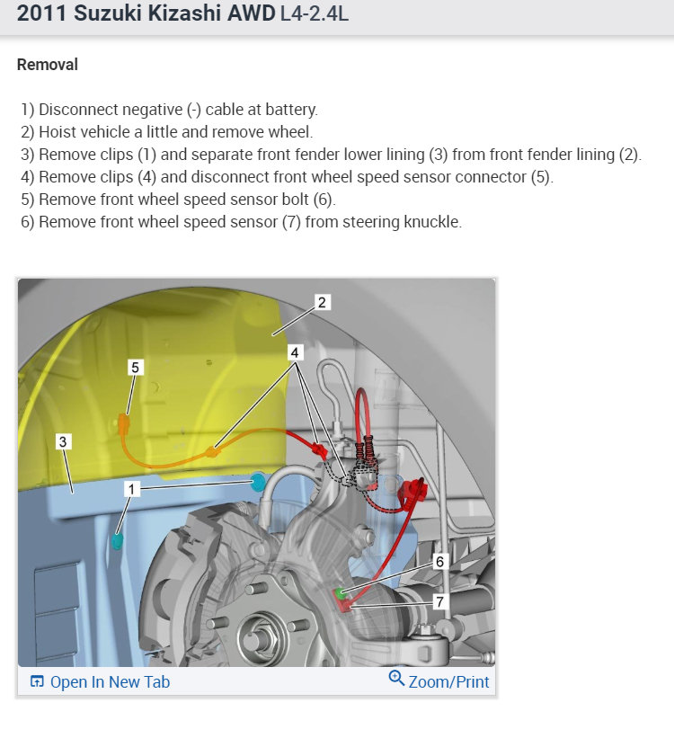

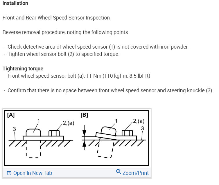

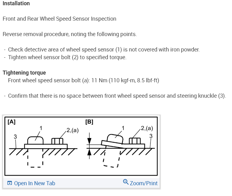

ESP light stays on.
Mar 10, 2019 at 9:44 AM
  • 55,423 POSTS
This light means the electronic stability control is not working probably due to a wheels speed sensor that was gone out. There are two ways to check this. here is a guide so you can test the sensor manually:
https://www.2carpros.com/articles/abs-wheel-speed-sensor-test
Here is a video to help you scan the ABS to find out which sensor is out:
https://youtu.be/rTtAnsOlZU4
