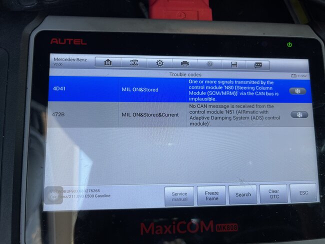

I installed the air suspension bypass unit cause the air struts were all replaced with regular struts and there was a message about the suspicion malfunction. It worked. But i still have an ESP message and the codes are in there. The car starts every time, but it struggles first then starts. Is it possible that can be a cause? Once i start it i delete the messages and they go away, then 10 seconds later they pop right back.

As far as the codes are indicating, there is no signal from the ADS module which makes sense because the air ride was removed. I can't look up either of the codes because of the model difference. I'm not sure if you are located in the US or not. If you aren't, let me know if there is a model in the US that is similar. Also, recheck the bypass module to make sure it is functional and properly connected.

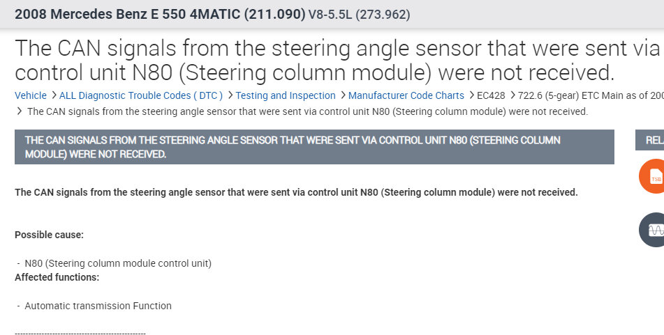

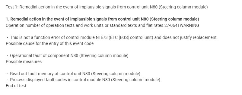

As far as the SAS, the code you have indicates there is no CAN signal from the steering angle sensor sent via control unit N80 received. In most cases, the steering wheel control module is the issue.
I attached the information below from the manual. Take a look at it and let me know your thoughts. Based on what I'm reading, the module is the only possibility.
Oct 5, 2022 at 12:00 PM

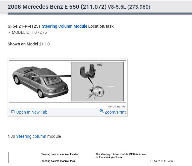

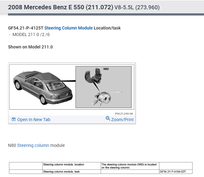

  • 110,236 POSTS
Only the N80 steering column module. The SAS communicates via this module. See pic below for the location.
