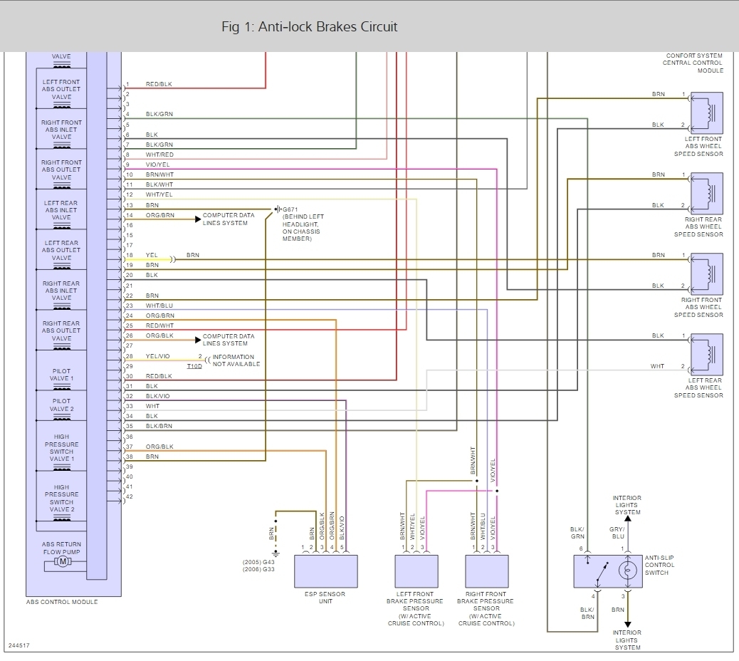

Hi All,
My car after five kilometers driving turns on ESP light. if i turn off engine and turn on again ESP light turns off. i checked with Delphi software and I found one fault
18265 Load Signal Error Message From ECU.
Please help me.

Hey Sokrat,
This code means there could be a problem with one of your struts, take a flashlight and check for oil leaking from one or more of them , this means they need to be replaced.

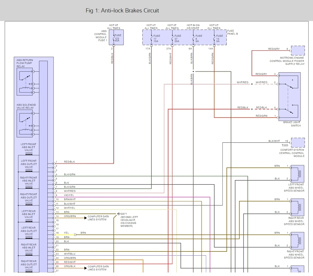

today i check all stuts and no leaks
esp lamp continue on after 5 kilometers
Dec 11, 2016 at 10:31 PM
  • 55,399 POSTS
It could be a problem with the sensing unit but there are other fuses. Also the wheel speed sensors can give you some problems as well, here is a guide that can help you test each sensor and wiring diagram to help test the system.
https://www.2carpros.com/articles/abs-wheel-speed-sensor-test
Please run some tests and get back to us so we can continue helping you.
