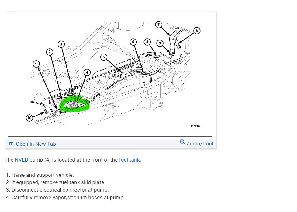

Where is the ESIM located?
2006 DODGE DURANGO
157,000 MILES
CJ111
i am trying to find out where ESIM (leak detection pump) is located so i can replace.
Jul 1, 2022 at 2:03 AM
AL514
  • 5,642 POSTS

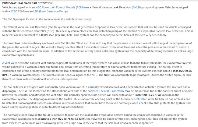

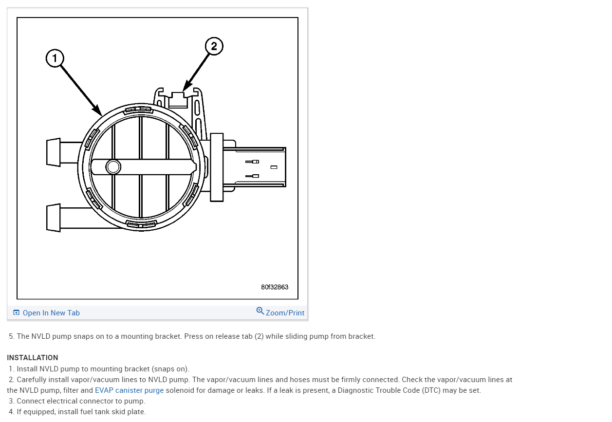

Hello, assuming you're meaning the vacuum leak detection pump for the Evap system. For both the 4.7Liter and the 5.7Liter the vacuum pump is located at the front of the fuel tank.
