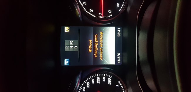

In a morning, when I started a car, I received an error on a dash: without changing gear consult workshop.
As the car is still under warranty, so I took it to the dealer (on evacuator as car were not able to move it was retuning in P mode when you try to switch gears) to investigate whats and issue.

Good morning,
I have to agree with the dealer.
After that replacement, the transmission system has to learn drivers habits for proper shifting. The control unit has adaptive strategy which means it will learn over time.
There is a quick learn procedure which I assume they have done but the final learn is you driving it.
