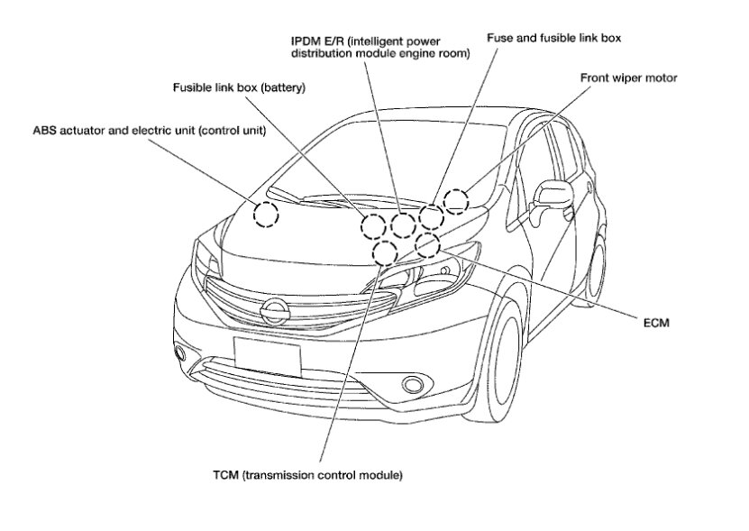

Oil spilled all over the engine after the oil cap was left off on the car listed above Note. And now it's losing power when driven.
Originally when I put on the scanner, I had codes of: P0447, P0643, P0102 and P0340. I replaced the air filter and cleaned MAF sensor, which fixed P0643 and P0102.
But after driving it to test it I noticed car losing power again. Put it back on the scanner and now I have codes P0447, P0340, P1078 and P2135.
Took one cam sensor out and noticed it was a bit fried, so I replaced it, but I am still getting the same error codes.

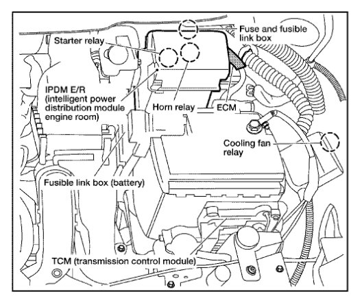

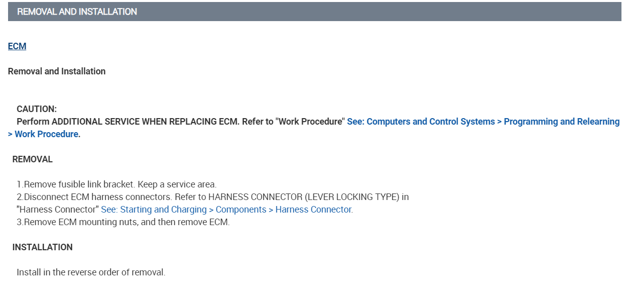

It sounds like you may have had a voltage surge which took out the PCM which happens, you can get a preprogrammed unit by searching Google or Ebay.
Here is how to change the PCM out in case you need it. Also, I have seen the IPDM cause this issue as well, but to confirm the issue with the IPDM you will need to use a CAN scanner, you can get a CAN scanner (Controller Area Network) which will work on most cars from Amazon.
