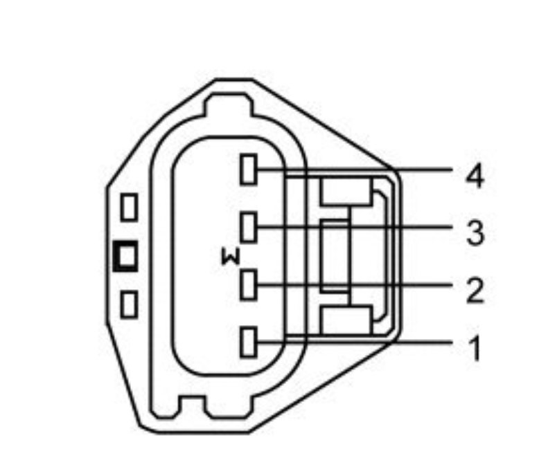

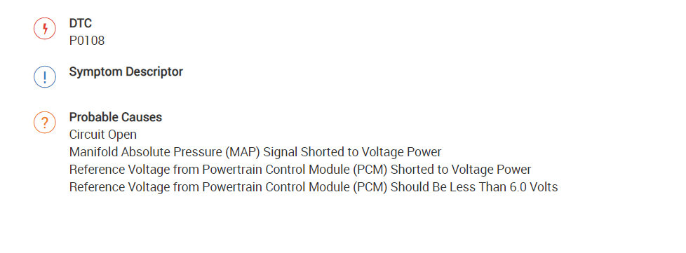

Good evening,

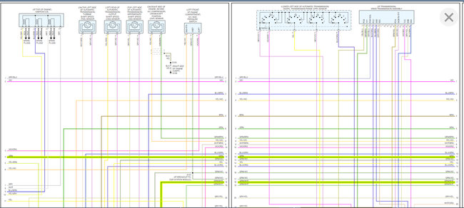

The 1700 is for the transmission. This is an information code that indicates another fault code is stored in the system. You will need an advanced scan tool that can read the transmission code for the other 700 codes.

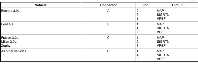

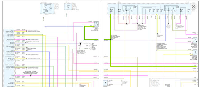

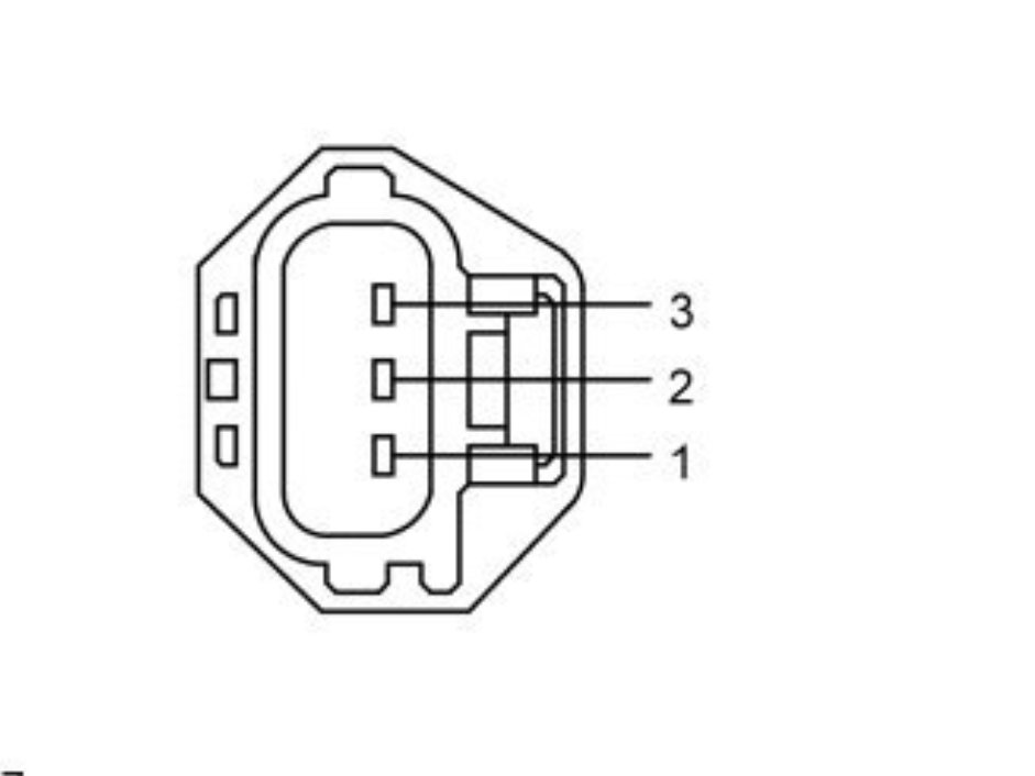

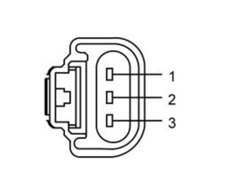

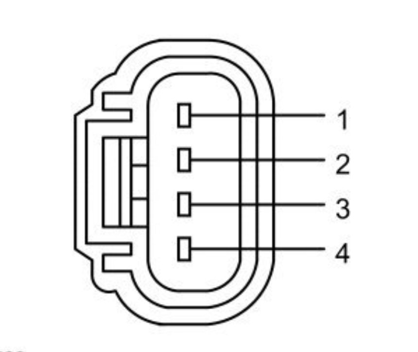

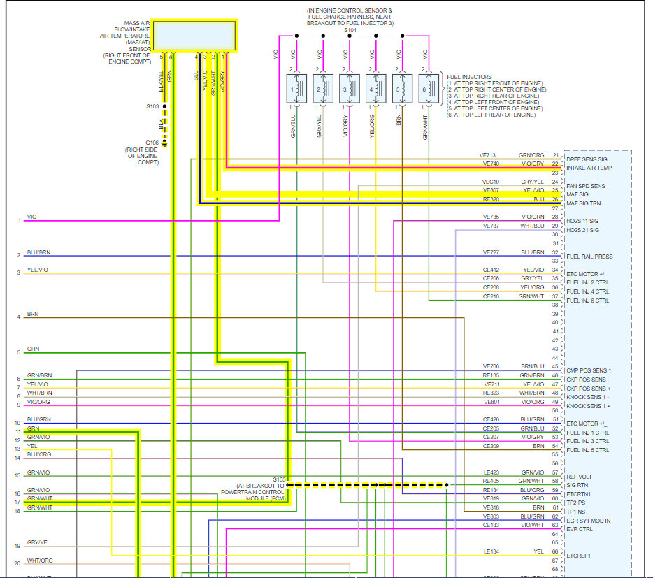

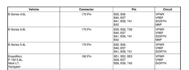

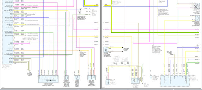

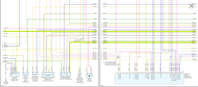

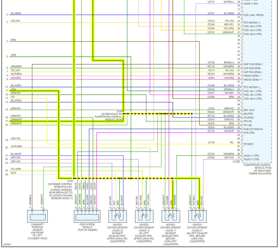

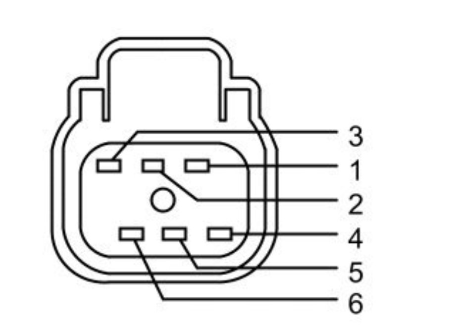

The 108 is MAP sensor related. I attached the possibilities for you to view. I also attached the flow chart for checking.
https://www.2carpros.com/articles/how-to-replace-a-mass-air-flow-sensor-maf
You need to verify voltages at the mass air flow sensor.
I attached the flowchart below for you. Let me know when you want to do some testing.
DM: Manifold Absolute Pressure (MAP) Sensor
DM: Introduction See: Computers and Control Systems > Diagnostic Trouble Code Tests and Associated Procedures > DM: Manifold Absolute Pressure (MAP) Sensor - Introduction
DM1 CHECK FOR DTCS
Are DTCs P0106, P0107, P0108, or P0109 present?
For vehicles with an EGR system module (ESM), KOEO, KOER DTCs P0107 or P0108, GO to DM2.
For vehicles without an EGR system module (ESM), any DTC P0106, KOEO, KOER DTCs P0107 or P0108, GO to DM20.
For vehicles with an EGR system module (ESM) continuous memory DTCs P0107, P0108, or KOEO P0109, GO to DM14.
For vehicles without an EGR system module (ESM) continuous memory DTCs P0107, P0108, or KOEO P0109, GO to DM26.
For vehicles with an EGR system module (ESM) DTC P0106, GO to DM15.
For all others, GO to Section 4, Diagnostic Trouble Code (DTC) Charts and Descriptions See: Computers and Control Systems > Diagnostic Trouble Code Tests and Associated Procedures > Diagnostic Trouble Code (DTC) Charts and Descriptions.
DM2 DTCS P0107 AND P0108: MONITOR THE MAP_V PID
Key ON, engine running.
Carry out the KOER self-test.
Access the PCM and monitor the MAP_V PID.
Is the voltage between 0.05 - 4.95 V?
VERIFY the PCM is at the latest calibration level. REPROGRAM if
necessary. If the PCM is at the latest calibration level, the concern is
not present at this time.
GO to DM3.
DM3 VERIFY HARNESS AND CONNECTOR INTEGRITY
Key in OFF position.
ESM connector disconnected.
Carry out a thorough visual inspection of the connector, pins and wires attaching to the pins.
Are there any concerns with the wiring or the ESM connection?
REPAIR as necessary.
CLEAR the DTCs. REPEAT the self-test.
GO to DM4.
