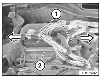

My positive terminal in the hood made contact with a ground and shorted out. I replaced the power distribution box and the valve-tronic relay. Code is still there.

So chances of both sensors going out at the same time is a possibility but I have seen the DME go out as well.
2A77 - Oxygen sensor after catalytic converter, signal response too slow (bank 2)
2A3F - Oxygen sensor before catalytic converter, signal response too slow (bank 2)
If you change the sensors out and you get the same codes, I would get a preprogrammed DME which should fix it. Here is the location of the DME so you can swap it out in case you need it. Check out the images (below). Let us know how it goes.
