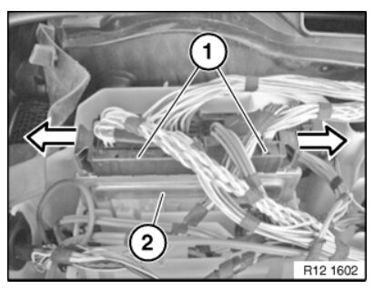

If you change the sensors out and you get the same codes, I would get a preprogrammed DME which should fix it. Here is the location of the DME so you can swap it out in case you need it. Check out the images (below). Let us know how it goes.
