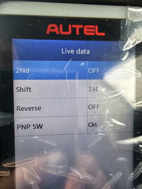

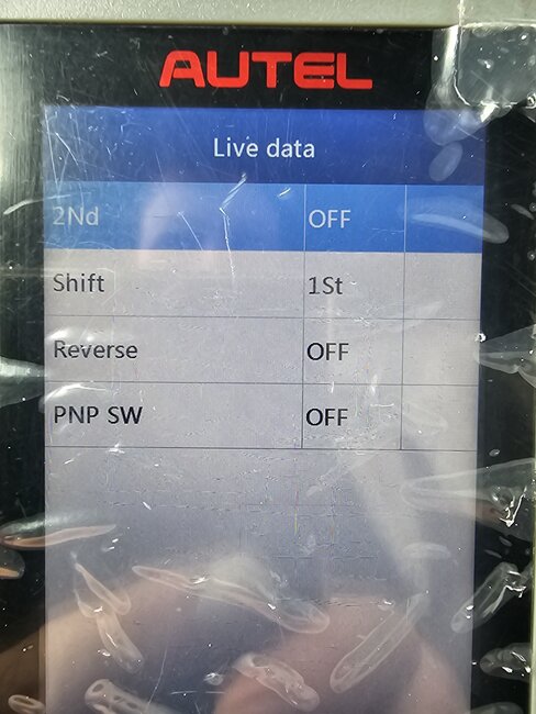

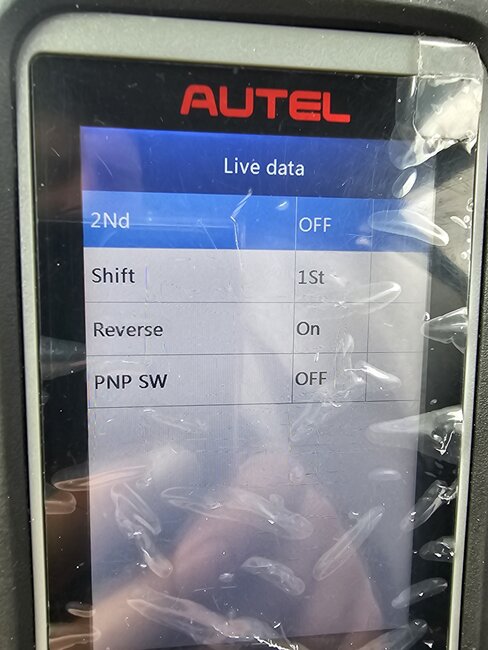

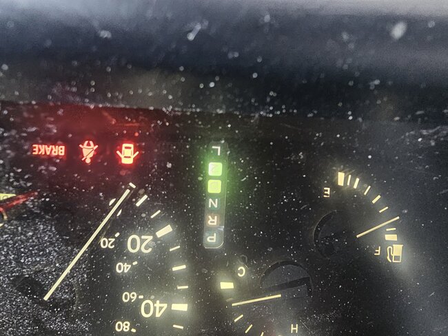

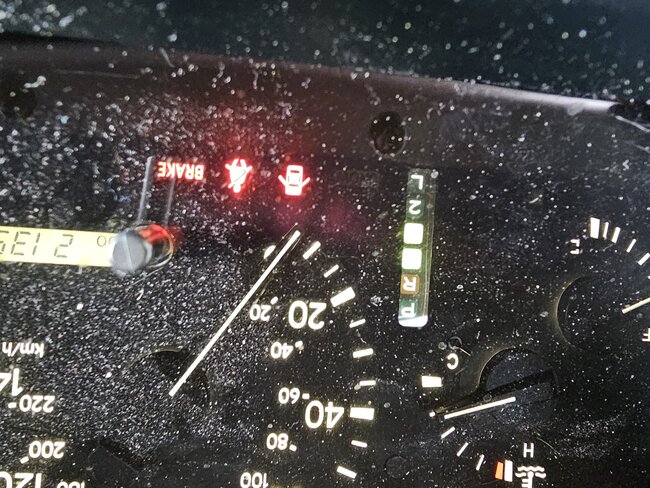

My previous question was removed. However, there is huge update - suspect ECU failure. Vehicle start and running. Replaced NSW and error still active/same. All signals from NSW to ECU seems correct with solid battery voltage, no shorts between wires. I've replaced burnt bulb for "D" on dash and found - when change from "N" to "D", it takes about 3 seconds to "D" appears, same for "2" to "D". When change from "D" to "N" or "2", "D" stay on for 3-4 seconds, together with "N" or "2", then turns off. I open ECU and check for leaked capacitors and cracked soldering points - all seems OK, cleanup ground to cover. Check, and now time to change indicator changes to 5-10 seconds. It is feels as capacitor slowly charge and slowly discharge. There is JC8 on the way to dash from ECU that I plan to check, but very low chance it would be root. Also, I want to check if there is any delay from NSW to ECU - low chance since there is simple mechanical switch, so disconnect should be quick. Have no idea where to look anymore. Can you please advise what to check. Thank you.

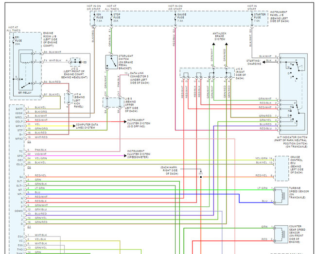

When the P1780 code is set, it means the vehicle's control module has detected a malfunction within the park/neutral position switch circuit. I would try disconnecting the ABS controller to see if the action to the inductor lights gets any better. This is where the JC8 connector breaks off to the ABS system. Also did you do a CAN scan? It might be the instrument cluster itself that is bad. You can get a CAN scanner (Controller Area Network) which will work on most cars from Amazon.
https://youtu.be/u-4syLc-ifQ

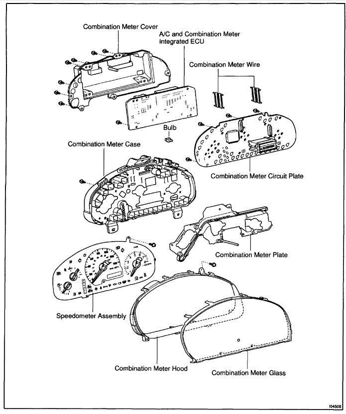

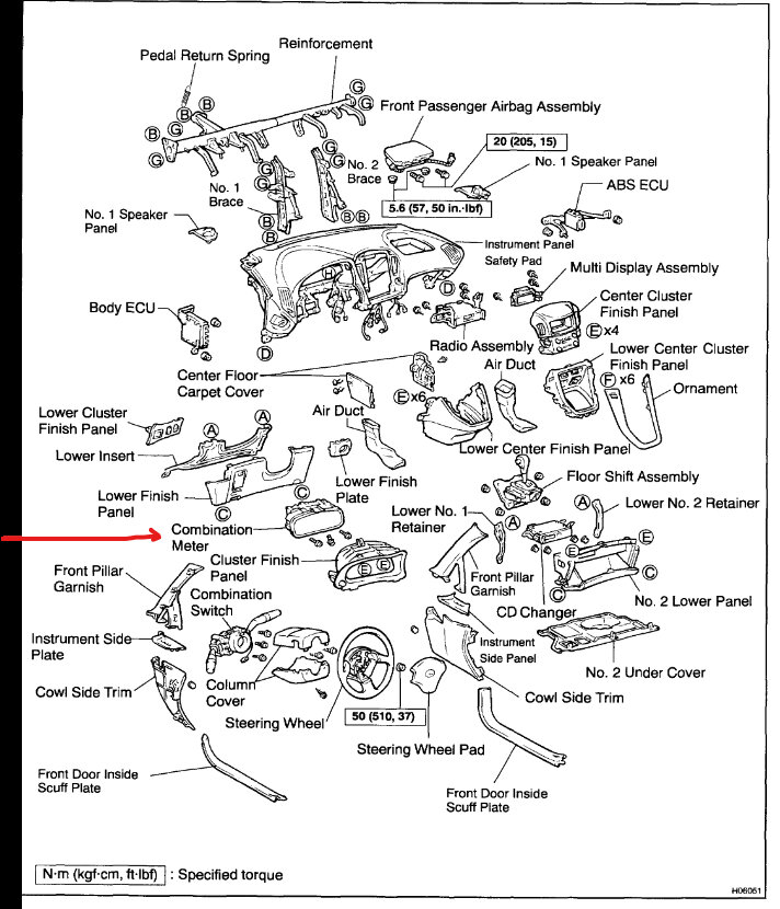

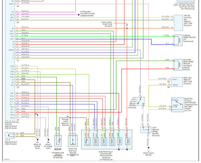

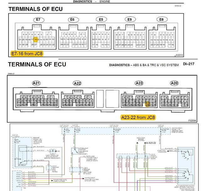

Here are the wiring diagrams for the neutral safety switch so you can see how the system works. I don't think it can be the PCM. Here is how to change out the cluster which you can send out for testing. Check out the images (below). Please upload pictures or videos in your response to the problem so we can see what's going on.

I use CAN scanner - Autel MD808P.
By disconnecting ABS controller you mean skid ECU, ABS pump, or JC8 connector?
Do you have a picture how JC8 is looking, or I can try to trace it from ECU.

BTW your wiring diagrams way better than I found online, easier to work with.

If I will not find JC8 connector, I guess, I can remove pin/wire 22 from connector A23.
It should work to test, correct?

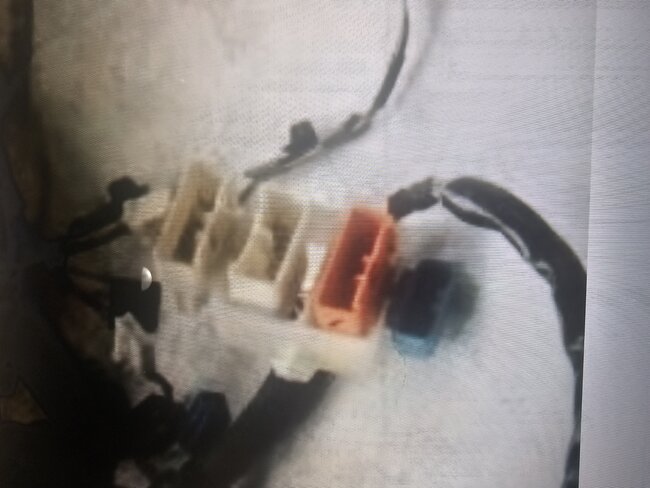

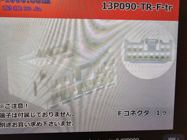

Good morning, Ken,
Thank you, we already checked several times new and old sensors, both working, and reconnect connector and make sure it is secure.

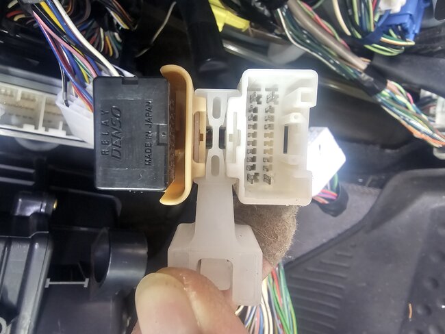

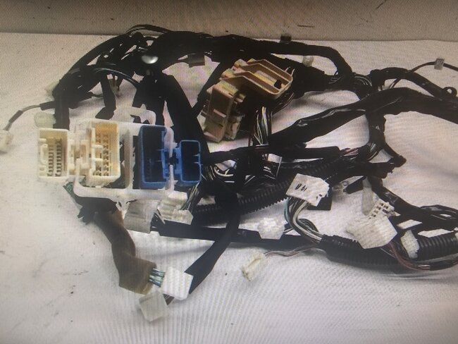

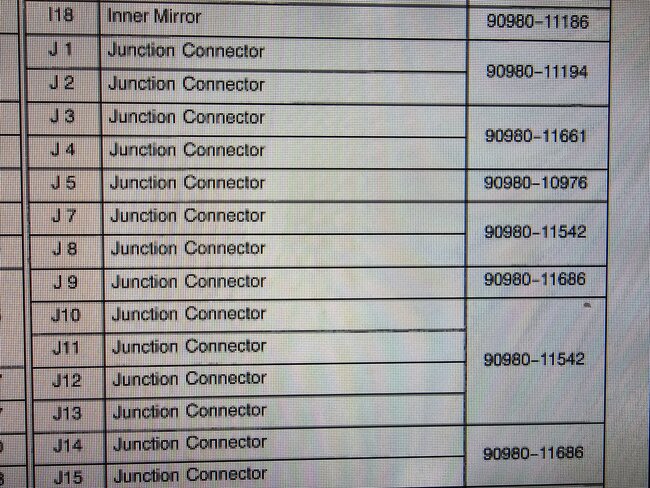

Also, it seems I might locate, in theory, JC8. Found how it should look by part number, then search for dash wirings on sale.
I've attached pics.
I will proceed with advised steps on the weekend and report.
Thank you very much for your help, now I have an idea where to look.

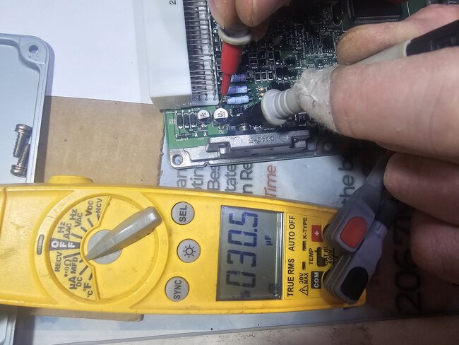

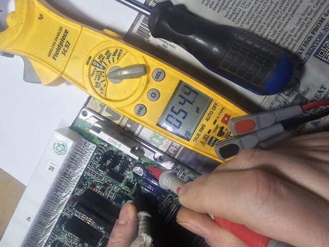

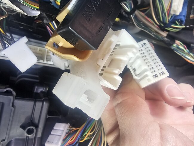

Hello Ken,

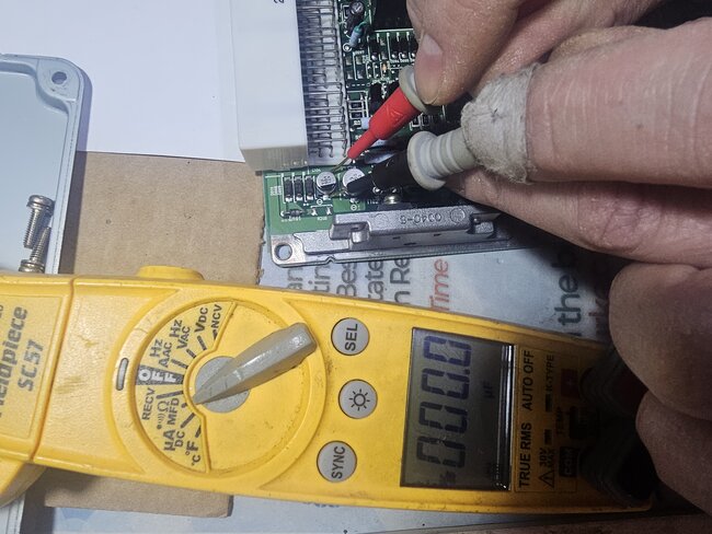

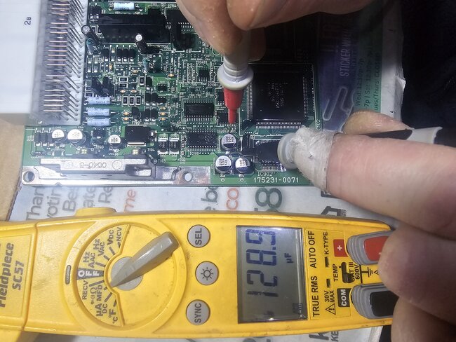

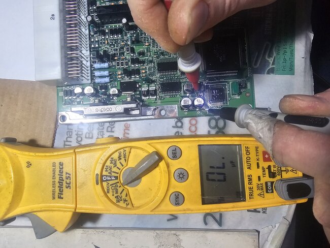

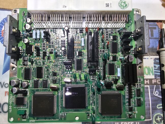

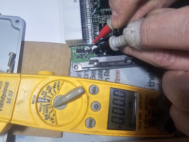

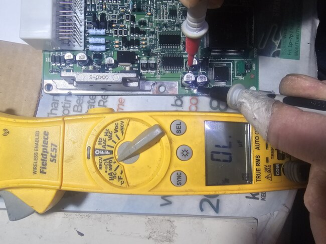

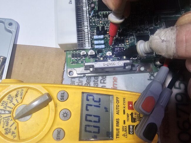

Everything before ECU seems okay. Found JC8 connector, it sits on same bracket where ECU, looks different than found by part #. Found tester to measure capacity, seems 3 dead and one degraded capacitors. Please see attached pics. Will order capacitors and re-solder when arrived. Will post updates once proceed.

  • 26 POSTS
On battery 11.5v now, On switch black/white -10.5v. On ECU and ABS - "D" 10.5v
Now I'm really suspect ECU capacitors, especially with measurements.

MUSTK
  • 26 POSTS
Hello Ken,
Today i received and replace capacitors.
Offboard 2x 10uF caps show 0. others out of range, however might still work with reduced performance.
Next weekend I'll test on vehicle and report.
Thank you again for your help!

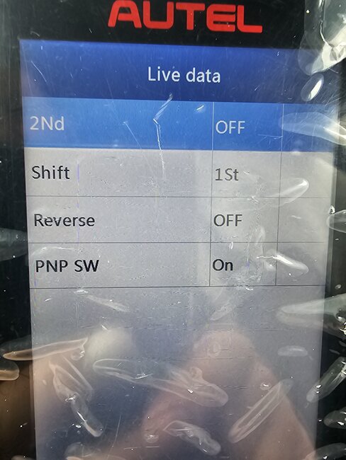

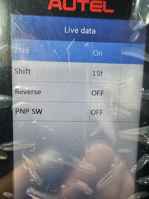

Same thing. Only D it's on faster sometimes. Maybe something on the speedometer part... when run live data on scanner it shows all changes right away.

Not speedometer... I completely removed it. Reset error and check. After changing lever, error get back.
Apr 6, 2024 at 3:21 AM
  • 55,732 POSTS
I see your other question in the que it has not been approved, did you get an email for it to be approved? Because the scanner sees what gear you are in, but the cluster does not, I would send the cluster in for testing or try a used cluster to see if that fixed the problem. You might be able to take the cluster apart and see if anything is burnt. Check out the images (below). Please let us know what happens.

I took a cluster apart and did not find anything suspicious. I also completely unplugged it, reset error, shift lever several times, waiting 20 seconds on each position, and got same error. Do you think 1V difference between battery and NSW might cause it?
