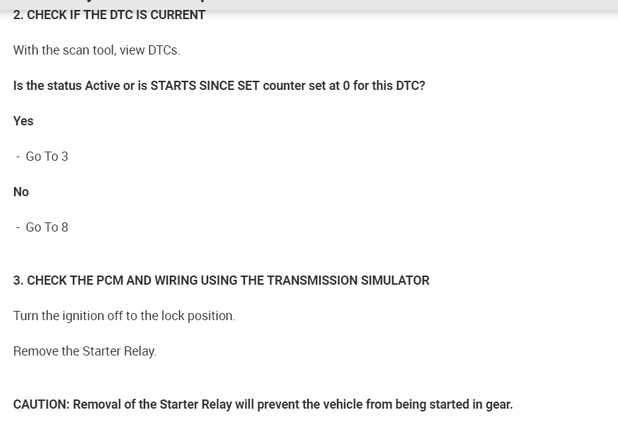

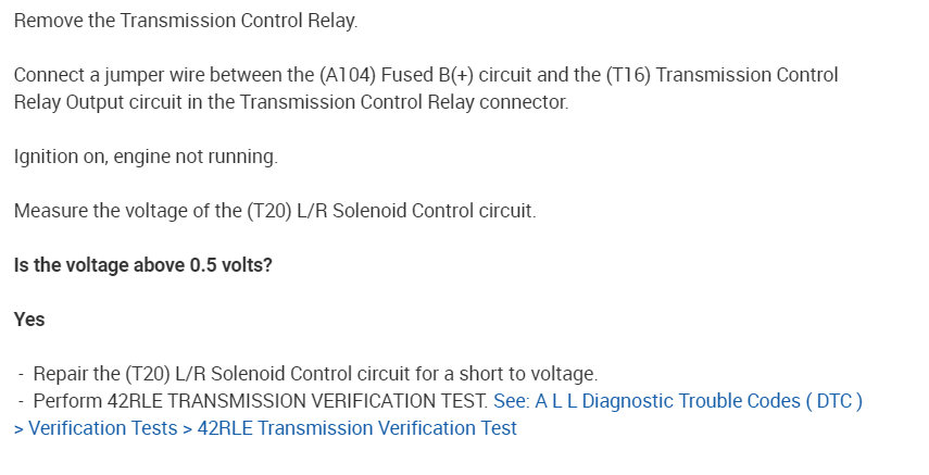

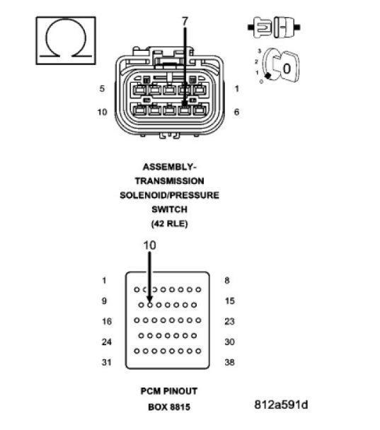

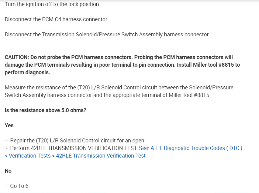

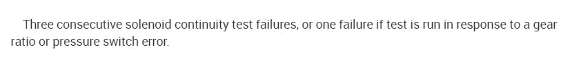

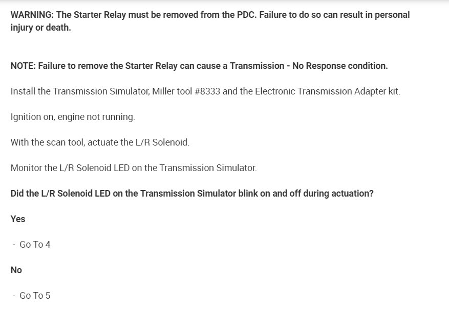

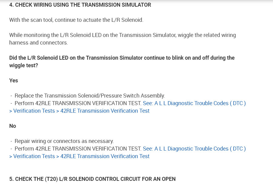

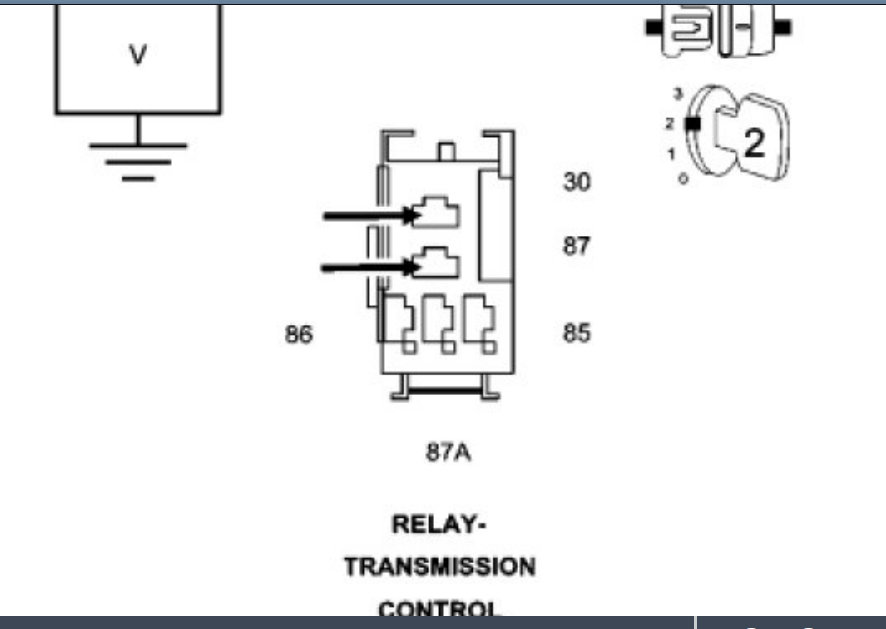

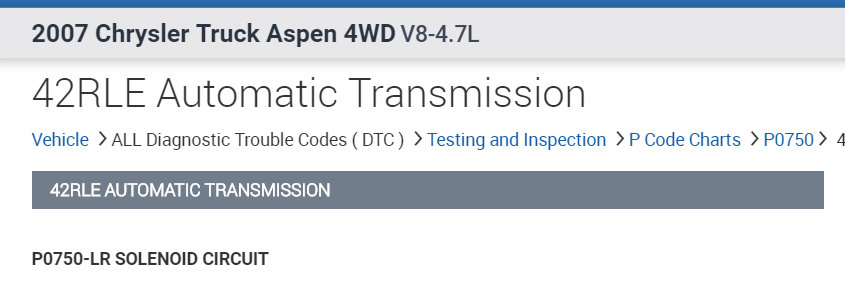

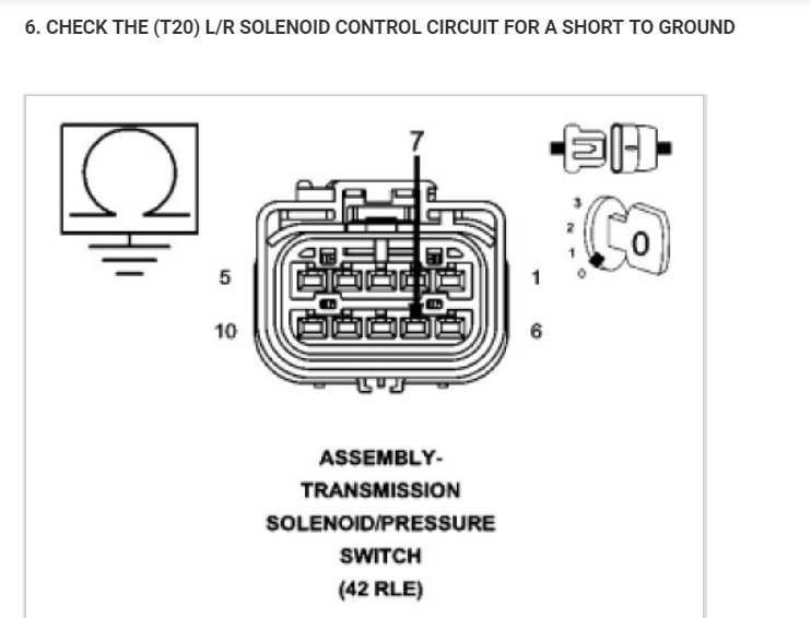

Car is putting out error code p0750 and transmission is going into a limp mode (stays only in second gear will not up or down shift). It’s looking like I may have to replace shift solenoid. But wondering if it may be something else. Same day code was put out lost brake lights. Not sure if they may both be on same circuit or not.
May 19, 2019 at 2:54 PM
SCGRANTURISMO
  • 4,897 POSTS

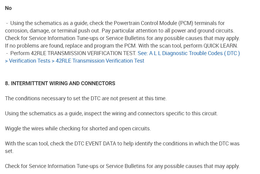

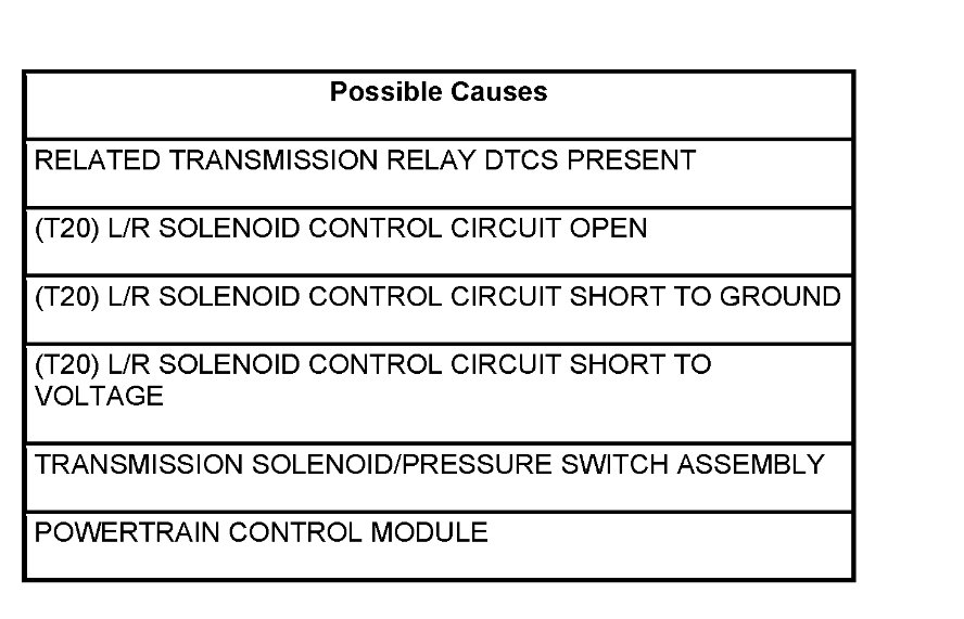

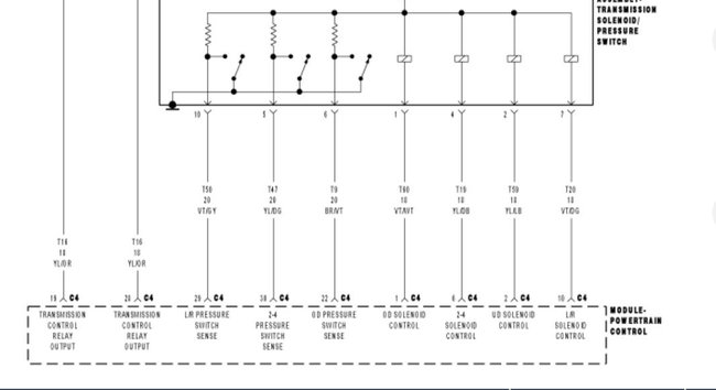

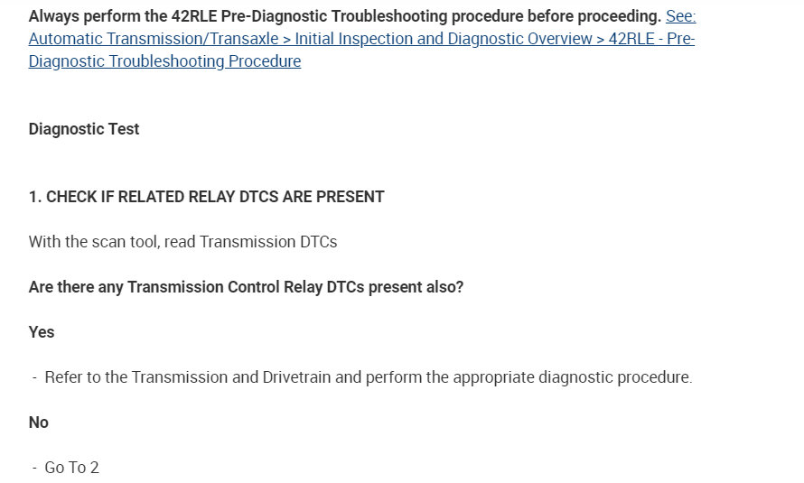

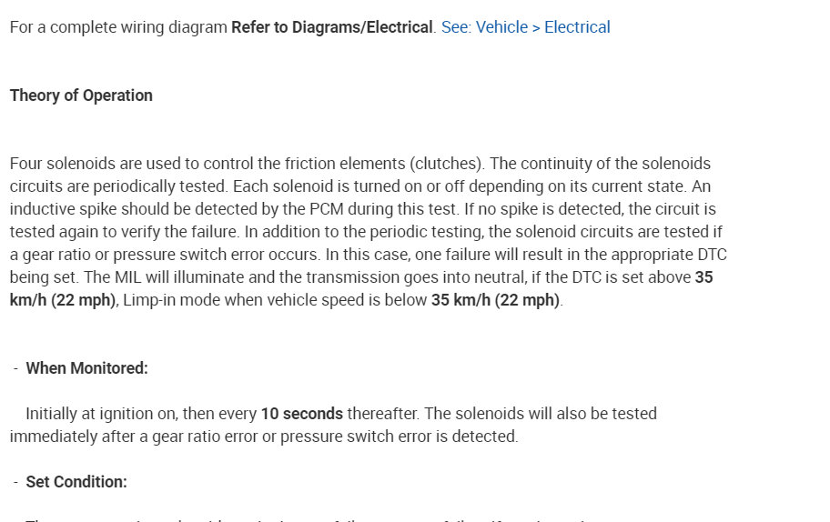

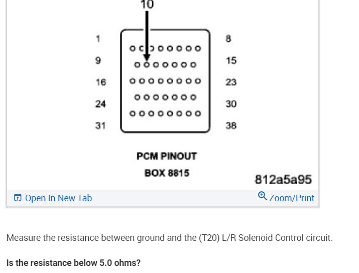

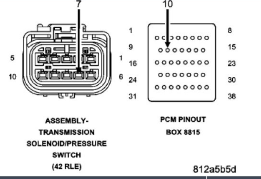

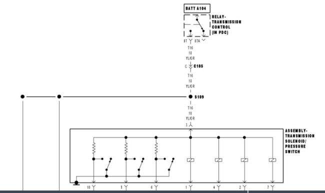

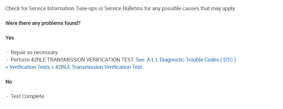

I have included in the diagrams down below the factory troubleshooting diagnostic guide for your vehicle's Direct Trouble Code (DTC) P0750. Please go through this guide and get back to us with what you are able to find out.
