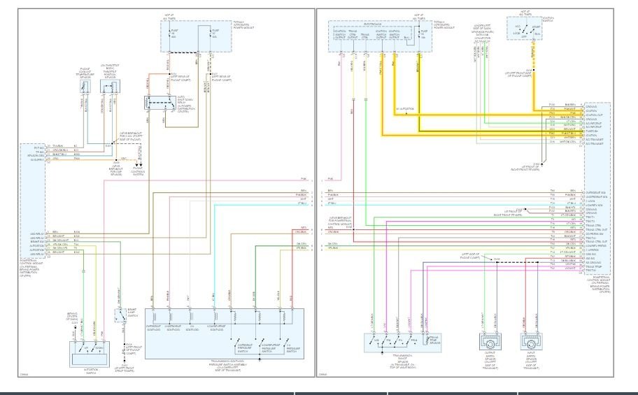

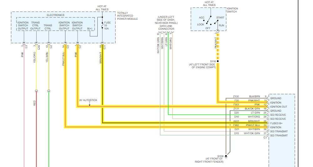

Just had codes reread. Now p0700 and p0882. Does that change anything as far as what to do to fix the problem?
Aug 9, 2019 at 12:17 AM
Is this with the new or old PCM?
I attached a wiring diagram for you. Check for powers to the PCM on all the highlighted wires.

Aug 9, 2019 at 12:57 AM
UOPHNX01
  • 13 POSTS
This is with a new PCM. I have had to replace two within a year.
