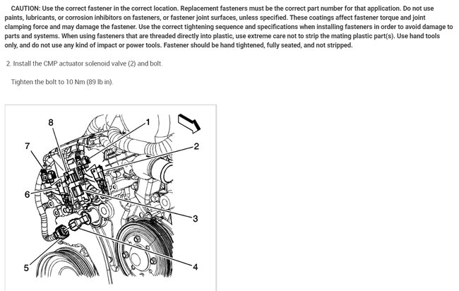

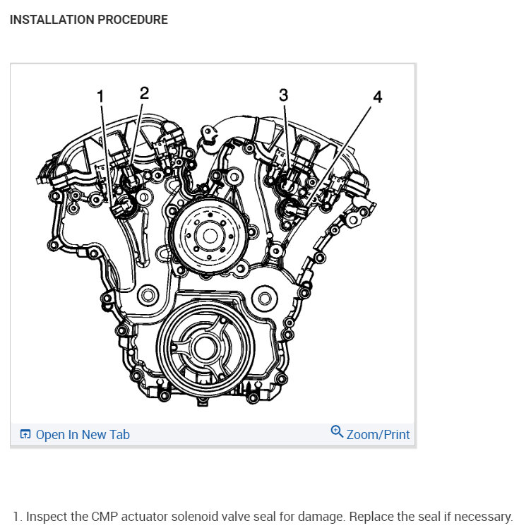

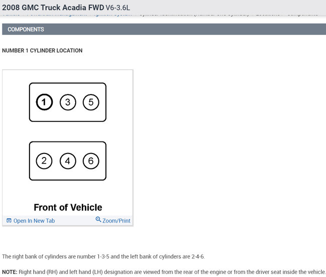

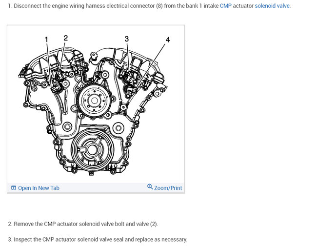

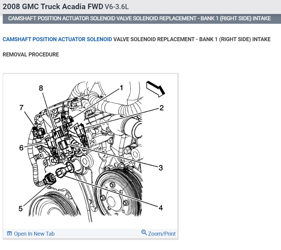

I ran a code scanner, and it came back with the code P0011 and said roughly (VVT Solenoid Intake Bank 1). So, I bought a replacement solenoid and I’m trying to find out where Bank 1 is on my engine.
Nov 14, 2023 at 4:09 AM
  • 55,721 POSTS
Bank #1 is near the firewall. Here is how to change out the VVT Solenoid Intake Bank 1 correctly. Check out the images (below). Let us know if you need anything else.
