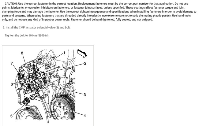

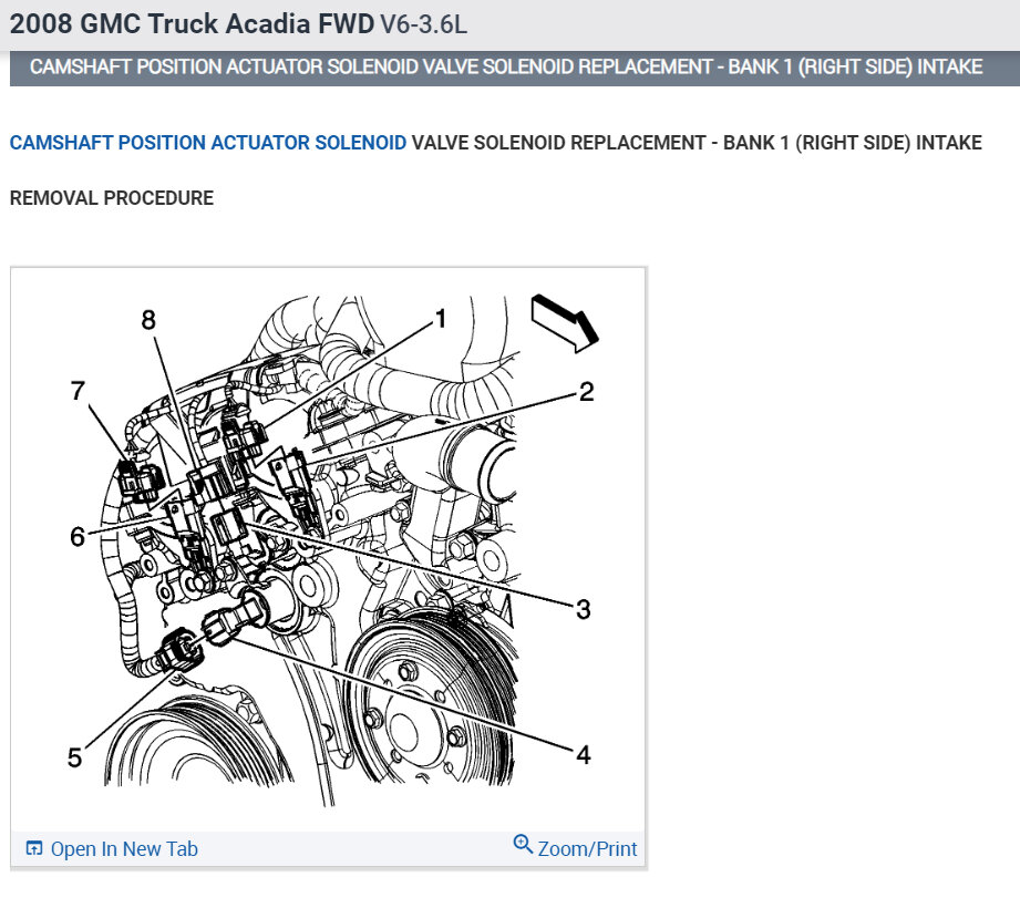

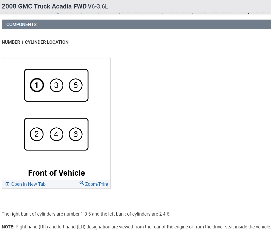

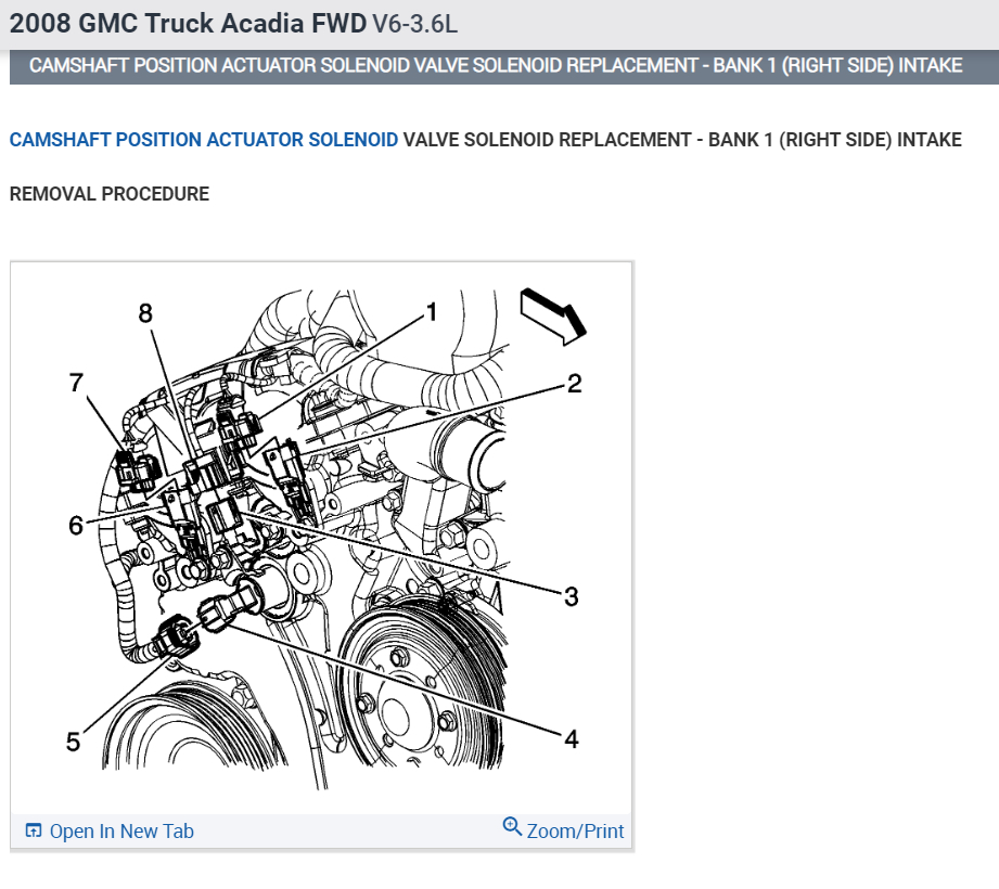

Code P0011 VVT (Variable Valve Timing), where is the Bank 1 Intake located?
2008 GMC ACADIA
165,000 MILES • 1.0L • V6 • 4WD • AUTOMATIC
JWAY
I ran a code scanner, and it came back with the code P0011 and said roughly (VVT Solenoid Intake Bank 1). So, I bought a replacement solenoid and I’m trying to find out where Bank 1 is on my engine.

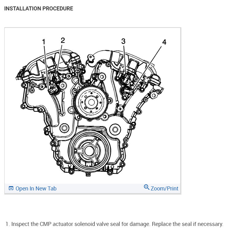

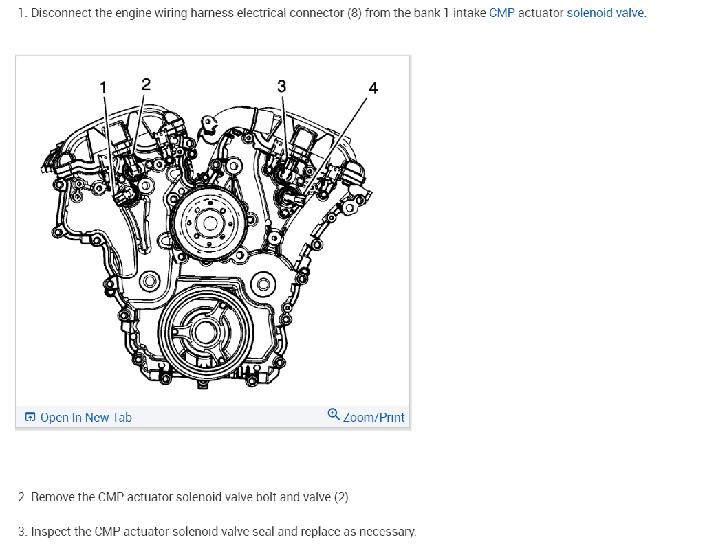

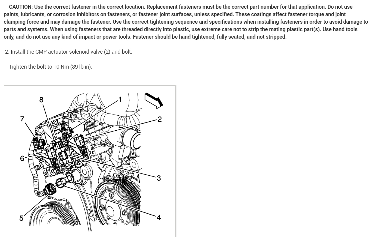

Bank #1 is near the firewall. Here is how to change out the VVT Solenoid Intake Bank 1 correctly. Check out the images (below). Let us know if you need anything else.
