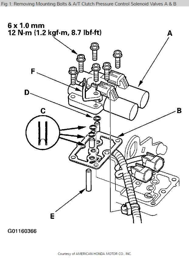

For this trouble code, it should be the pressure control valve that is causing the problem. The diagram shows what it is and this component is known to fail quite often. However, replacing this component does not necessarily solve the problem as internal damage could have occurred after when problem started. Below is the testing procedures
DTC P1750: Mechanical Problem In Hydraulic Control System Of A/T Clutch Pressure Control Solenoid Valves A & B, Or Problem In Hydraulic Control System
NOTE: Record all freeze data and review General Troubleshooting Information before you troubleshoot.
Check whether the OBD II scan tool indicates another code.
Does the OBD II scan tool indicate another code?
YES - Perform the troubleshooting flowchart for the indicated code(s). Recheck for code P1750 after troubleshooting.
NO - Go to step 2.
Turn the ignition switch OFF.
Replace the A/T clutch pressure control solenoid valves A and B. See A/T Clutch Pressure Control Solenoid Valves A and B Replacement .
Reset the PCM memory by removing the BACK UP fuse in the passenger's under-dash fuse relay box for more than 10 seconds.
Calibrate the engine control system in the PCM, see PCM Idle Learn Procedure , and drive the vehicle for several minutes in 1st, 2nd, 3rd, 4th, and 5th gears in the [D 5 ] position.
Recheck for code P1750.
Does the OBD II scan tool indicate code P1750?
YES - Replace the transmission.
NO - The problem has been corrected.
Mar 29, 2018 at 11:59 PM

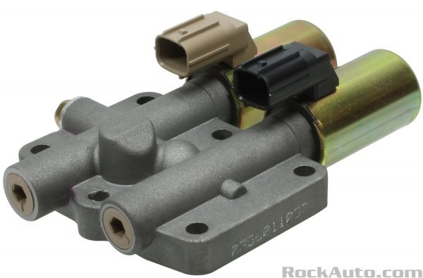

Is the solenoid A and B the linear solenoid? I have a picture of one I found just want to make sure I am looking at the right thing. Thanks.
Mar 30, 2018 at 3:40 AM
KHLOW2008
  • 41,814 POSTS
Yes, it is.

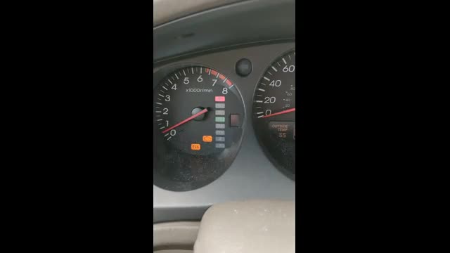

Got that part you said to get replaced and did not help. Twice after getting it put on the car would slip in and out of gear then the tcs and check engine light would come on and the d5 light was blinking and would not shift past 2nd gear. Could it still be that linear solenoid or is my transmission shot?
Apr 3, 2018 at 2:04 AM
JASON VAUGHN
  • 18 POSTS
This is what it did.
Apr 3, 2018 at 2:56 AM
JASON VAUGHN
  • 18 POSTS
Read the code during lunch and now it's P0780

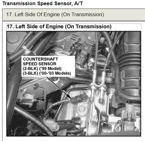

These cars had problem with the input shaft speed sensor for the transmission have you tried one yet?
Here is the shaft speed sensor location.
Apr 5, 2018 at 7:28 AM
