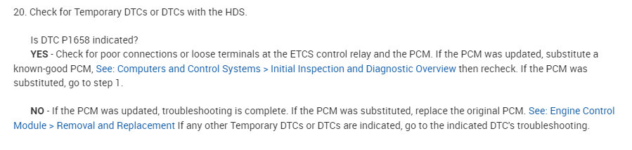

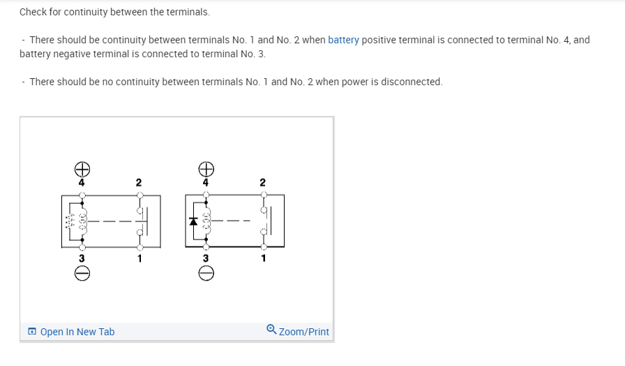

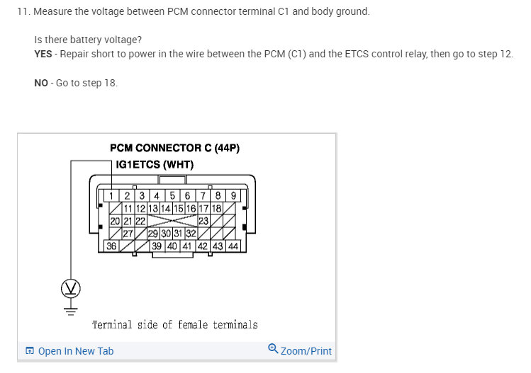

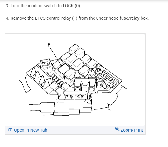

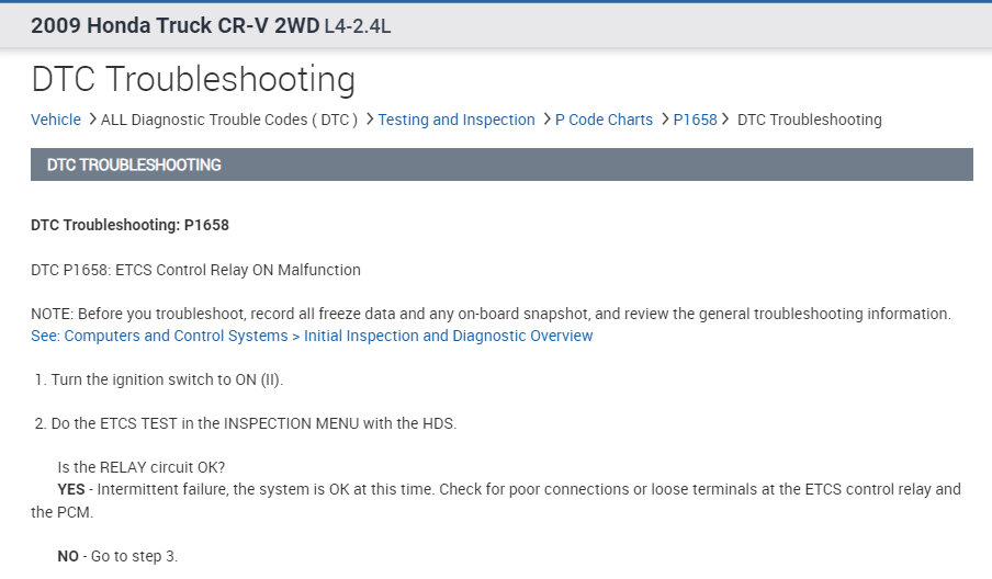

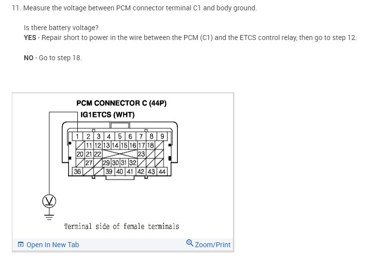

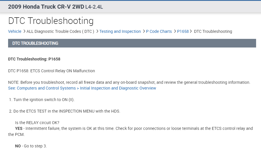

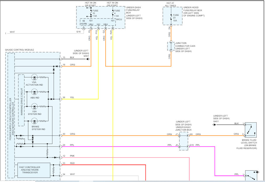

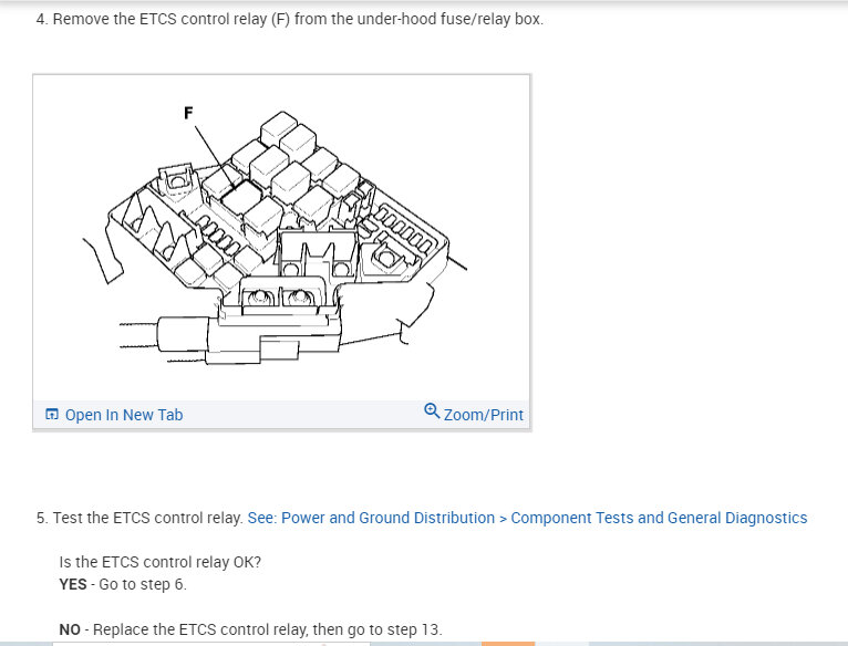

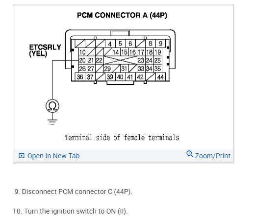

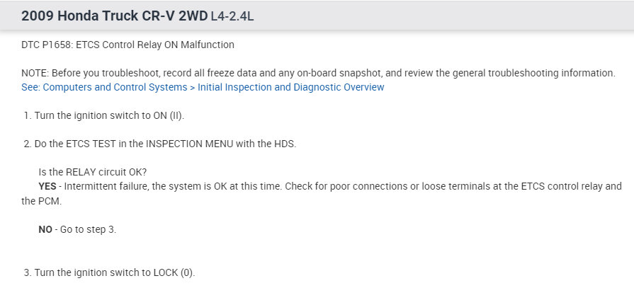

As far as the code is concerned, it is related to the components you mentioned. I have the diagnostics, but they are extensive. However, I would like to at least check the relay itself and its circuit. Pic 3 explains what to check.
Also, here is a link you may find more informative:
If you look at the pics below, it explains how to test it. Do this and let me know the results. If you find it is good, I will provide the additional diagnostics, but they do require a scan tool that can communicate with the vehicle and some extensive wire testing.

Hi, my husband is an electrician and switched the etcs relay with other ones and he said it is fine.

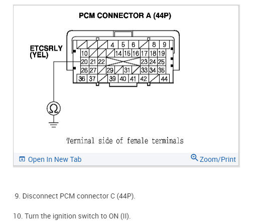

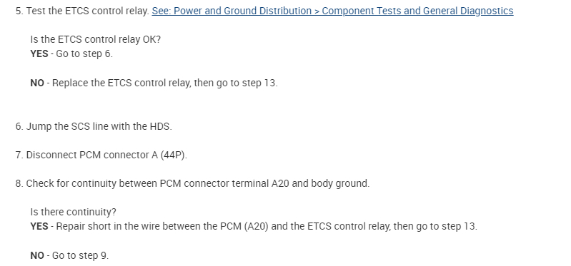

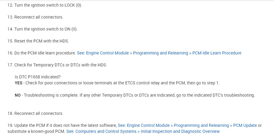

I attached the full list of the diagnostics below. Have your husband take a look at them and see if he feels comfortable performing. Chances are he will, but if either of you have questions, let me know.

  • 110,194 POSTS
Basically, you are checking things like continuity and voltages at specific wiring pins at the connectors and at the PCM connector.
Jun 25, 2023 at 8:42 PM

The tests I listed above are what I feel need to be done. The only other thing I can suggest is to try scanning the can-bus.

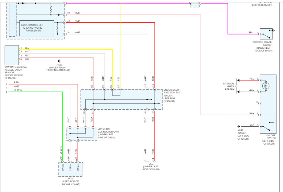

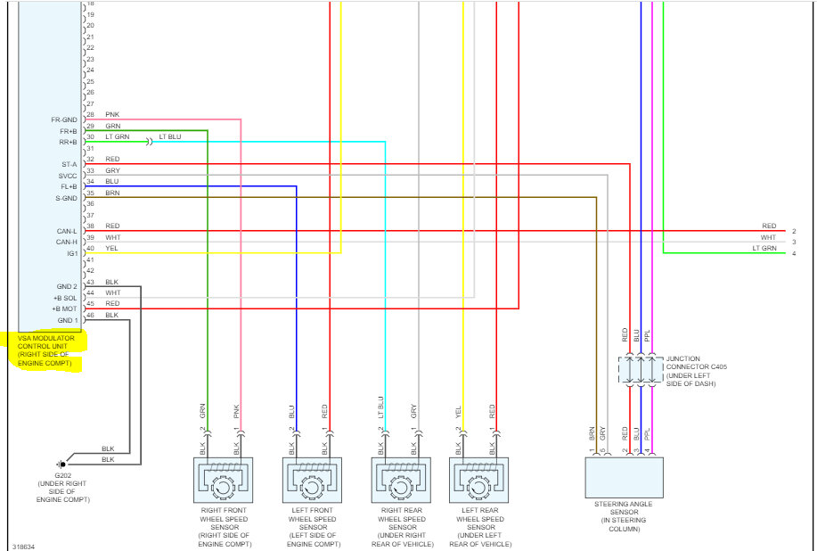

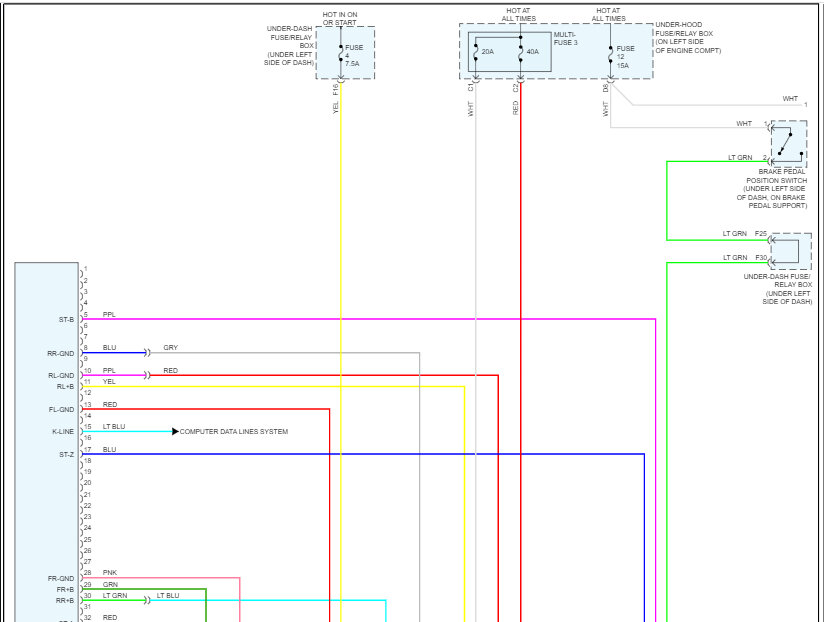

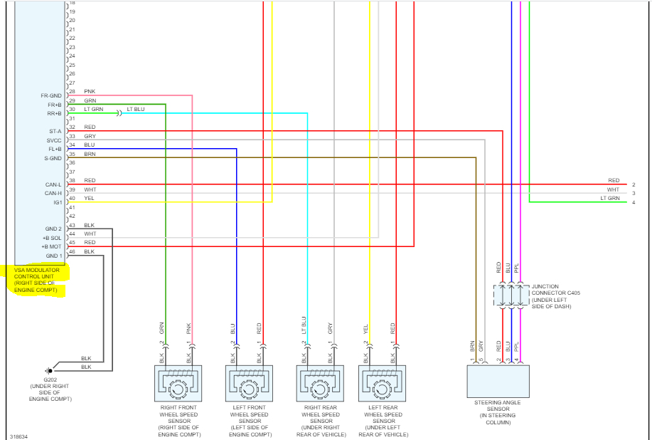

Do you have the wiring information for the ETCS?
Thank you for all the great information.
Jun 30, 2023 at 8:14 AM
  • 110,194 POSTS

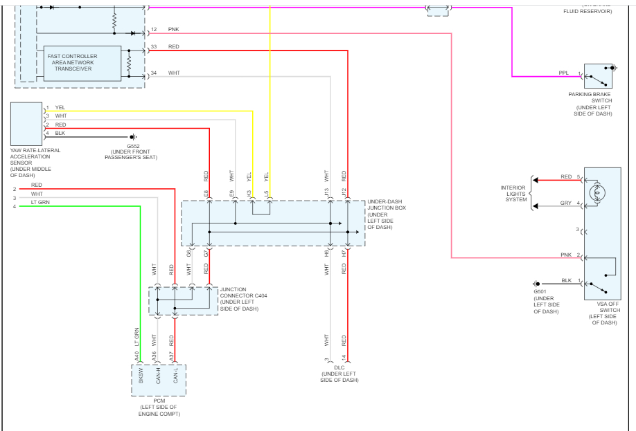

I attached the wiring schematics below for the traction control/ABS system. I had to cut each page in half to make them readable, but I did overlap the two so you can follow from one to the next.
I hope this helps.
