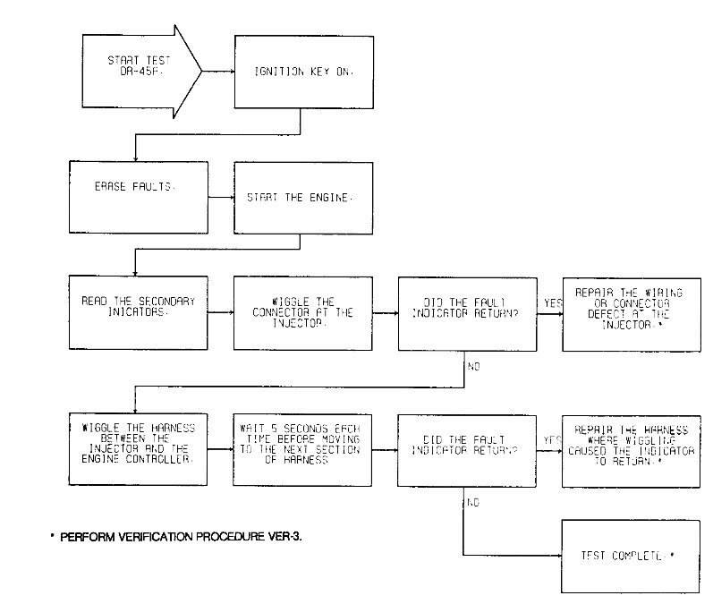

I had my timing belt snap on the highway . Had the belt replaced at an auto repair shop .i drove the car home and got a check engine light. 27 . I had my fuel pump replaced less then a week ago and i checked the connections and fuses.

see picture to do this test also check for a vacuum leak. this is an injector problem which may be the wiring or connectors.

Thanks, i am going to give it a try in the morning . But if it is not the harness or connector. Then is it most differently the injector?

it may be just a bad connection going to the injector. you can test injectors for ohms normally around 11-13 ohms per injector.

I went through the steps saw a small burn hole in the harness and reconnected a yellow black wire and the 27 error code is gone i get a 12 but . The car just will not start. So i was wondering if there was anything else i can check?
