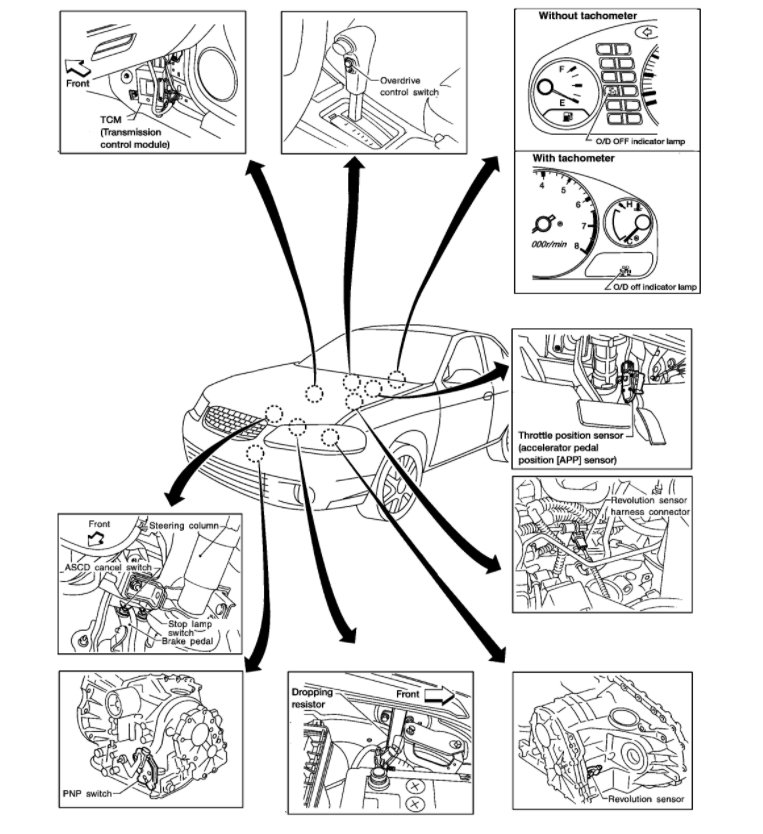

I’m getting a code of P2800 of transmission range sensor B circuit. Not sure what it means I got an error code of C0001 saying it’s the TCS control channel A valve 1 Subfault. I’m not sure what that means.

This means the transmission range sensor needs to be replaced. here are the instructions in the diagrams below on how to fix your car. They call is a "PNP" in the diagram. Check out the diagrams (below). Please let us know if you need anything else to get the problem fixed.
