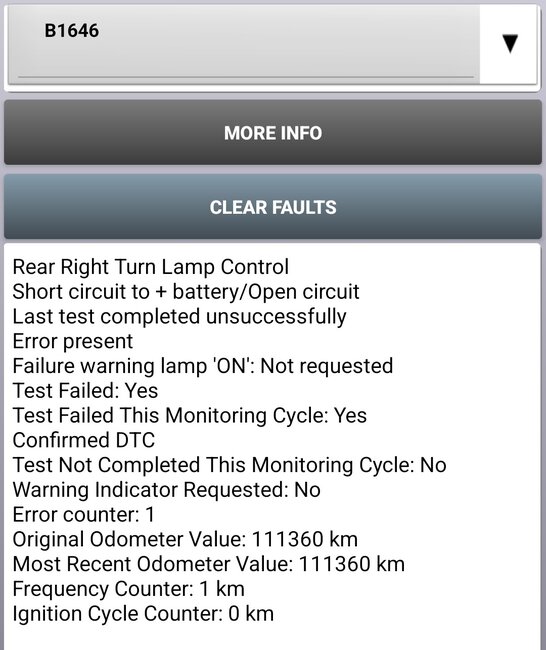

The OBD shows error code B1646 - turn light rear right short circuit +battery/disruption.

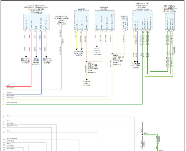

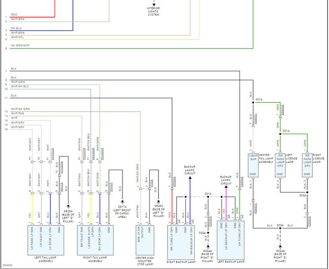

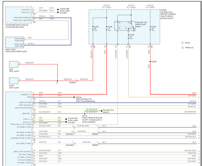

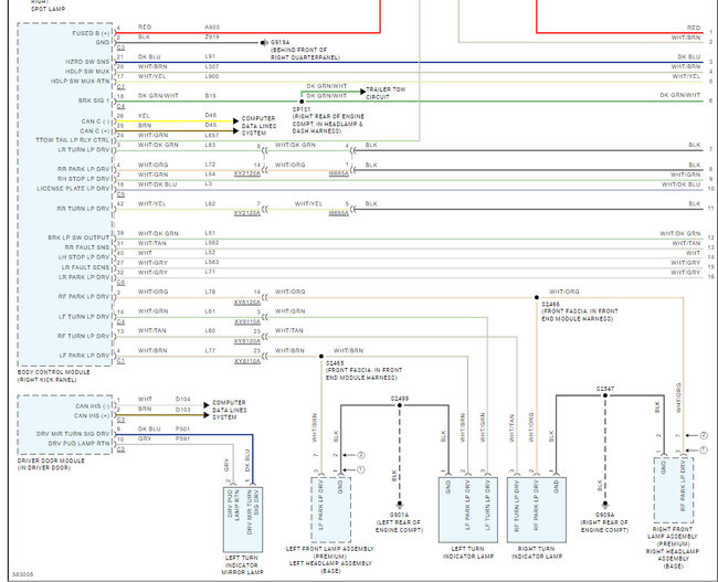

You say all of the lights work just the right side blinks fast, correct? Can I ask if the bulbs have been replaced with LED's? If so, this will be the problem because the amperage is so much less that regulator bulbs the computer thinks you have a bulb out. Here is the lighting wiring diagrams as it pertains to the BCM, this system is pretty straight forward. Check out the images (below). Please upload pictures or videos in your response of any problems so we can see what to help you with.

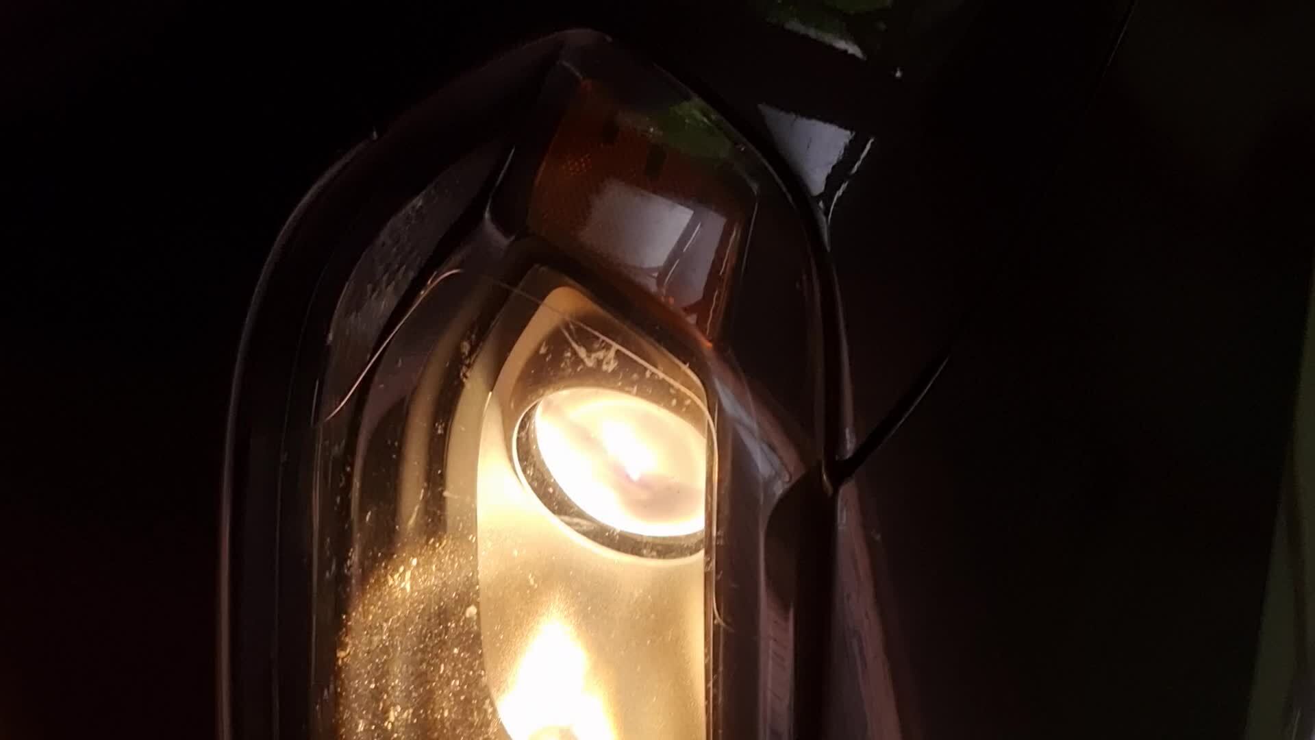

I am attaching a video and a screenshot of the error message.

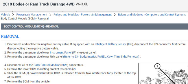

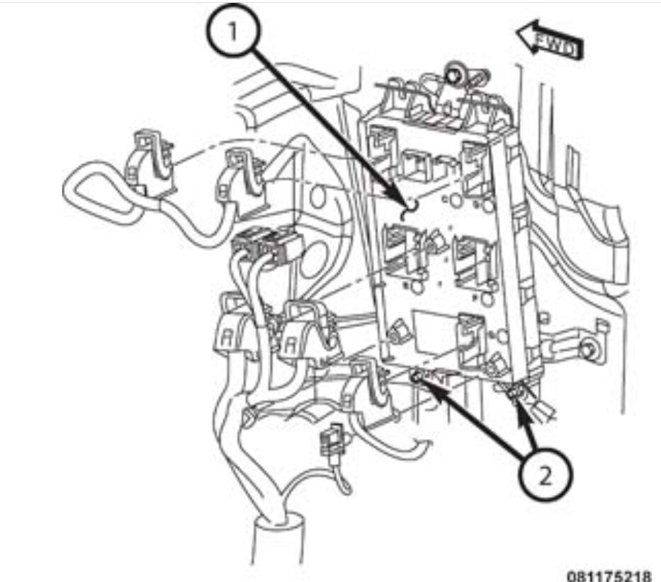

thanks for the video, it helps. I would say the BCM is having a problem. I was going to say it might be a bad connection, but the light works normally in the hazard mode which is controlled by the BCM. You can get a preprogrammed unit by searching Google or Ebay. Here is how to change it out and send it in for testing. Also, the BCM may just need to be reprogrammed. Check out the images (below). Please let us know what happens.
