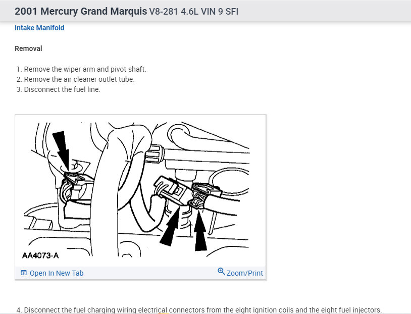

This all started after I put in the progressive insurance snapshot thing that goes on the OBD2 scan plug. Within 2-4 days my car started this temperature spike all the way to max then within 3-5 seconds it was back to normal. But while it spiked the car seemed to lose power not cut off but power to accelerate almost like a misfire type. I’ve taken it to 2 shops. The first tried to tell me I had all these problems and needed a new radiator, a new fan shroud relay, but I didn’t believe them. The next shop said the radiator was fine. It was electrical so they replaced the thermostat and coolant temperature sensor but still didn’t fix it. After 2 weeks they officially gave up and didn’t charge me for the cost of the 2 parts. I’ve researched it could be the cylinder head temperature sensor. Which I plan to change. But I’m hoping someone on here has seen this before. Oh, the car isn’t actually overheating the temperature isn’t fluctuating it’s just the gauge for that 3-5 seconds. Thank you

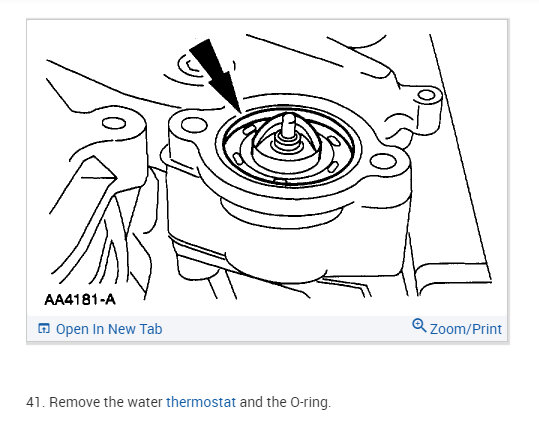

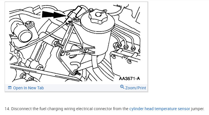

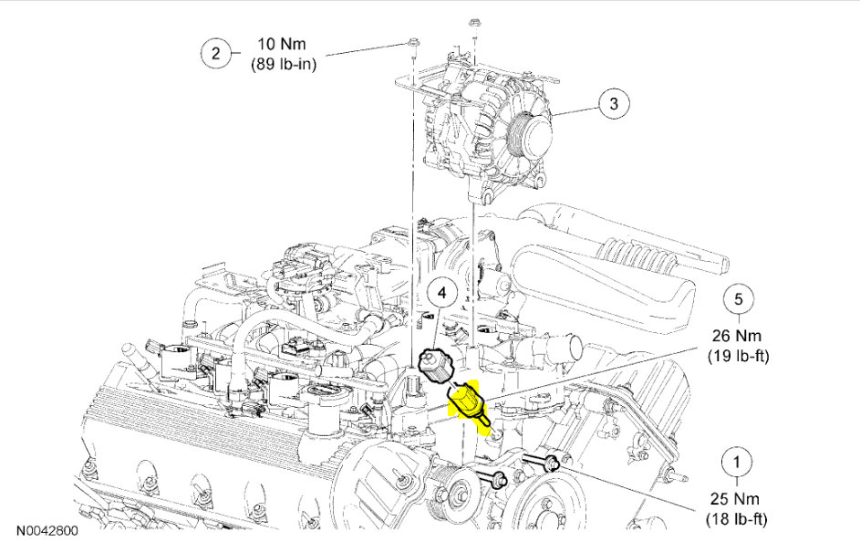

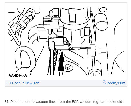

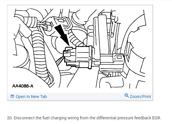

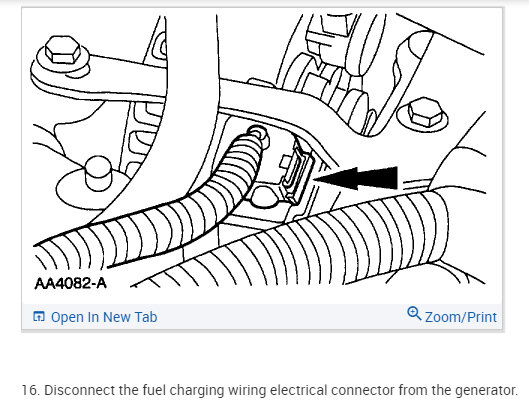

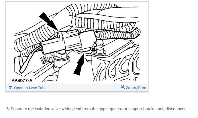

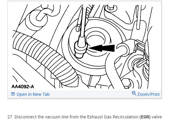

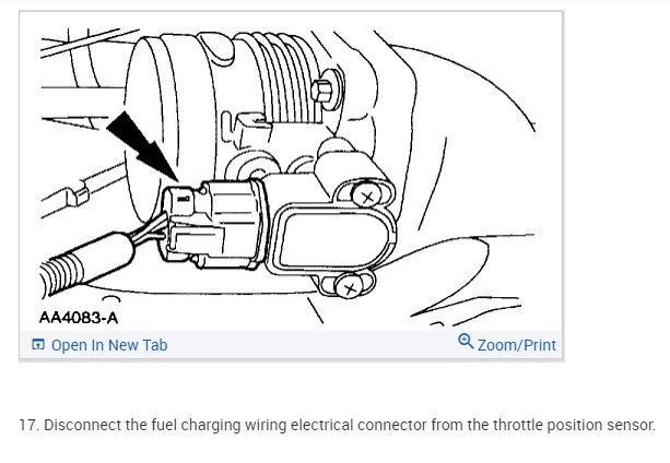

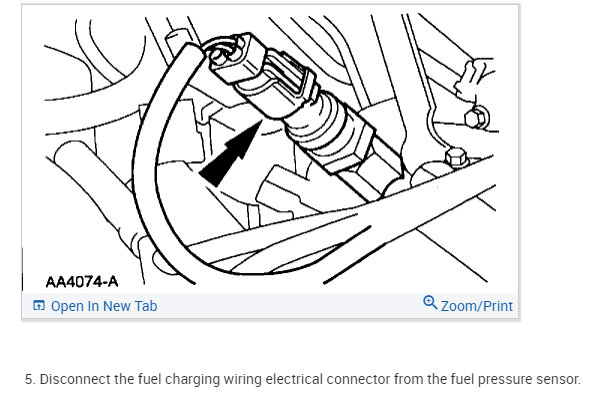

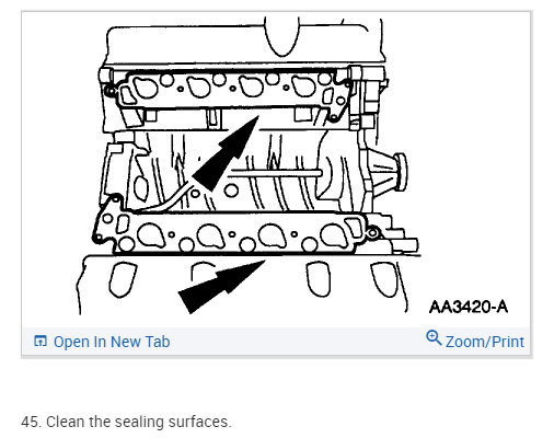

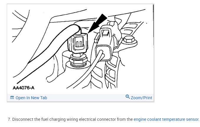

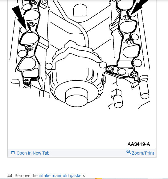

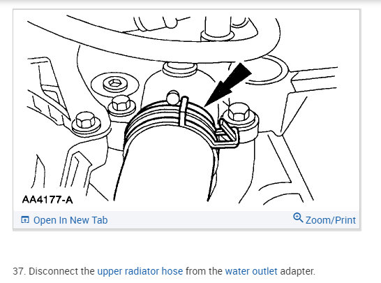

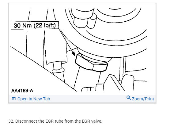

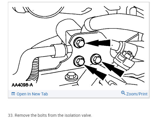

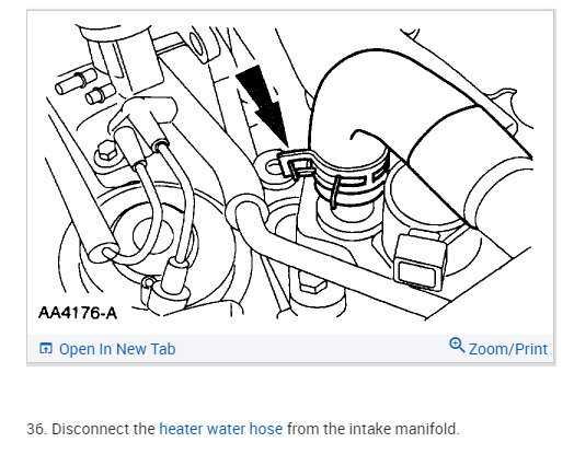

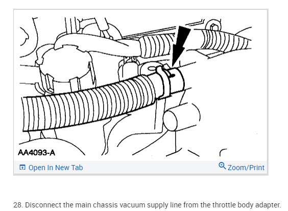

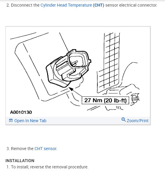

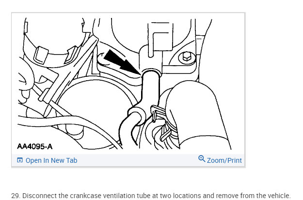

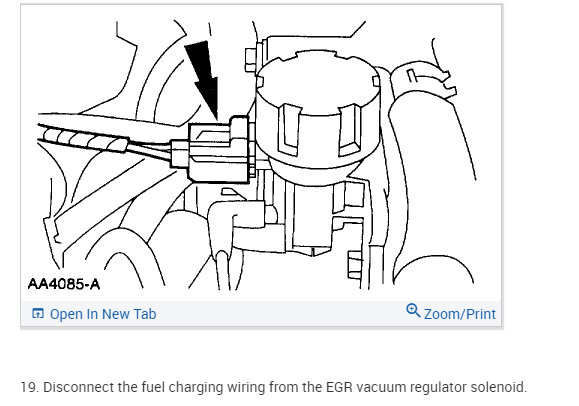

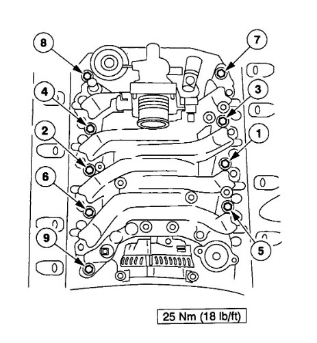

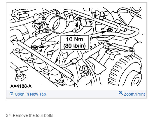

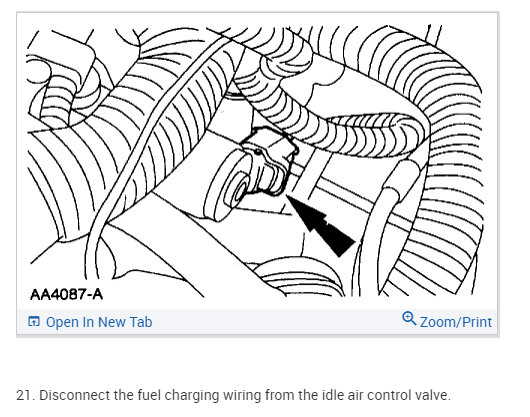

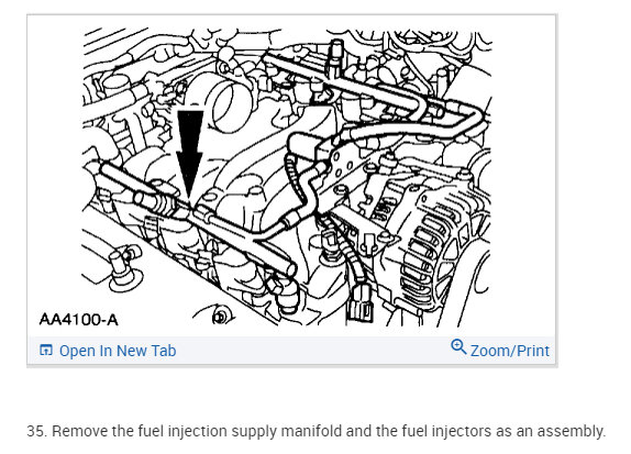

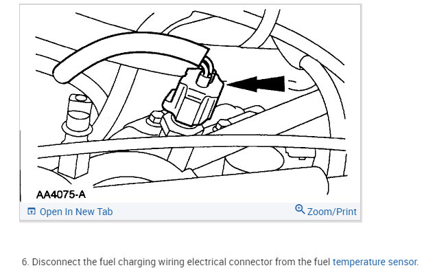

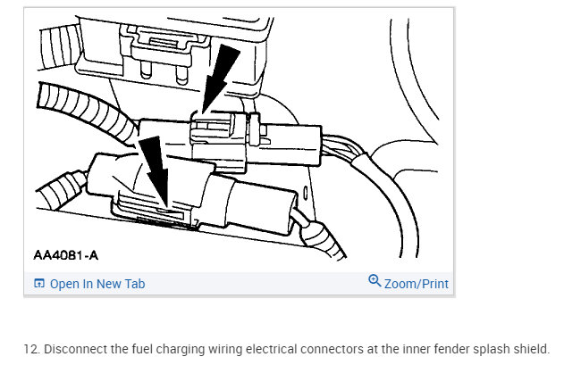

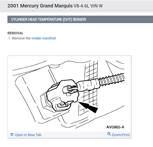

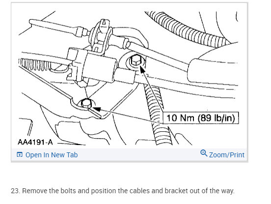

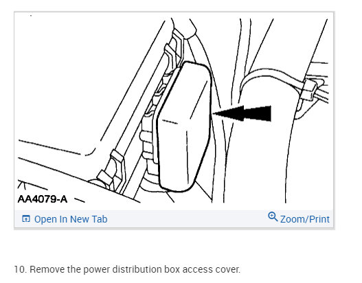

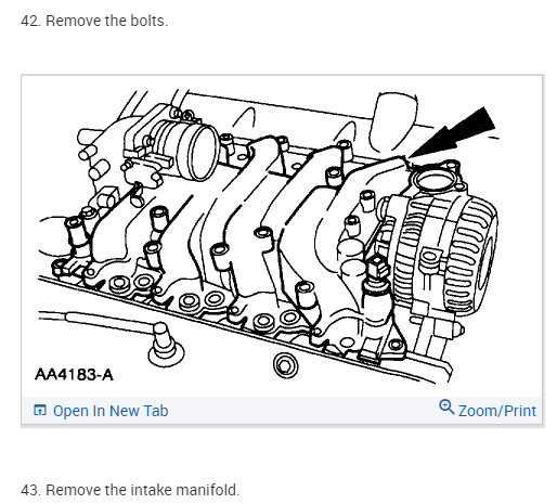

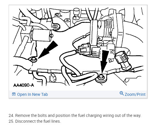

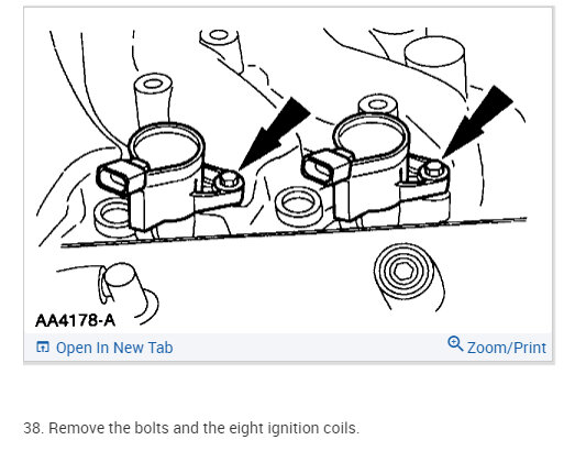

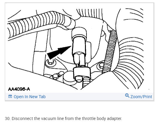

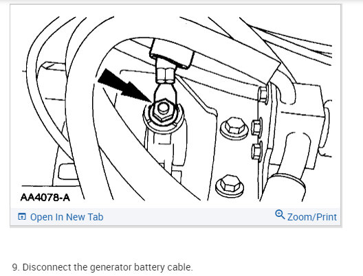

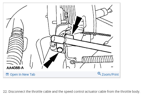

The cylinder head temperature sensor is easy to replace but hard to get to. It requires the removal of the intake manifold. See pics below.
If you want to replace it, let me know. There are a lot of directions for removing the intake manifold.

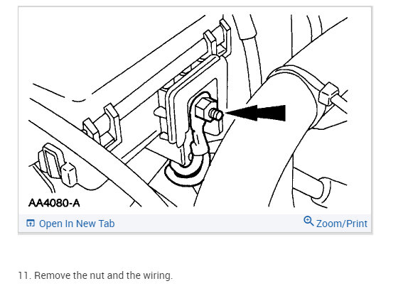

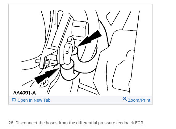

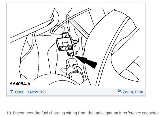

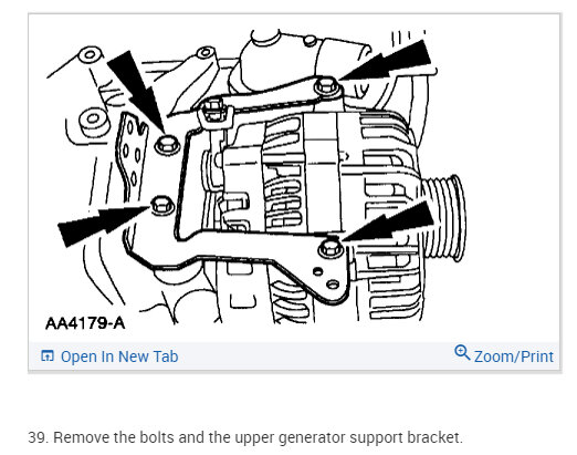

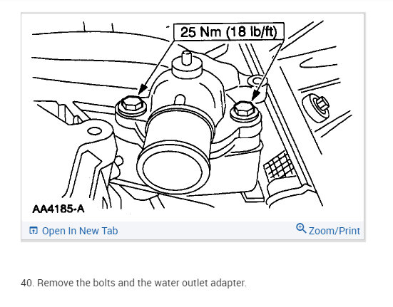

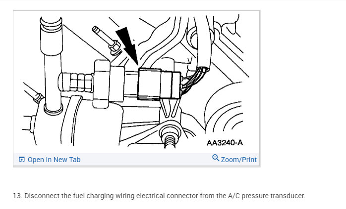

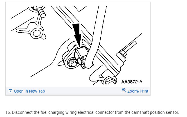

There are several different possibilities. It could be something as a simple loose connection or damaged wire. However, to inspect the wiring and connector, the intake needs to be removed. They make nothing easy. LOL
I would get the part first. Then, remove the intake and inspect the connector, and wiring, and make sure the connector is tight and free of corrosion. If everything appears to be in good condition, then replace the sensor.
I attached the directions below for the removal of the intake manifold. They are extensive. However, a lot of the directions indicate to remove connectors.
Let me know if this helps.
