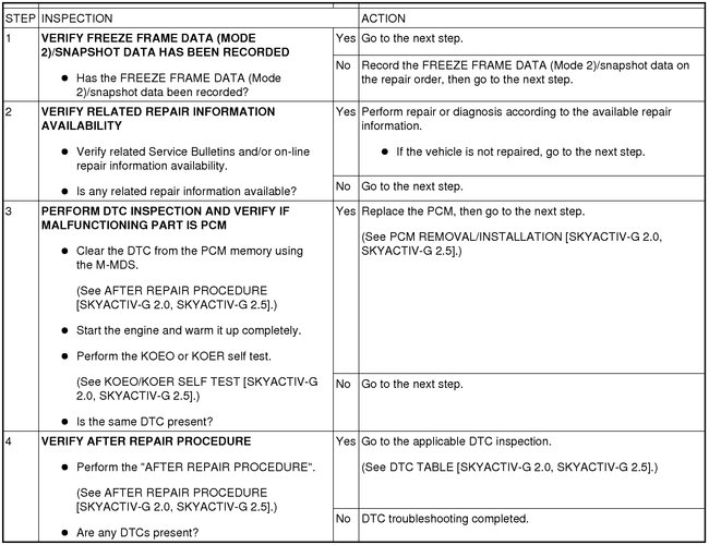

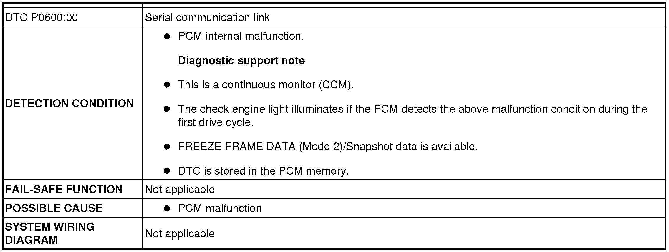

Car was driving fine and suddenly started shaking and misfiring. It showed cylinder misfires. I’ve replaced all 4 coils and plugs, the high pressure fuel line. Now it occasionally has that code and P0600 communication code in it. I’m wondering if it’s the PCM?

It does sound like an issue with the powertrain control module (PCM). The code indicates an internal malfunction.
Take a look at the two pics below. The first one explains the code and the second provides the diagnostics for this code. If possible, perform the diagnostics and let me know what you find.

Diagnostic Procedure
pic 2
